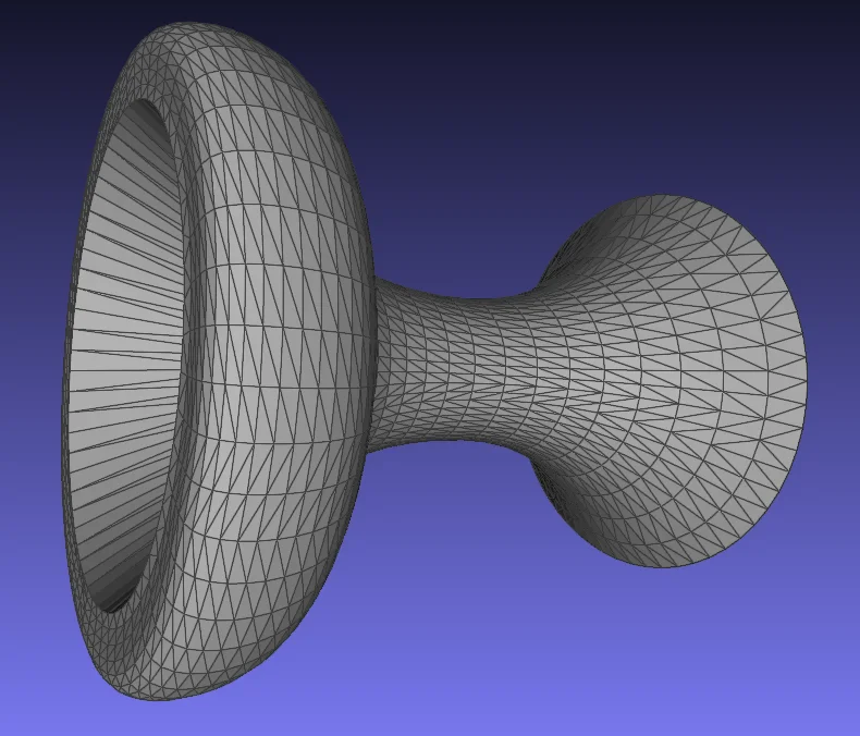

A 3D model of an organic shape against a purple background
CAD file for 3D printed part. Injection molding can’t produce curved surfaces.

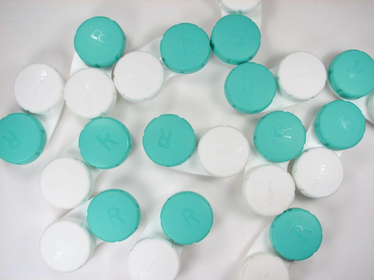

contact cases, made of plastic using injection molding
Injection molding is ideal for high-volumes of standard parts like these contact lens cases.

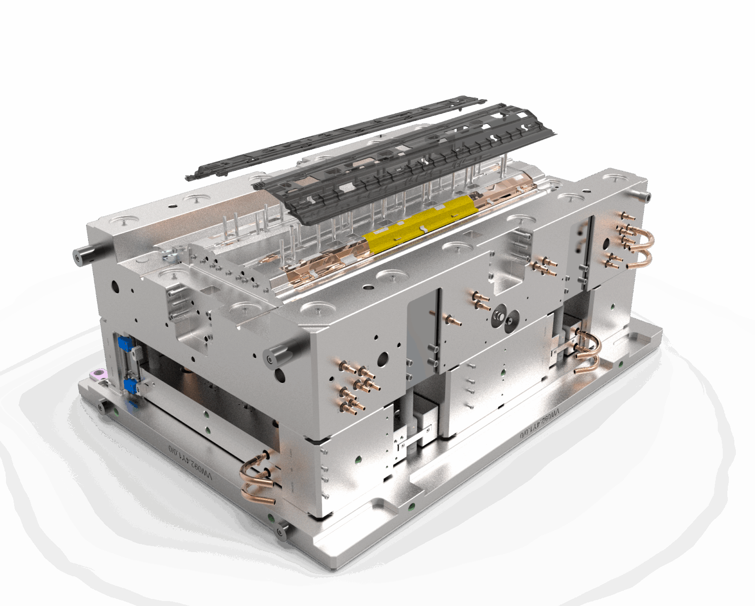

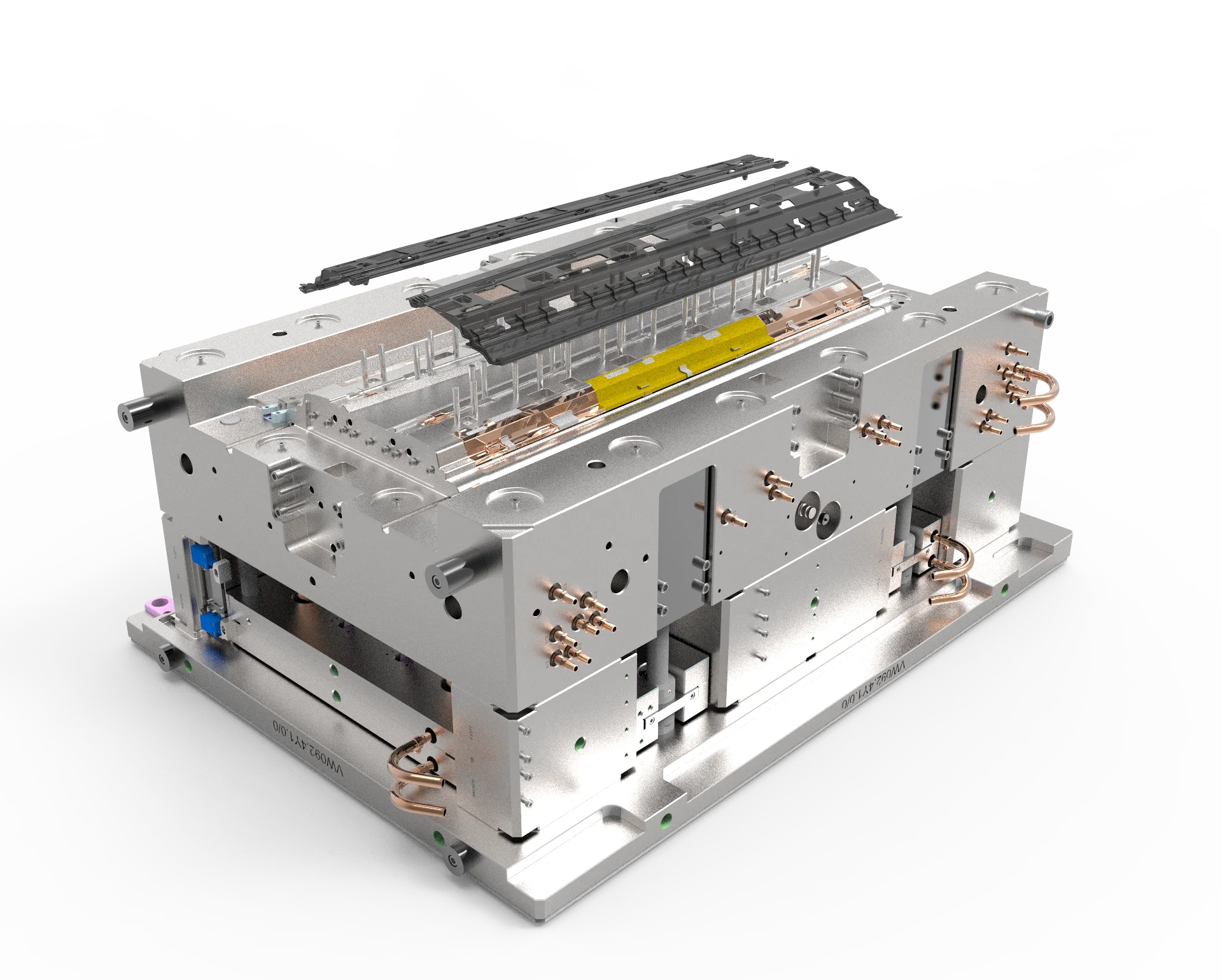

image of a mold used for injection molding
A mold like this can take months to make and cost thousands of dollars.
