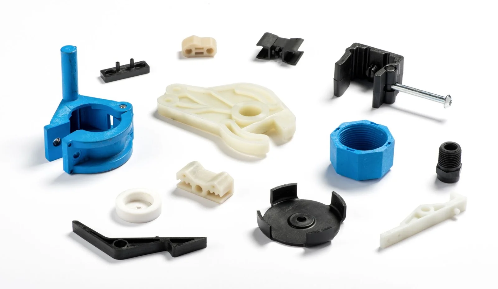

What are some common materials for a plastic prototype?
Collectively, the four plastic prototyping methods support a wide range of plastic resin materials. As the table below shows, however, there are differences in what each method supports. Some plastic prototyping processes don’t support some materials, while others support a much wider range of plastic resins, including glass-filled compounds.

If you need a prototype that uses the same material as the end-use product, review the chart above with care. For example, both CNC machining and injection molding support ABS; however, 3D printing and urethane casting support an ABS-like material instead. This ABS-like material is not identical to ABS in terms of end-use properties and, consequently, might not meet your testing requirements.
