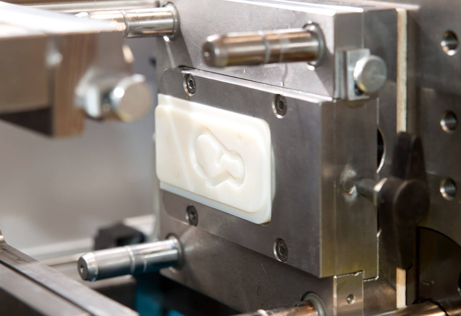

What Is the Difference Between Rapid Injection Molding and Traditional Injection Molding?
The major difference between rapid and traditional injection molding is tooling, which affects speed and cost. Conventional injection molds can take eight weeks or longer to machine, whereas rapid injection molds—also called “prototype,” “soft,” or “quick” tools—are produced in a fraction of that time.
This makes design iterations much quicker than conventional molding, allowing manufacturers to achieve quicker customer sampling. This speed increase is possible because “rapid” molds are produced from softer materials that are easier to machine, such as aluminum or pre-hardened steels like P20. These tools still handle standard thermoplastics, so you get production-quality parts, just much faster.
However, there are some trade-offs to consider. Rapid injection molds typically may not achieve the same tight tolerances as molds made from hardened steel. Also, the production lifespan for rapid injection molds is shorter than that of conventional injection molds. Standard molds, being made from more durable materials, can handle more production cycles and wear and tear. They are therefore more suitable for high-volume production. Rapid injection molds, on the other hand, are better suited for prototyping or low- to medium-volume production.

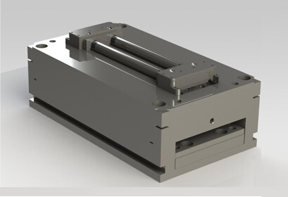

Technologies Used to Manufacture Rapid Injection Molds
There are currently three main technologies used to manufacture rapid injection molds:
CNC-Machined Molds
This is currently the go-to technology for rapid injection molds. Molds can be made from a variety of materials, including plastics and metals. CNC-machined molds can handle more cycles than 3D-printed molds because they are more durable.
3D-Printed Molds
3D-printed molds are fairly new to the injection molding industry, compared to more established technologies like CNC machining; however, they bring their own set of advantages to the table. 3D-printed molds offer increased design flexibility, especially for internal geometries where CNC machining is very limited.
3D-printed molds are also very quick and easy to design and print, and allow for speedy design iterations, which can be a major pro for companies still refining their designs. On the downside, 3D-printed molds do not have the same longevity as molds made from pure metal; however, they are excellent for custom designs with complex inner geometries.
Electrical Discharge Machining (EDM)
EDM is a specialized method used to shape hard materials or to create extremely fine details in mold cavities. It erodes material using controlled electrical discharges between an electrode and the mold block. EDM is especially useful for deep, narrow slots, sharp internal corners, or intricate surface textures that are difficult (or impossible) to achieve with traditional cutting tools. It’s often used alongside CNC machining to finish complex molds or add final precision features.

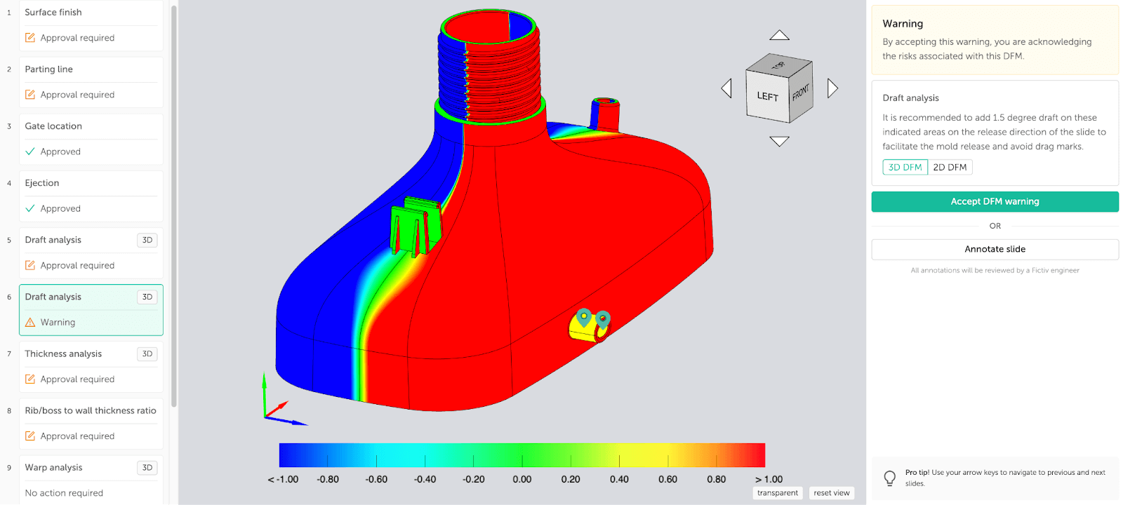

Add Draft Angles
Draft makes it easier to remove the part from the mold without damaging it or creating defects such as scratch marks and deformation.

Fictiv’s Injection Molding Design Guide examines each of these considerations in detail. While these factors apply to both traditional and rapid injection molding, the rapid process introduces unique challenges—particularly in material selection and part tolerances.
Fictiv provides DFM feedback along with your quote so that you get your parts made faster.

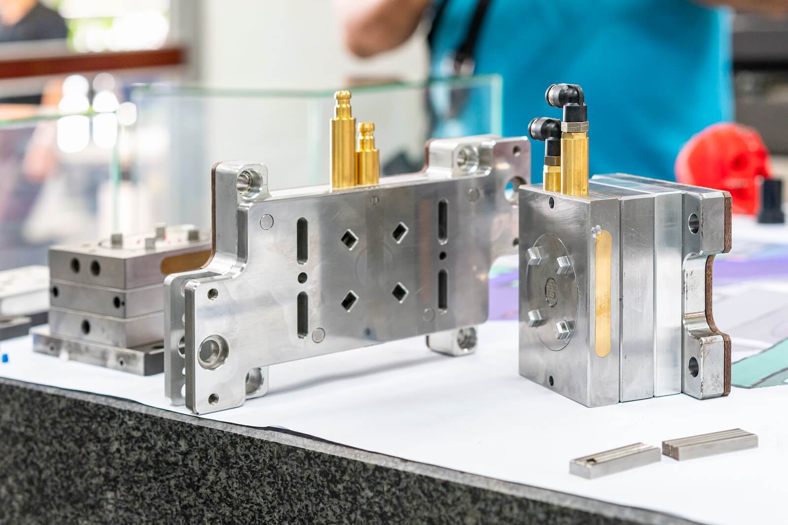

Tooling Materials for Rapid Injection Molding
Rapid injection molding utilizes a variety of tooling materials to provide quick and cost-effective production for prototypes and low- to medium-volume runs. The choice of tooling material is essential to balancing production speed, part quality, and budget.
Here’s a breakdown of the most commonly used materials for tooling:
Aluminum Molds
Aluminum is one of the most widely used materials for rapid injection molds due to its fast machining times and excellent heat transfer properties. Aluminum can be machined up to twice as fast as steel, and it doesn’t require post-machining heat treatment, which significantly shortens tooling times. Additionally, aluminum supports faster cycle times because of its superior heat dissipation.
However, aluminum molds have their limitations. They tend to wear out more quickly and are not ideal for parts requiring high clamping pressures or for plastics that require high processing temperatures, like PEI or PEEK. While aluminum molds can handle up to 10,000 shots, they’re better suited for lower-volume runs. The material also doesn’t polish as well as steel, so glossy or optically clear parts may not achieve the desired finish.
Soft and Semi-Hardened Steel Molds
Soft and semi-hardened steels, such as P20 and NAK80, are often preferred for parts requiring tighter tolerances or higher durability. Softer steels like P20 can be welded to support engineering change orders (ECOs), which are common during prototyping or early production stages. P20 tooling has lead times of about two weeks or less, making it faster than hardened steel but more durable than aluminum.
Semi-hardened steels like NAK80 are especially suited for producing glossy or optically clear parts as they offer a high level of finish quality. While they have a longer lead time than aluminum, they strike a useful balance between speed, cost, and performance.
Hardened Steel Mold Inserts
Though hardened steel is typically reserved for high-volume production, it can be used in rapid tooling applications in the form of inserts. These inserts are used in molds to enhance durability and support tight tolerances. They can be found in molds classified as SPI Class 104, which combine hardened steel inserts with bases made of less expensive materials like cast metal. While hardened steel inserts offer longer tool life and higher precision, they come with a higher cost and longer lead time compared to aluminum and soft steels.
Mantle3D metal inserts use paste deposition technology to add layers of metal paste that can then be machined and hardened in a high-temperature furnace. This creates 3D-printed inserts that surpass the performance and durability of traditional 3D printing. Mantle 3D printing is one emerging technology that Fictiv is actively leveraging.
