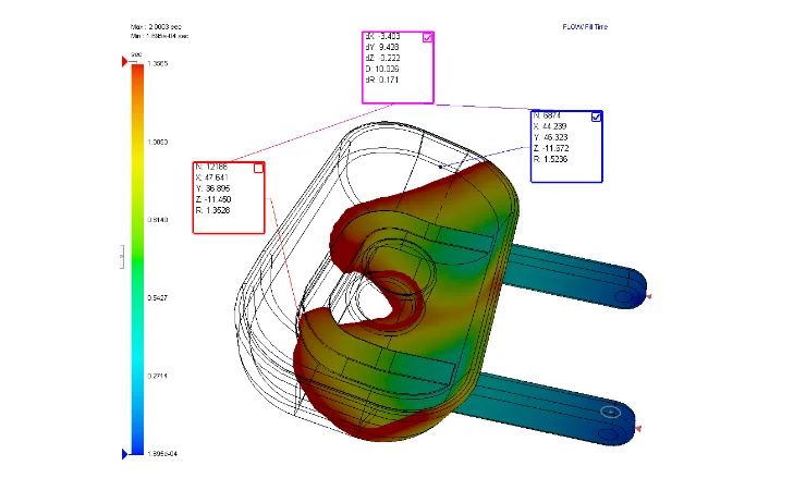

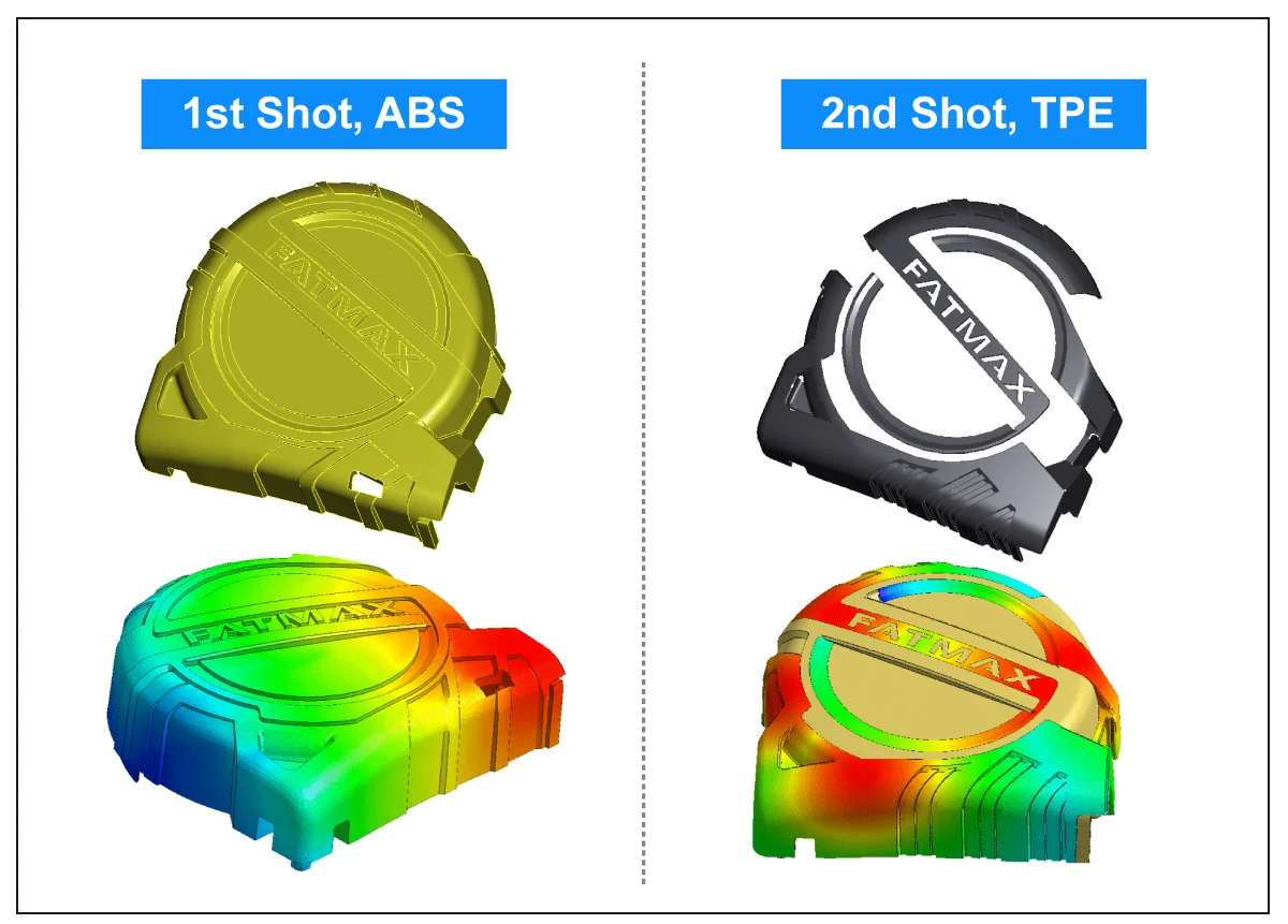

Two-shot molding, or double-shot molding, is a two-step continuous process that first molds a substrate, then overmolds that substrate with a different material. The entire process uses a single mold and is fully automated. In other words, an injection molding machine with multiple barrels shoots two different resins into the same mold. Because the tooling is more expensive, two-shot molding is generally used for high-volume production runs of 10,000 parts or more.
![two-shot molding](https://www.fictiv.com/wp-content/uploads/2022/12/Designing-An-Overmolded-Plastic-Part-with-Mold-Filling-Analysis-02.jpg)
Mold filling analysis was used to produce this two-shot molded part. Image Credit: Moldex3D
