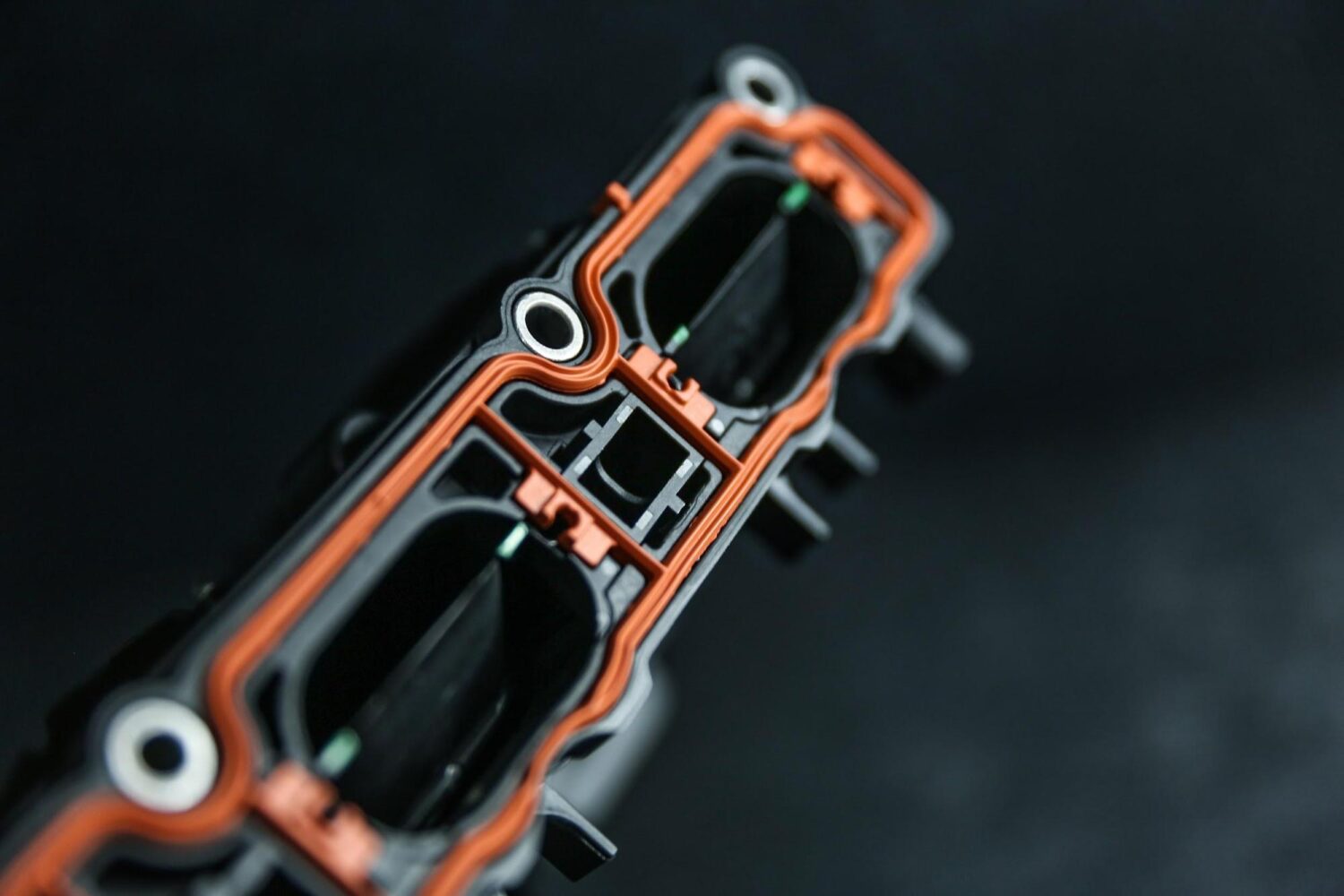

Two-shot injection molding, also known as dual injection, multi-shot, or 2K molding, is a highly specialized process that combines two different materials or colors into a single injection molded part. This advanced molding technique involves injecting two types of polymers into the same mold through separate injections but within the same molding cycle. The result is a complex part that can have varying colors, textures, or material properties, seamlessly integrated without the need for post-molding assembly.
The Process and How It Works
The process of two-shot injection molding is executed in a specialized molding machine that is equipped with two or more injection units. The core of the process lies in the precise control of the injection units and the mold design, which needs to accommodate multiple injections.
Here’s how it typically unfolds:
  1. First Shot: The first material is injected into the mold, where it forms the part’s substrate layer.
  2. Mold Rotation or Plate Shift: After the first injection, the mold either rotates or shifts to align the first part in a new cavity position for the second injection.
  3. Second Shot: The second material is injected, bonding chemically or mechanically to the first layer to form the final part.
