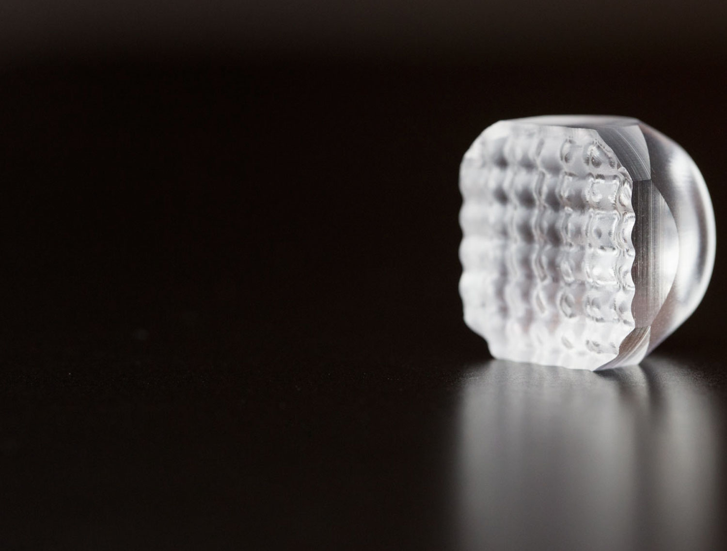

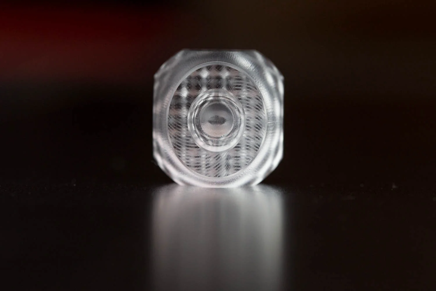

Acrylic
Overview
Acrylic, which is also known by trade names Plexiglass or Luctie, has a chemical composition known as PMMA (Poly Methyl MethAcrylate) plastic. It is tough, with decent impact strength and scratch resistance, and can be easily glued using acrylic cement.
Acrylic CNC Machining Processes
  • CNC Mill
  • CNC Lathe
Benefits
It is well suited for any applications that require optical transparency or translucence, or as a less durable but cheaper alternative to polycarbonate. Its scratch resistance also makes it optimal for areas with slight abrasive environments.
Drawbacks
However, acrylic is a brittle plastic and has a tendency to crack or shatter, rather than stretching as a ductile material would. Attention should be paid to the wall thickness in acrylic components as thinner walls are more brittle.
Any machined surfaces on a piece of acrylic will lose their transparency and take on a frosted, translucent appearance. Because of this, it is usually a good idea to note if an acrylic part should be left at stock thickness to preserve transparency or not. If transparency is needed on a machined surface, it can be polished as an additional post processing step.
Common Applications
As-machined, acrylic is transparent and is most commonly used as a lightweight substitute for glass or for light pipes. Other common uses include automobile light components, light tubes, tanks, panels and components for optical engineering.
Learn more in the Capabilities Guide

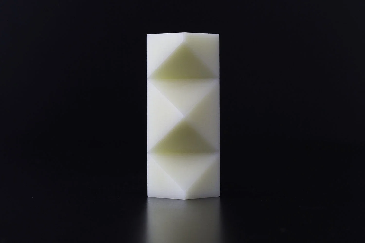

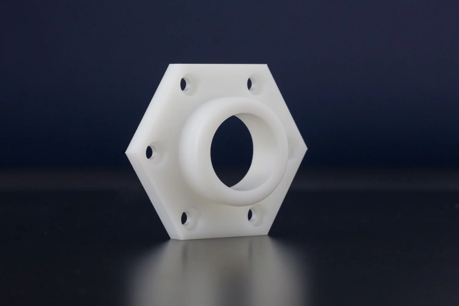

Delrin/POM CNC Machining
Overview
Delrin is a trademarked name for class of semi-crystalline thermoplastic acetal resin aka the abbreviation POM which stands for polyoxymethylene. It has a slippery, low friction surface, excellent dimensional stability, and high stiffness. There are many classifications of this acetal resin, including:
  1. Standard
  2. Toughened
  3. Low friction
  4. Glass-filled/reinforced
  5. UV-stabilized
Fictiv’s material selection for plastic CNC machined components also includes Delrin with glass fibers and Delrin AF. Delrin with added glass fibers is also excellent for superior stiffness and dimensional stability along with a high creep resistance. Delrin AF, another variation, with increased coefficient of friction, providing a self-lubrication, has excellent wear resistance, toughness, and strength.
Delrin/POM CNC Machining Processes
  • CNC Mill
  • CNC Lathe
Delrin / POM CNC Machining Processes
Benefits
Delrin/POM is a good plastic for these or any other applications that will experience lots of friction, require tight tolerances, or need a high stiffness material. It has been used in commercial markets for decades due to its reliability and durability. It also has excellent impact, chemical, moisture and fatigue resistance. It is also easy to CNC machine Delrin/POM.
Because of its high stiffness and rigidity, Delrin is an excellent choice for CNC plastic machining parts that require dimensional accuracy and tight tolerances.
Drawbacks
The downside to Delrin’s slippery, wear resistant surface is that it’s very hard to glue. The material also has internal stresses that make it prone to warping in areas that are thin or have large amounts of asymmetric material removal. In addition, heating Delrin/POM in excess of the maximum capability can result in dangerous off gassing.
Common Applications
Delrin is commonly used in gears, bearings, bushings, and fasteners, or to make jigs and fixtures for assembly, or even automotive, construction, and electronics components.
