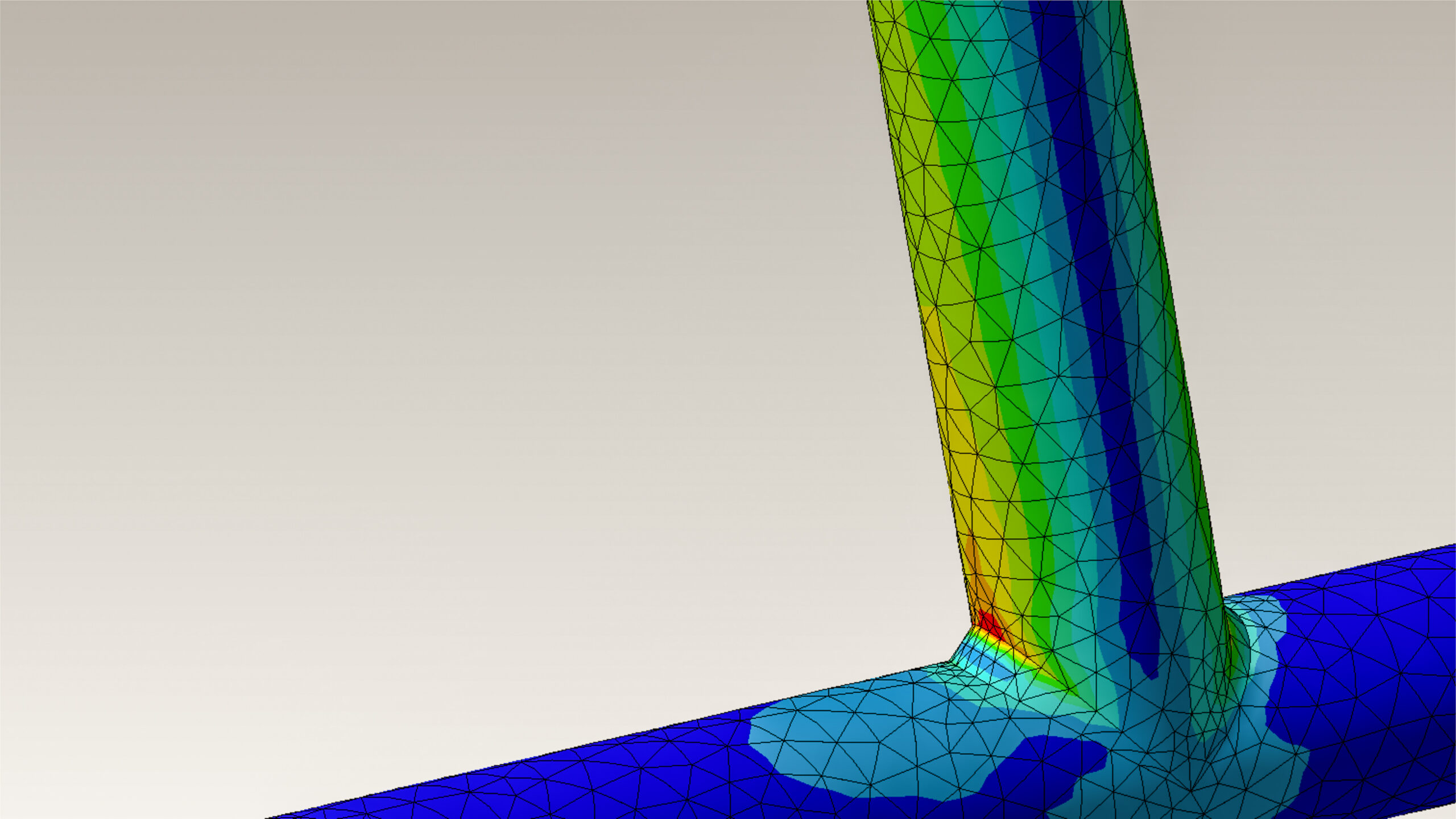

Physical AI FEA simulation
FEA Simulation

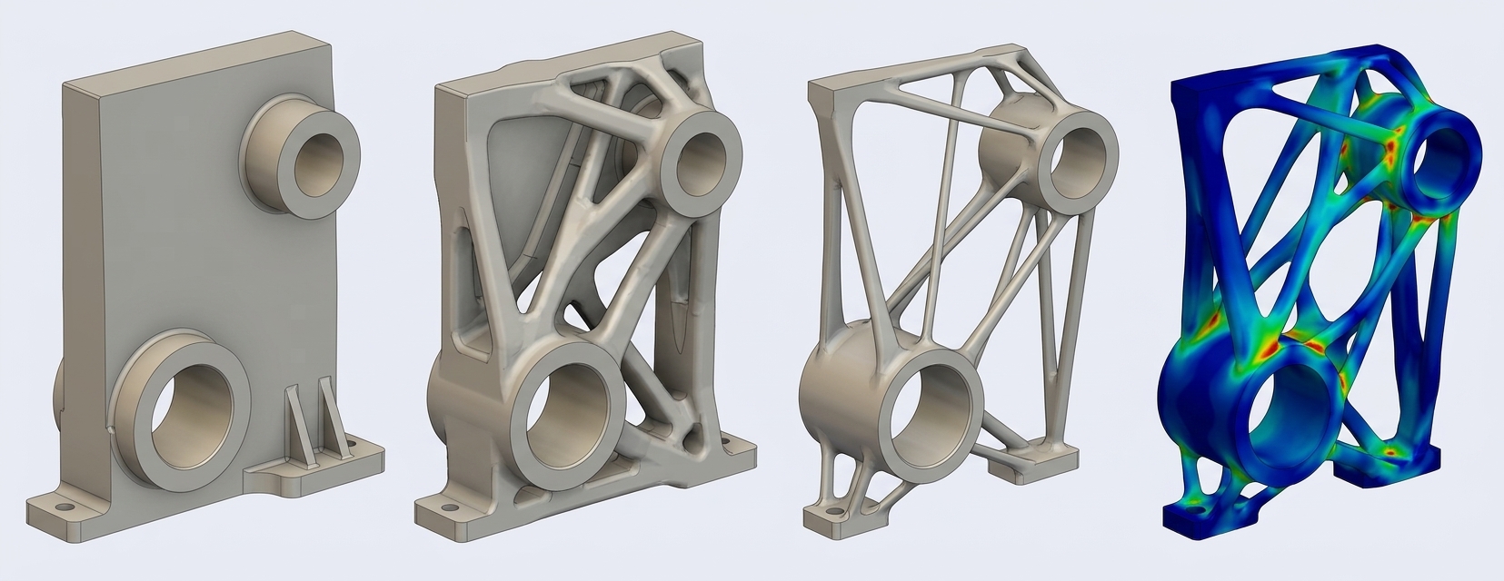

AI-generated topology and FEA
Example of AI topology and FEA
