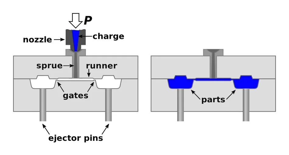

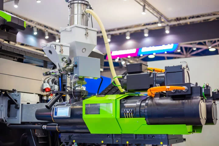

Plastic injection molding begins when plastic pellets or granules are poured into a hopper, then dispensed into a barrel where the material is heated and melted into a liquid. A large reciprocating screw then pushes this molten material toward the tip of the barrel while raising the plastic’s pressure and temperature. When enough material and pressure build-up, a ram pushes the screw toward the mold. This forces a “shot” of plastic out of the barrel via a nozzle and sprue and into a system of runners (channels cut into the mold).
From the runners, the molten material passes through one or more gates, which are openings in the mold cavity whose location, size, and shape have a significant effect on the final part. Injection molds can feature one cavity or multiple cavities, each of which can be used to create a single part. A clamping unit keeps the mold closed during injection and subsequent cooling. When the part is ready, the mold is opened and the part is extracted, sometimes with mechanical devices such as sliders and lifters. If injection molded parts require finishing, post-processing techniques such as gate trimming and heat staking can be used.

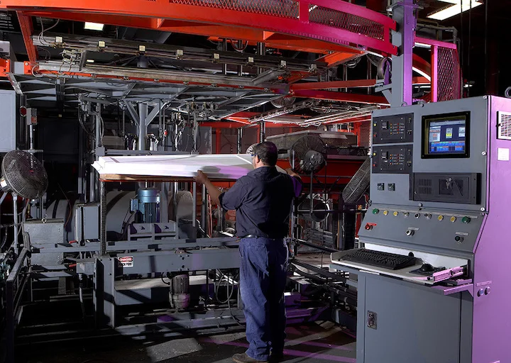

With vacuum forming, a plastic sheet is clamped in place and heated until it becomes soft and pliable. This sheet is then stretched across a mold with the shape of the part. The mold is then covered and the air is evacuated between the heated sheet and the mold to create a vacuum. This low-pressure condition causes the plastic sheet to sag, pull against the mold, and form the part’s final shape. After the part cools, it’s removed from the mold and excess plastic is trimmed, either by hand or with CNC or robotic equipment.
Because the plastic in the corners and at the top edges of the mold stretches the most, this material is also the thinnest. To promote a more uniform thickness, straight vacuum forming can be supplemented with billow forming and plug assists. With billow forming, a stream of air is applied to the softened sheet so that it’s blown into a bubble with roughly the same surface area as the plastic part. The air is then evacuated from beneath the mold to create a vacuum that pulls the sheet against the mold’s walls. A plug assist can be used to pre-stretch the heated sheet prior to the creation of vacuum pressure.

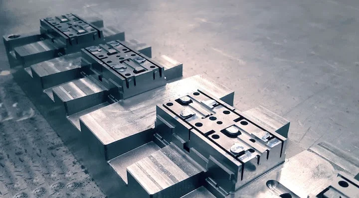

Compared to vacuum molds, injection molds cost more, but last longer. For smaller production runs, such as 250 to 300 parts per year, vacuum forming is especially cost-effective. Because they’re simpler, vacuum molds also take less time to produce. With the right manufacturing partner, however, injection molding can support not only high-volume production runs but prototyping and low-volume production. Typically, injection molds for high volumes are made from hardened steels. By contrast, low-volume molds are made of aluminum or soft or semi-hardened steel.
