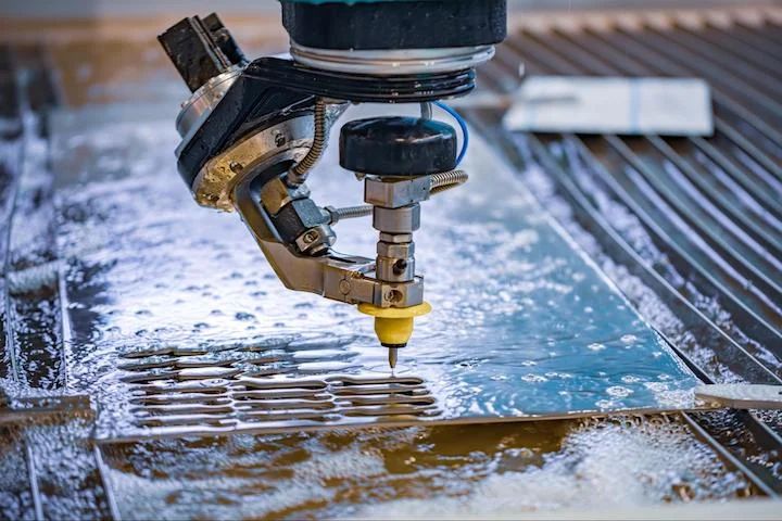

 waterjet cutting metal sheeting
Abrasive Waterjet Cutting
Abrasive waterjet cutting is a highly effective method for cutting sheet metal. The process involves using a high-pressure stream of water mixed with abrasive particles, typically garnet, to cut through the metal. The abrasive nature of the waterjet allows for precise and accurate cuts, even in thick metal sheets. This method is beneficial for cutting complex shapes and designs, as it can easily maneuver around corners, complex geometries, and tight spaces. In addition to sheet metal, abrasive waterjet cutting can cut a wide range of materials, including ceramics, composites, stone, and glass. Its versatility makes it popular in many industries, including aerospace, automotive, and manufacturing.
Advantages of Abrasive Waterjet Sheet Metal Cutting
  1. Material Versatility: Adding abrasive particles enables abrasive waterjet cutting to be compatible with a more extensive range of materials than pure waterjet cutting. This makes it useful for enterprises utilizing a wide variety of materials.
  2. Thickness Capability: Abrasive waterjet cutting easily cuts thicker materials. The abrasive particles successfully erode the material, allowing for precise sheet metal cutting up to a few inches thick.
  3. Precision and Accuracy: While pure waterjet cutting is exact, the expansion of abrasive particles further improves the accuracy by helping facilitate cleaner material removal, guaranteeing particularly precise cuts.
Disadvantages of Abrasive Waterjet Sheet Metal Cutting
  1. Abrasive Consumption and Cleanup: Abrasive particles are often a recycled consumable, requiring more cleanup and processing, contrasted with pure waterjet cutting. This can prompt extra labor and time.
  2. Equipment Wear and Maintenance: Abrasive particles can prompt higher wear on hardware parts, requiring more constant support and substitution. This might increase maintenance costs over the long run.

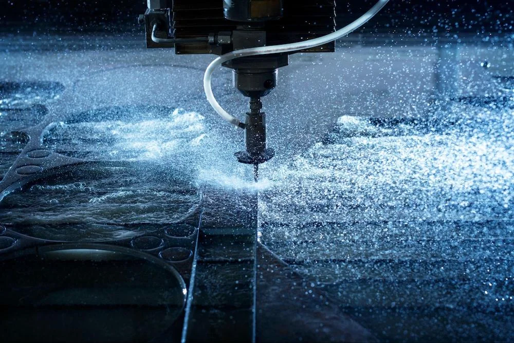

waterjet cutting of thin sheeting with supports
Pure Waterjet Cutting
Pure waterjet cutting is a type of waterjet cutting that uses a high-pressure stream of water to cut through materials. Unlike abrasive waterjet cutting, which uses water and abrasive particles to cut through harder materials, pure waterjet cutting is ideal for softer materials such as elastic, foam, plastics, and certain metals. The process involves pressurizing water to extremely high levels and directing it through a small nozzle to create a focused stream of water that can precisely cut through the material. Pure waterjet cutting is a versatile and efficient method widely used in various industries, including aerospace, automotive, and manufacturing.
Advantages of Pure Waterjet Sheet Metal Cutting
  1. Minimal Material Change: Pure waterjet cutting doesn’t utilize abrasive particles, resulting in less erosion of the cut material. This is especially vital for applications where surface roughness is a priority.
  2. No Abrasive Utilization: As the name suggests, pure waterjet cutting doesn’t need abrasive particles, lowering consumable expenses.
  3. Reduced Wear and Tear on Equipment: The shortfall of abrasive particles is that the gear encounters less wear and requires less regular maintenance. This enables improved hardware life expectancy and reduces maintenance costs.
Disadvantages of Pure Waterjet Sheet Metal Cutting
  1. Limited Material Compatibility: Pure waterjet cutting isn’t reasonable for cutting harder or thicker materials. This limitation can confine its utilization to specific business uses and applications.
  2. Slower Cutting Paces for Thick Materials: When cutting thicker materials,  pure waterjet cutting might be slower than abrasive waterjet cutting because the lack of abrasive particles means slower material removal. This can affect efficiency in applications that require quick cutting speeds.
