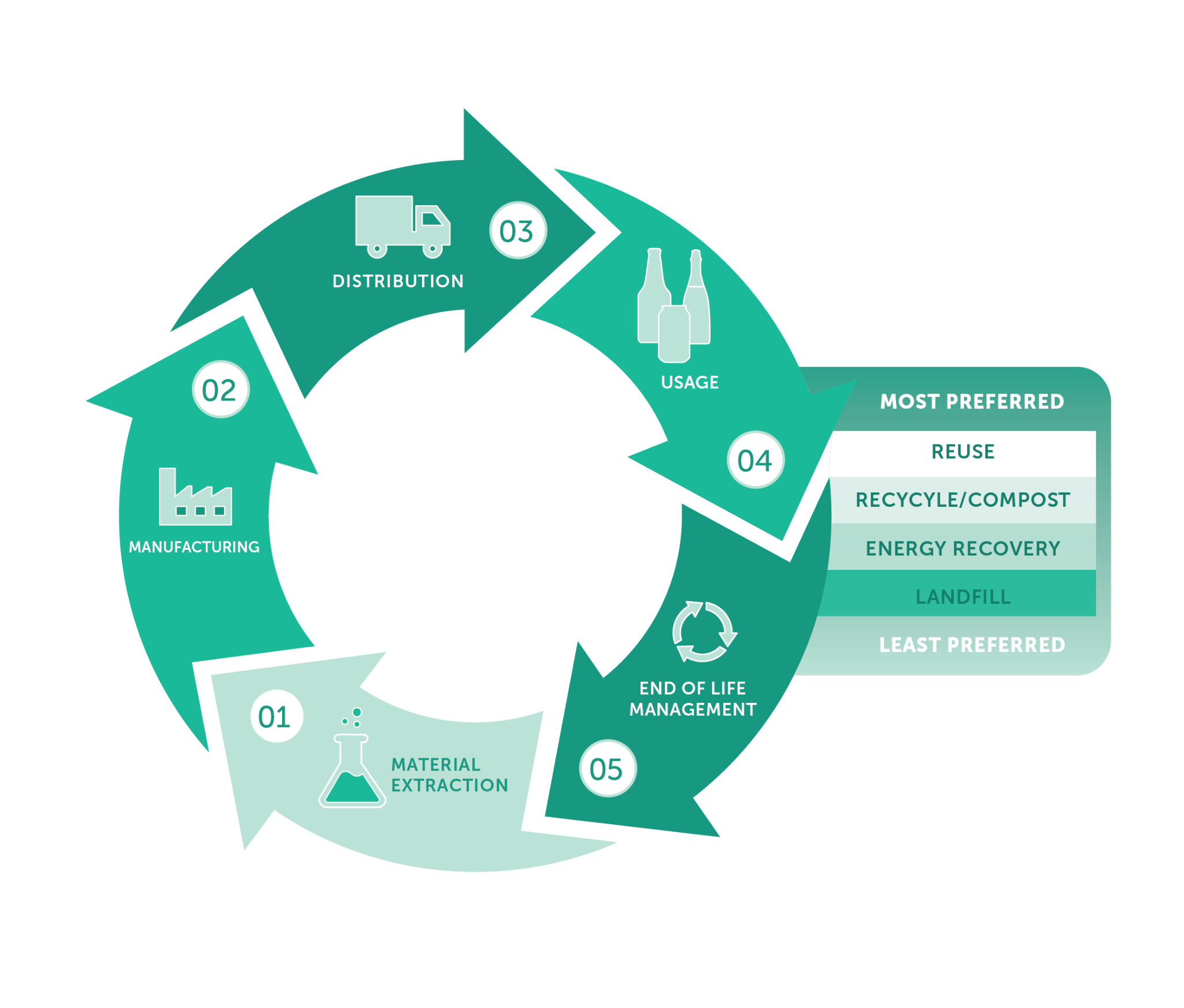

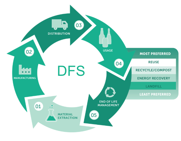

DFS product lifecycle
Sustainable product lifecycle

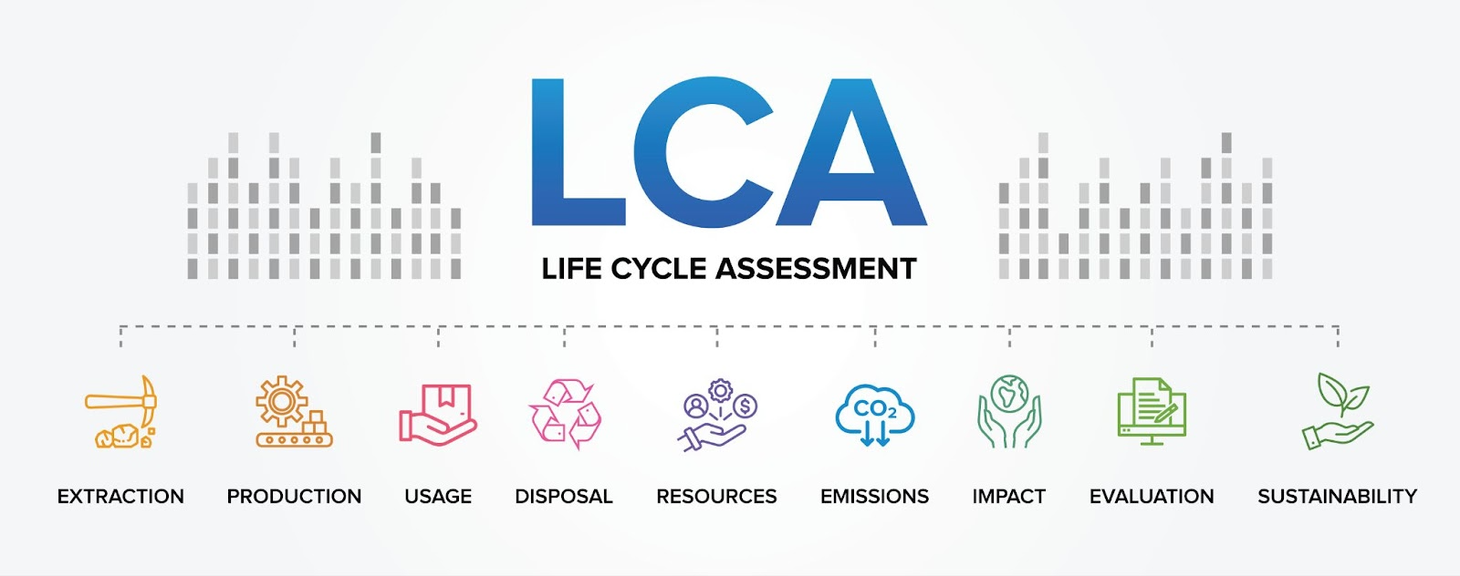

Lifecycle Assessment (LCA) and Its Role in Sustainable Design
Lifecycle assessment (or analysis) looks at the costs and benefits of a product from “cradle to grave”—from raw material extraction/creation to end-of-life management. This approach enables designers to identify opportunities to minimize environmental impacts, conserve resources, and lower costs. ISO 14040 is the international standard that provides guidance on what qualifies as a life cycle analysis and how to conduct one. There is a standard task checklist for engineers to undertake, which includes:
  1. Goal and Scope: The goal and scope step is used to define what the LCA will and will not examine. When analyzing a product life cycle, not everything can be taken into account. If there is reasonable evidence to suggest that certain aspects aren’t high impact, then they can be removed from the analysis.
  2. Inventory: An inventory of all the information used for the analysis is required. Information can include emissions, energy consumption, and end-of-life considerations.
  3. Impact Assessment: Using the inventory, an impact assessment is carried out against key factors such as ozone depletion, acidification of the local ecosystem, human toxicity potential, etc.
  4. Interpretation and Improvement Assessment: Interpretation makes sense of the LCA data and evaluates the study’s reliability and integrity, and not all impacts can be measured perfectly. The improvement assessment compares the impact assessment against the goal and scope to determine if the goals have been achieved within the defined scope. Recommendations for improvement can be added to this section.

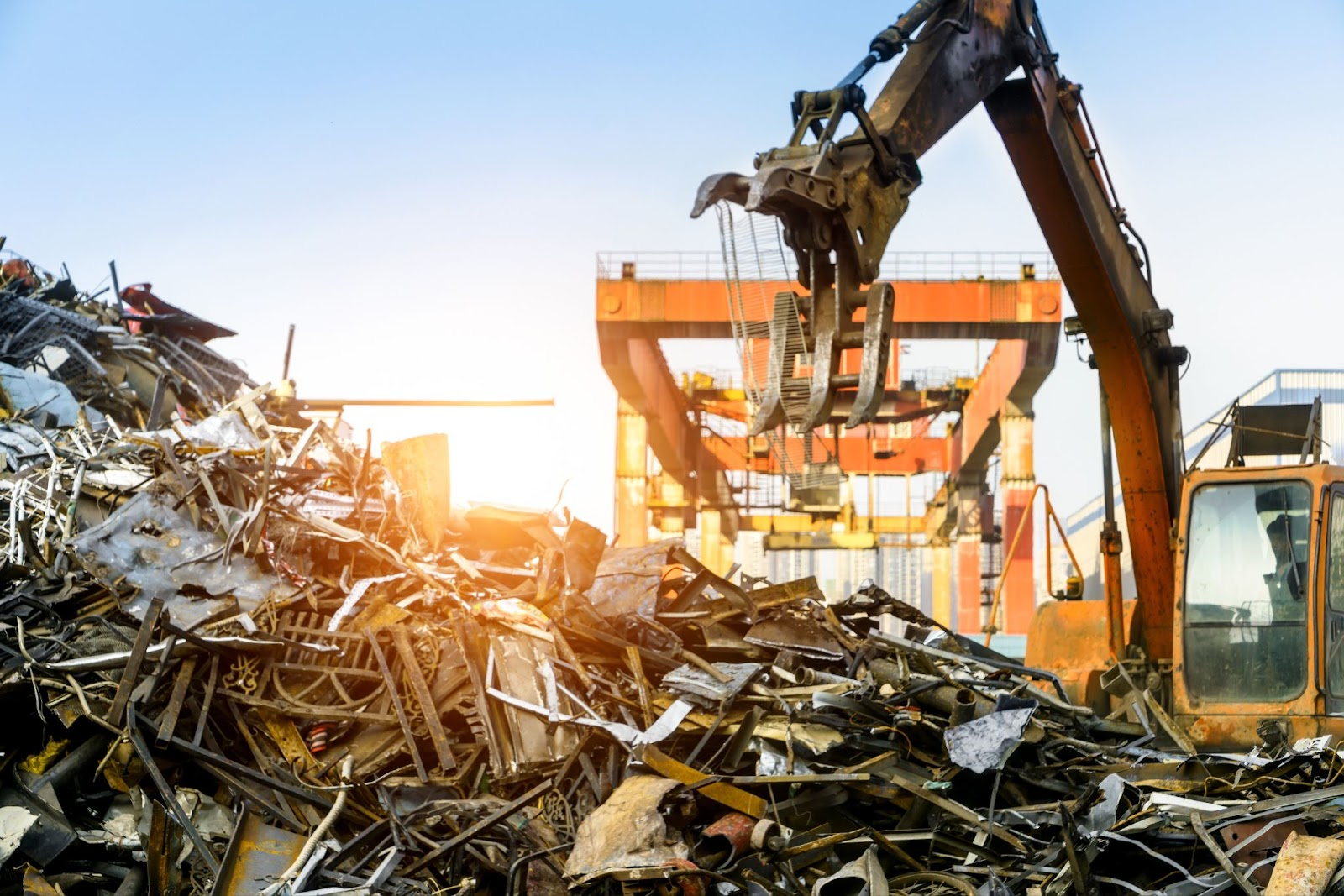

Sustainable Metals
Opting for renewable materials is a key aspect of meeting sustainability objectives. In terms of metals, this can include both aluminum and steel, which are both recyclable. Approximately 75% of all aluminum extracted is still in use today, according to the International Aluminum Institute. However, aluminum alloys are more difficult to recycle back to raw aluminum, which is a potential issue in industries such as aerospace, where control over metal impurities is crucial to safety.

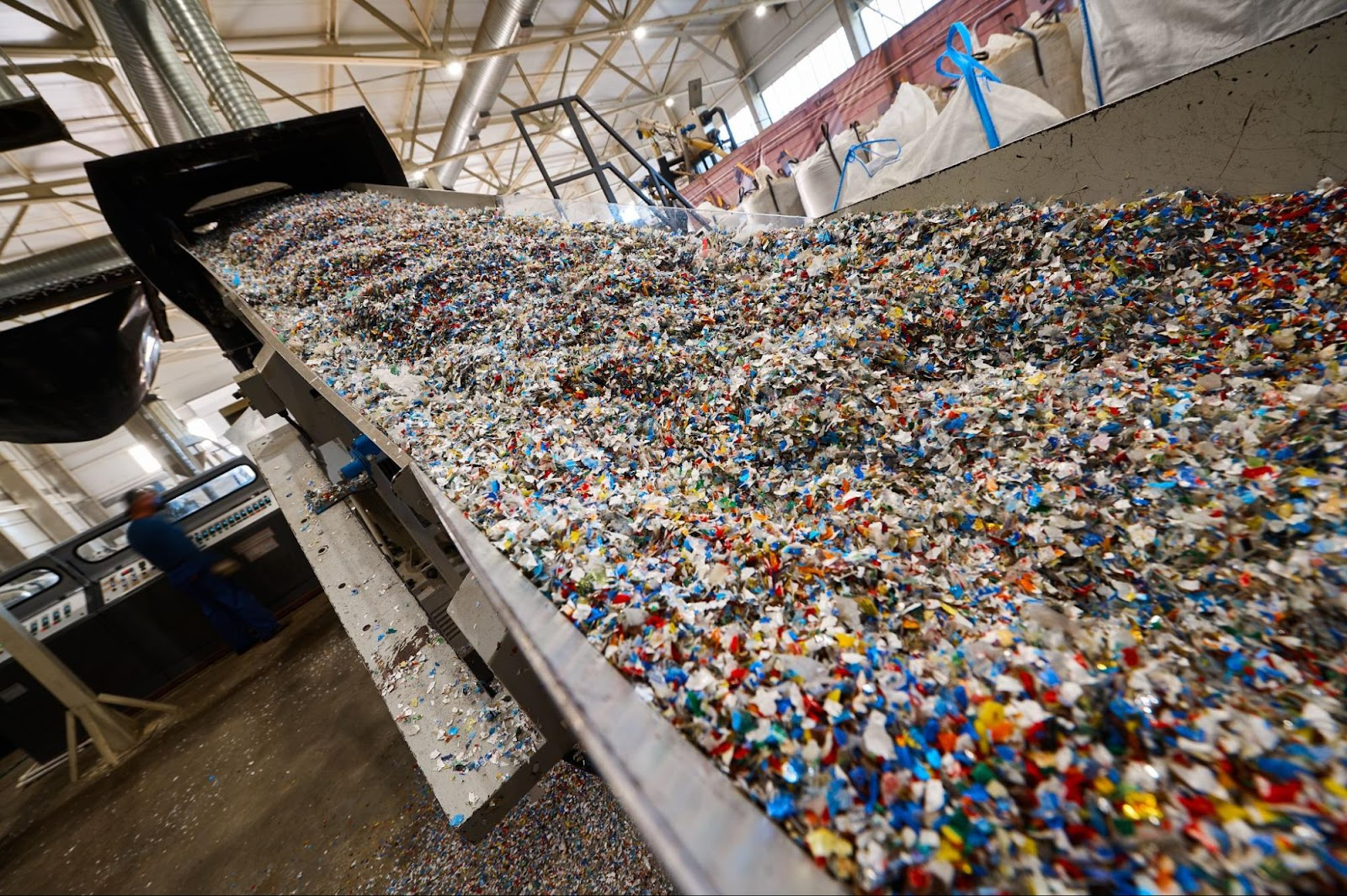

Recycling thermoplastics
Recycling of plastics
