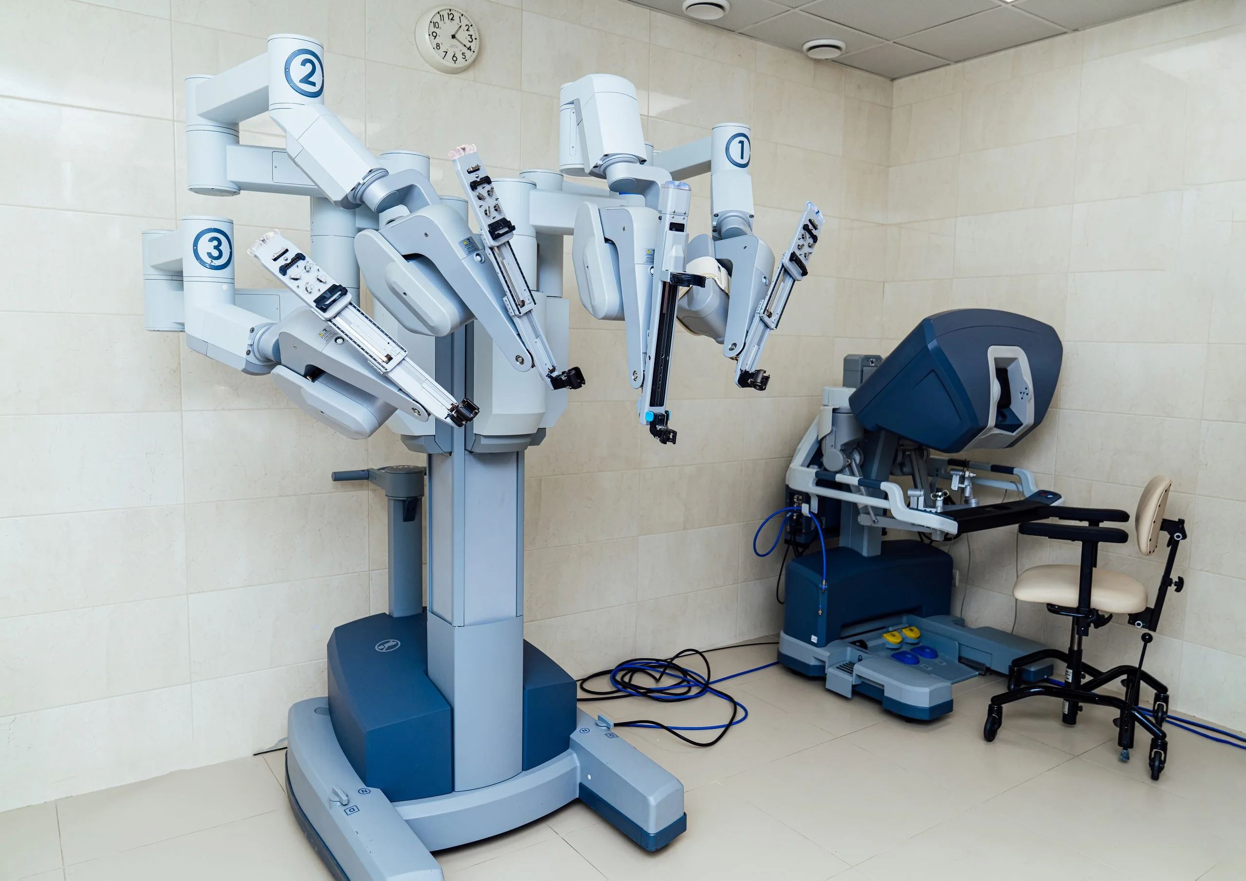

Da Vinci surgical robotic system

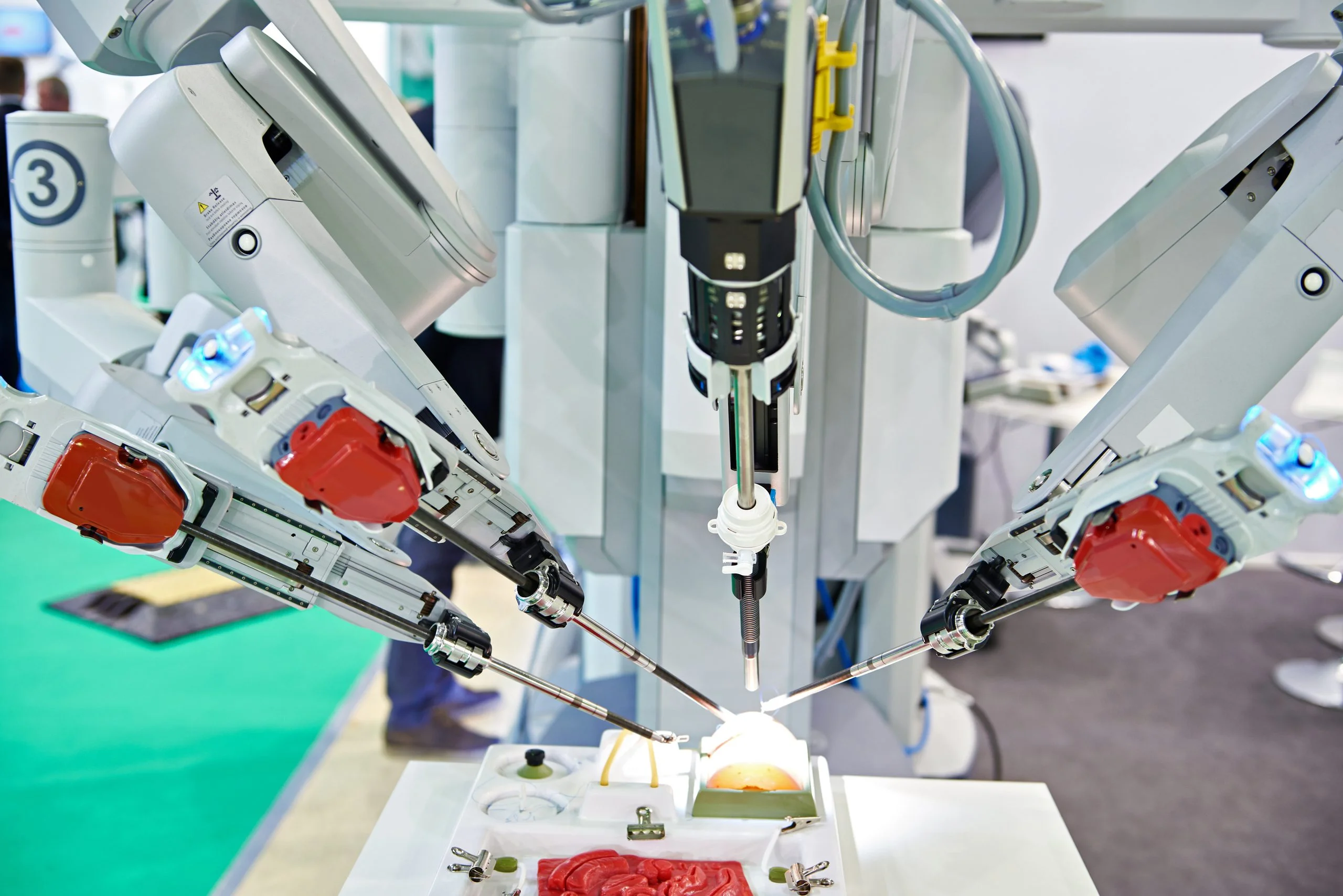

DaVinci surgical robot practicing surgery

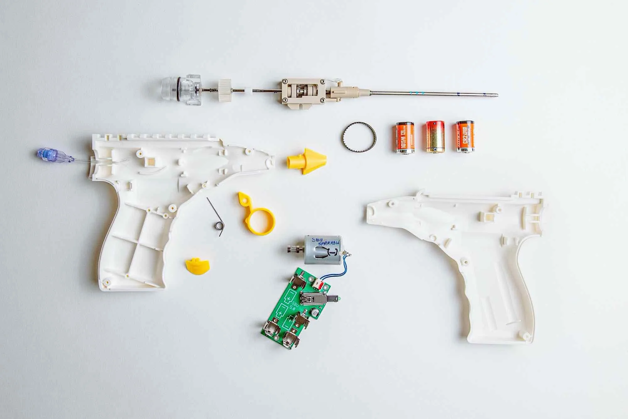

TransMed7 Fictiv case study
Read our TransMed7 case study to learn how Fictiv helped save time and cost on development for their biopsy devices.
