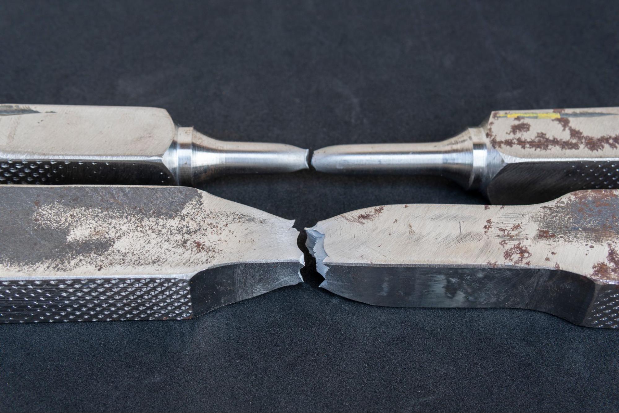

Yield vs. Tensile Strength
Yield strength is the stress at which a material begins to deform plastically (permanently). Below this point, deformation is elastic, meaning the material returns to its original shape once the load is removed. Tensile strength or ultimate tensile strength (UTS) is the maximum stress a material can withstand while being stretched before necking occurs, which leads to eventual fracture.
For most structural components, yield strength matters more than UTS because permanent deformation becomes a problem long before fracture occurs. Having a relatively large gap between yield strength and tensile strength is usually a good thing, as it indicates that the material is ductile and will give plenty of warning (visible bending or necking) before it snaps.
For very brittle materials, the yield strength is less significant, as these materials don’t bend or neck before they break. Tensile strength is the most important factor because it results in instant failure once the limit is reached.

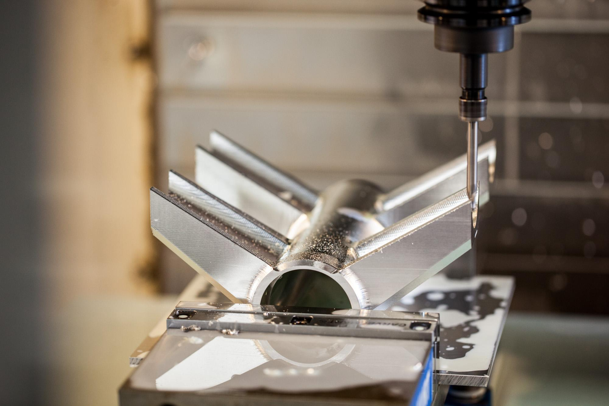

Geometry Rules
When working with high-strength materials, geometry decisions have a major impact on cost.
- Avoid deep, narrow pockets that require long tool engagement, which increases deflection and tool wear.
- Add generous internal radii instead of sharp corners so larger, more stable tools can be used at better cutting parameters.
- Reduce long, thin walls that are prone to chatter and distortion under higher cutting forces.
- Most importantly, plan proper tool access. Strong materials punish poor accessibility—awkward tool angles and long-reach setups directly translate into slower machining and higher scrap risk.
