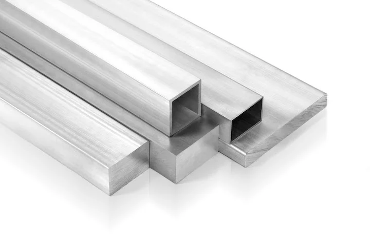

  • Aluminum: lightweight, good strength-to-weight ratio, easy to machine

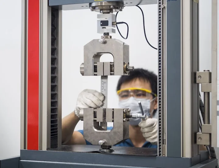

Tensile testing to get mechanical property values
The first and most important thing to consider when choosing a material for CNC machining is its properties. Both metals and plastics have the following set of relevant material properties:
  1. Electrical: electrical conductivity, permittivity
  2. Thermal: coefficient of thermal expansion, specific heat, thermal conductivity
  3. Mechanical: strength, hardness, ductility, malleability, elasticity, toughness, brittleness, stiffness

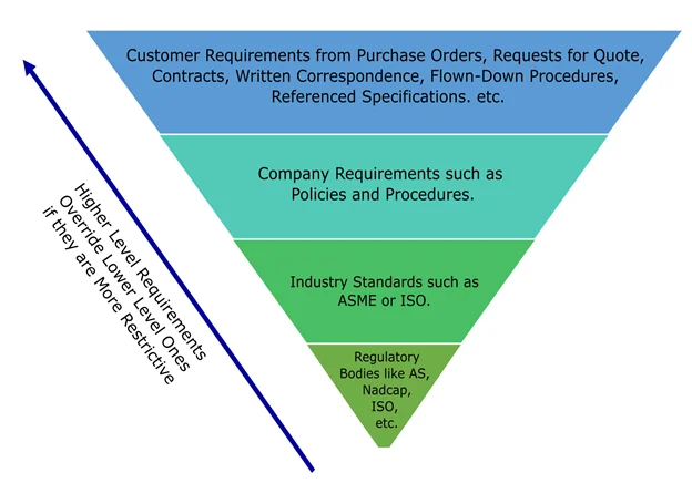

Consider Statutory, Quality, and Regulatory Requirements
Ensuring that you meet statutory, quality, and regulatory requirements is often the job of a design engineer, and meeting those requirements starts with choosing the right materials. Here is a graphic to help simplify the hierarchy of competing requirements:
handling competing requirements for the design of a part
Use these tips to simplify picking the best material for regulatory, statutory, customer, and quality requirements:
  • If your project requires specific certifications, such as aerospace or medical certifications, then you must choose a material that meets those requirements — so check the certification requirements before making a selection. Examples of regulatory requirements include RoHS, REACH, and Conflict Minerals Regulation.
These requirements can be complex, so it’s important to thoroughly understand and research them before selecting a material — and check that your material type can be tested for the certification process that it must undergo to be certified. Not all materials are compatible with all testing procedures.
  • The sustainability of your materials should also be considered. Some materials, such as aluminum and steel, are easily recyclable, while others, such as plastics, are more difficult to recycle or not recyclable at all. Your sustainability requirements may include checking the carbon emissions for your material during procurement and/or raw material refining.

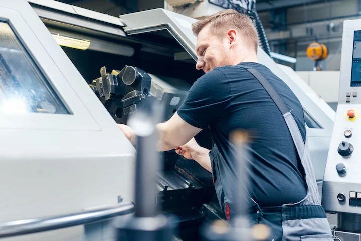

Consider How the Material Behaves During Machining
CNC Machining operator loads material to be machined
It’s also advisable to look at how the material behaves during machining using the following guidelines:
  • Machining Process: The type of machining process you plan to use can also impact your material selection because some materials are better suited for certain machining processes, such as milling or turning, than others.
  • Tool Wear: The material you choose impacts the wear on your machining tools. Some materials, such as high-temperature alloys, can cause excessive tool wear and may require specialized tooling to machine.
