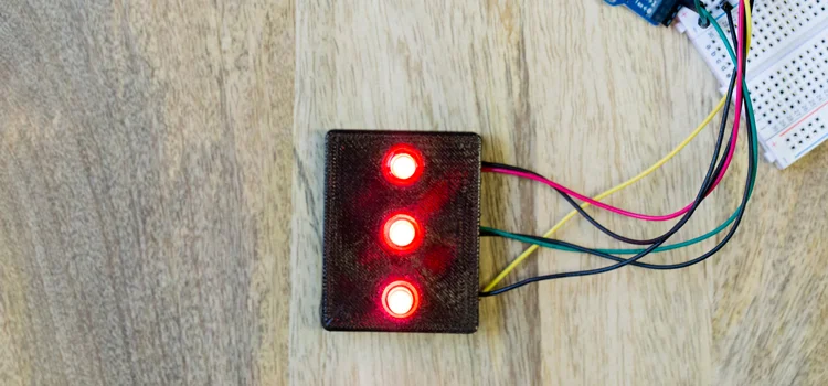

In this article, we’ll consider a practical application of 3D printed optics: the LED light pipe. We’ll look at a common application of 3D printed light pipes/3D printed light guides in consumer products: a “mini” light pipe used to channel the light from a standard 5mm LED mounted on a printed circuit board to a user interface.

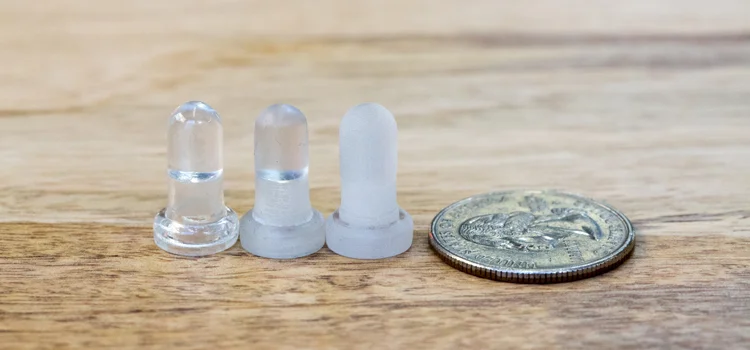

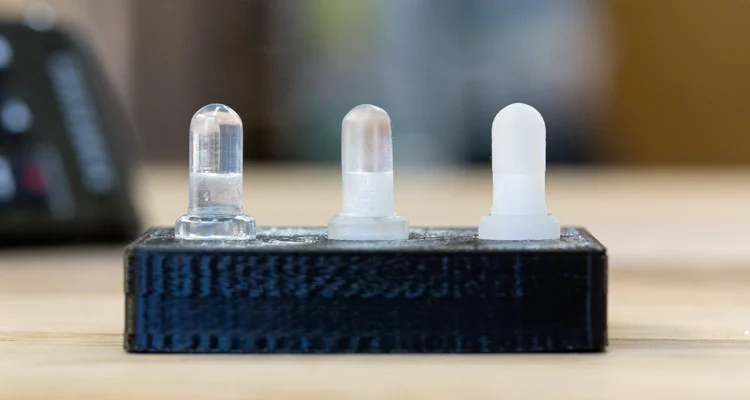

To investigate the best 3D printed light pipe material, we’re going to print light pipes using 3 different material samples:
- VeroClear material, unfinished.
- VeroClear material surface finished with a 2-part polyurethane clear coat
- Acura 60

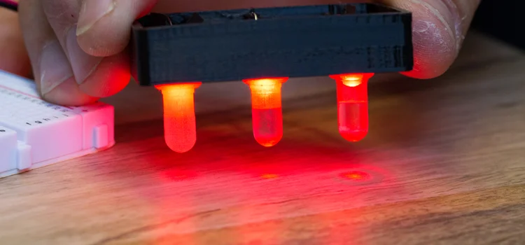

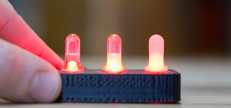

VeroClear – Unfinished
The first material sample we tested was the VeroClear unfinished material light pipe.
The VeroClear material printed a bit cloudy, causing less internal reflection than the other two samples. Though cloudier than the other two samples, this sample still provided a bright, even glow when lit with our red LED.
VeroClear – Finished
The second material sample tested consisted of the same VeroClear material but finished with a two-part polyurethane coating.
The coating caused a more even diffusion pattern, providing an even softer illumination effect than observed in the unfinished component. This is because the finish creates an optical boundary that causes light to diffuse more evenly across the coated surface as it exits the light pipe.
Acura 60
The final sample tested in the series was the Acura 60 material, which printed quite clearly.
As a result, when lit, the Acura 60 light pipe provided a more specular glow, creating a halo-like caustic pattern as the light from the light pipe reflected off of nearby surfaces. This unique effect was not observed in the two VeroClear samples.
Summary of Results
The greatest differentiation in results was observed between the unfinished VeroClear and the Acura 60 samples. The finished VeroClear sample provided final results somewhat in-between both of the Acura 60 and the unfinished VeroClear material.
