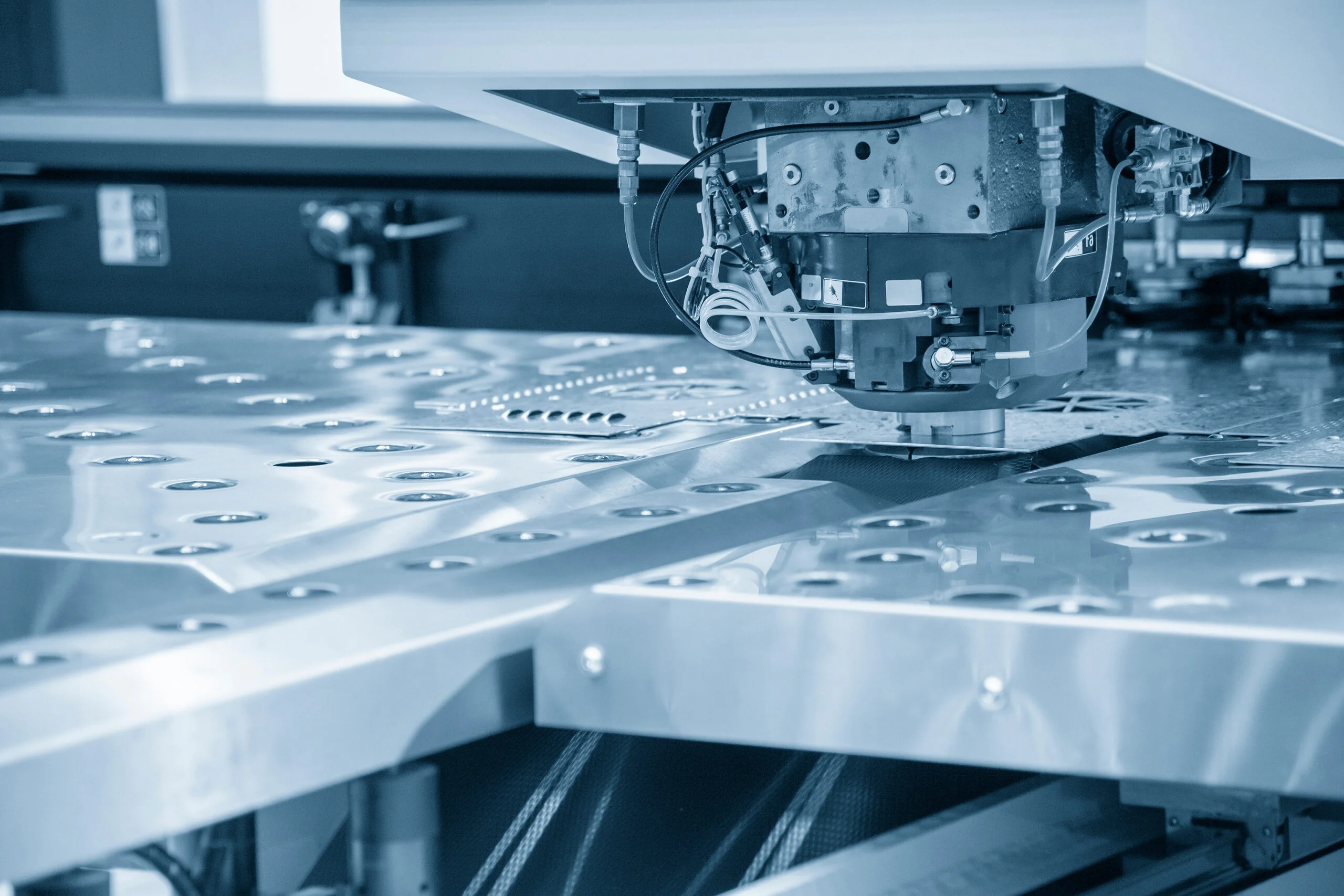

A CNC turret punch cuts and forms sheet metal using a selection of punch and die sets. The machine positions the punch or sheet under CNC control and indexes the required tool into position. It drives the punch through or into the material with a servo-electric, mechanical, or hydraulic punching system.
The turret holds a preloaded selection of tools for common holes, slots, and other shapes. Many tools are standard catalog items, though special geometries will typically need dedicated tooling. Once the appropriate tool is selected, a hole or formed feature is produced in a single stroke. So, for high-hole-count flat patterns, punching is often faster than laser cutting for common features.
The punching process also does work that a conventional 2D laser cutter cannot. Forming tools can produce louvers, lances, embosses, extrusions, bridges, and other 3D features without moving the part to a separate press. Turret tooling also supports operations such as marking, countersinking, deburring, and even some tapping applications.
Tooling has a big influence on part economics. A standard round, square, or obround (pill shape) punch will be available in the shop. A proprietary shape can require a custom punch and die, adding both cost and lead time. Where the geometry can be changed to use standard tooling without affecting function, the production cost may fall considerably. The benefit of this “whole feature in one action” becomes more pronounced as the feature count and production quantity increase.
Material thickness is the practical ceiling for turret punching that engineers often underestimate. Mild steel above about 6mm and stainless above 4mm may put you in territory where punch force requirements climb quickly—at that point laser cutting or waterjet is usually the more economical path and the fabricator will tell you so. Aluminum is more forgiving and punches well up to around 6mm depending on alloy.

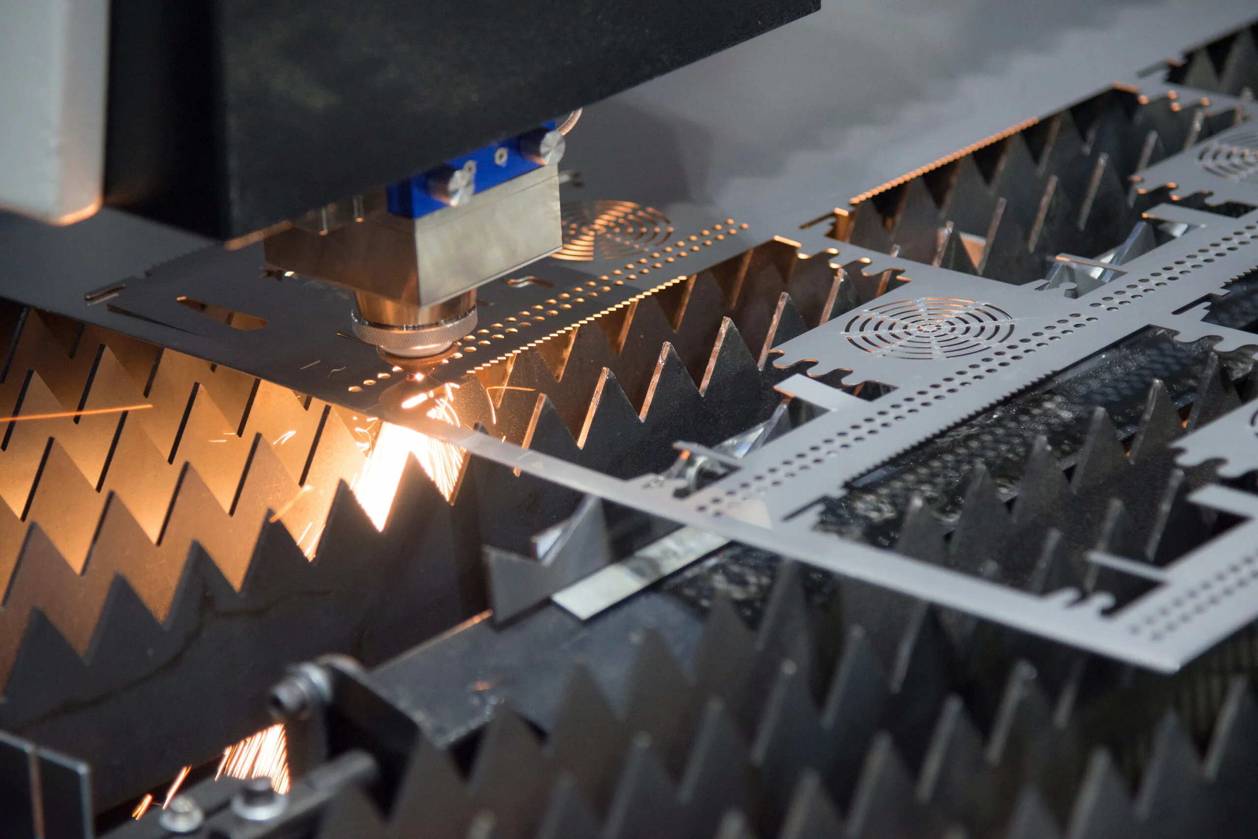

Laser cutting uses a tightly focused laser beam to melt and vaporize a programmed 2D profile. There is no dedicated cutting tool whose geometry determines the shape, so a change from a round opening to a curved slot, or irregular cutout, only requires a program change.
That freedom makes laser cutting ideal for prototypes, evolving designs, complex contours, and low- to medium-volume parts. Fine internal geometry can also be easier to produce by laser, where a suitable turret tool is unavailable.
Laser cutting generally leaves a smoother continuous contour than a profile generated by successive punch hits. This is relevant on visible edges and openings, where appearance is more important.
Its limitation becomes apparent when the flat blank requires three-dimensional features. The laser can define their profiles, but it cannot emboss the sheet or form a louver. Those operations require other processes.
One distinction that matters for certain applications: laser cutting introduces a heat-affected zone at the cut edge—typically 0.1 to 0.5mm on stainless steel, varying with laser type, power, and feed rate. For most sheet metal work, this is a non-issue. Where it becomes relevant is precision hole sizing on interference-fit features, or on stainless grades where the HAZ can affect corrosion resistance along the edge. If either applies to your part, it is worth flagging on the drawing or raising with the fabricator before cutting starts. Turret punching produces no HAZ, which occasionally makes it the better choice for applications where edge metallurgy matters even when laser cutting would otherwise be preferred.

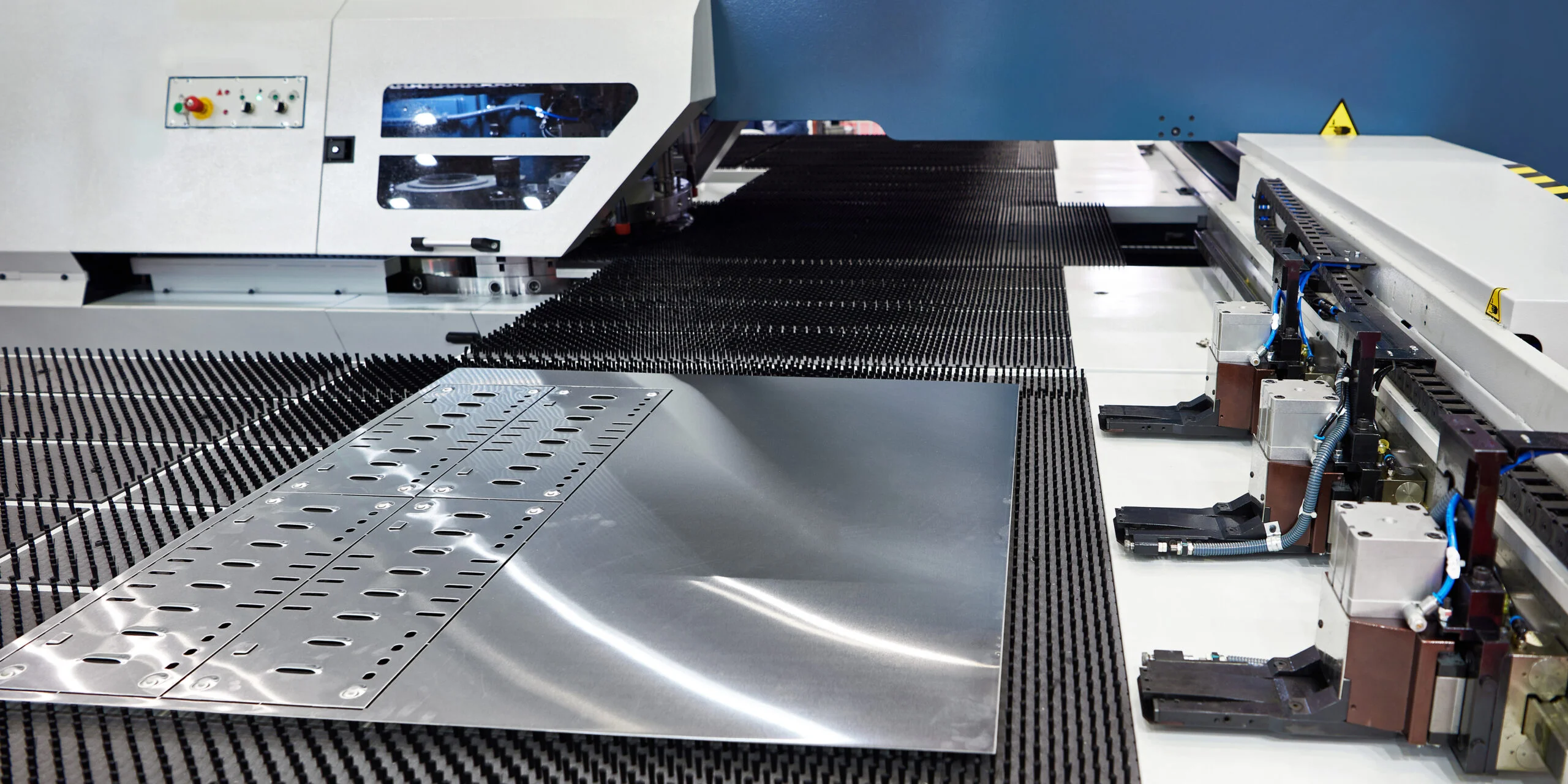

Turret punching patterns in sheet stock

Larger openings and curved profiles can be generated by nibbling, where a smaller punch makes a sequence of overstepped hits. The trade-off appears at the cut edge. Each hit intersects the previous one and leaves a small scallop, producing the characteristic nibble marks seen on punched curves. Increasing the overlap between hits can reduce their prominence, although this increases cycle time.
If a curved opening is cosmetic, forms a visible product edge, or needs a consistently smooth contour, identify that requirement. The fabricator can then laser cut the feature, select different tooling, or account for finishing, rather than discovering the surface requirement after the parts have been punched.
