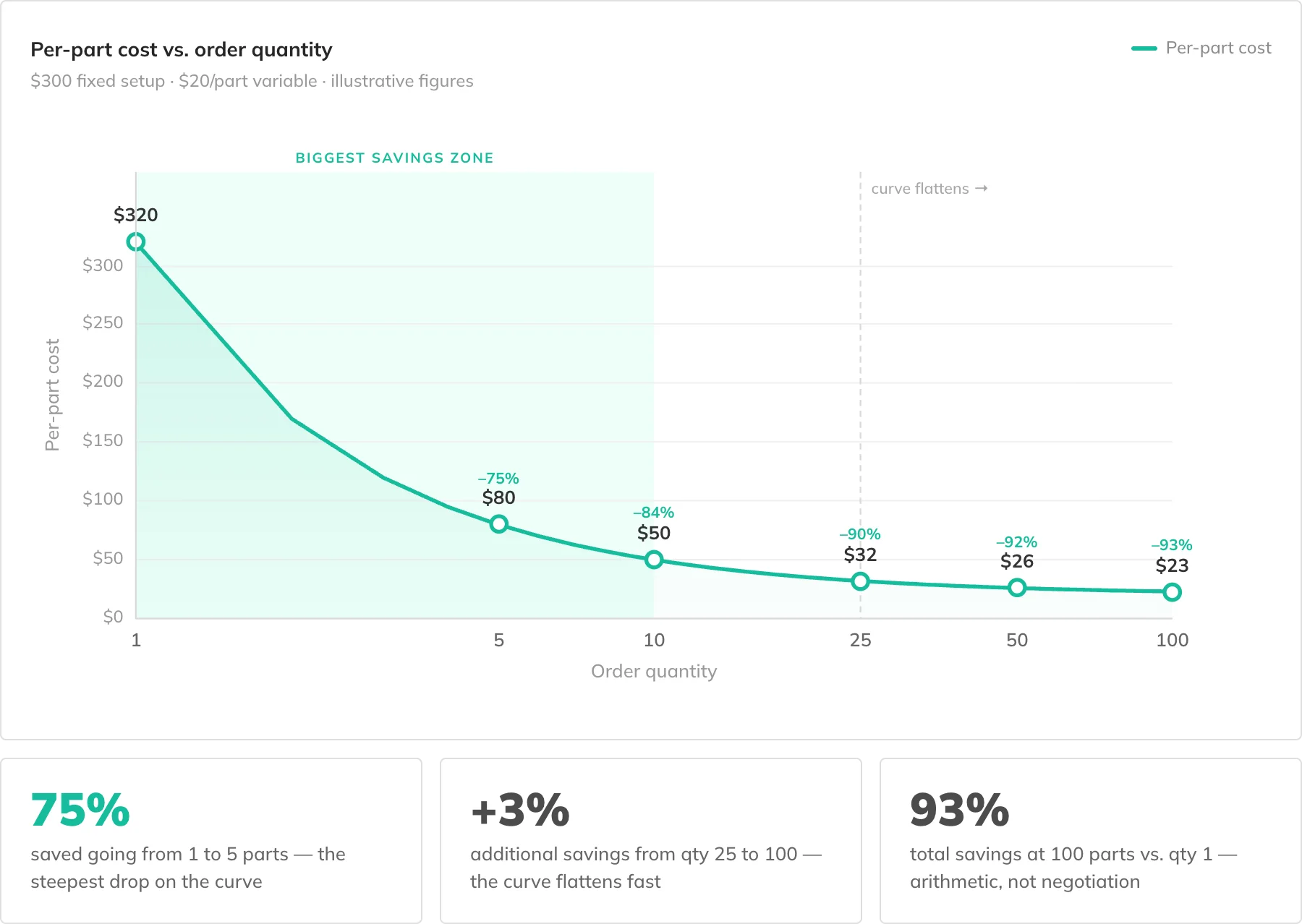

Fixed costs don’t shrink when you order more—they divide. Every part in the run absorbs an equal share. At QTY 1, one part carries 100% of the setup cost. At QTY 50, each part carries 1/50th. The per-part price drop isn’t a discount—it’s a mathematical result of these cost factors.
That arithmetic plays out using simplified illustrative figures:
QuantityFixed SetupVariable/PartTotal CostPer-Part Cost% Savings vs. Qty 1
1$300$20$320$320—
5$300$20$400$8075%
10$300$20$500$5084%
25$300$20$800$3290%
50$300$20$1,300$2692%
100$300$20$2,300$2393%
Illustrative figures only. Actual costs vary significantly by part, process, material, tolerances, and supplier.
Two things stand out. The savings are dramatic—going from 1 to 5 parts cuts per-part cost by 75%. And the curve flattens fast—going from 25 to 100 parts saves only an additional 3% per unit. The biggest opportunity is always at the low end of the quantity range, which is exactly where most engineers are operating during prototyping and early production.
The Manufacturing Cost Curve Model
Every manufacturing job carries fixed costs that are divided across all parts produced. The more parts, the smaller each part’s share—and the cheaper each part becomes.
Manufacturing cost curve of cost per part vs. order quantity

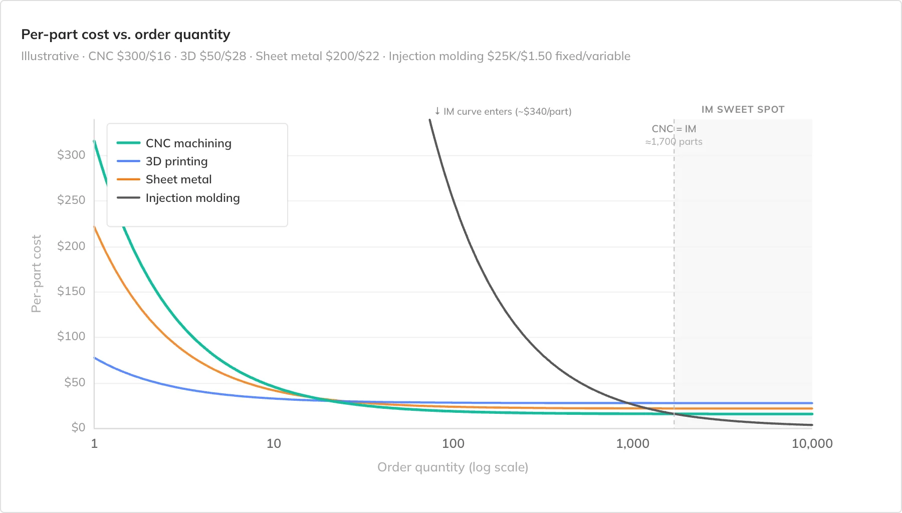

Process Cost Curves: Side by Side
Each process has a different fixed-to-variable cost ratio, which determines its sweet spot. Injection molding’s mold cost (~25K illustrative) places it off-chart at low volumes—it only becomes cost-competitive above ~1,700 parts.
per-part cost vs order quantity curve comparison of CNC machining, 3D printing, sheet metal, and injection molding
Volume Break Points: Where the Curve Changes the Decision
A volume break point is the order quantity at which per-part cost drops enough to meaningfully change the economics of a sourcing decision—the inflection on the cost curve where marginal savings from ordering more stop justifying the additional upfront spend. Every part has one, determined by its fixed-to-variable cost ratio for a given process.
The break point for a simple aluminum CNC part is different from a complex 5-axis titanium part requiring multiple setups and extensive FAI. For SLS 3D printing, build utilization shapes it as much as programming cost. For injection molding, it’s less about a single job and more about total production volume over the mold’s lifetime.
Volume break points involve lead time too, not just unit cost. Larger runs often benefit from post-process batching efficiencies—a full anodizing lot costs less per part than a partial lot and moves through the queue faster. A real production decision weighs unit cost, total cost, and lead time together.

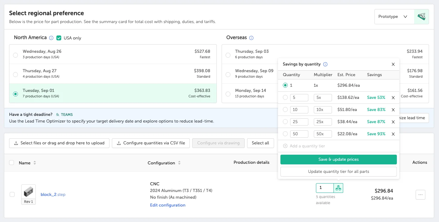

Multi-Quantity Quote on Fictiv Platform
Multi quantity quote on the Fictiv platform
Compare Multiple Manufacturing Costs With One Quote
Multi-quantity quoting puts pricing across up to five quantity tiers side by side, with lead time at each tier, from a single submission. For auto-quoted CNC, 3DP, or sheet metal orders, you can now see this comparison instantly. For parts requiring manual review, all tiers are priced and returned together. The decision—which quantity to order, whether to consolidate, where the volume break point is—becomes data-driven rather than a guess and check.
Numbers and figures are approximated and are intended as directional guidance only. Actual savings depend on your specific part, process, material, tolerances, and supplier.
Ready to see your part’s full pricing curve? Request a multi-quantity quote and compare up to five quantity tiers in a single submission—instantly for auto-quoted parts, or through one streamlined RFQ for parts requiring manual review.
