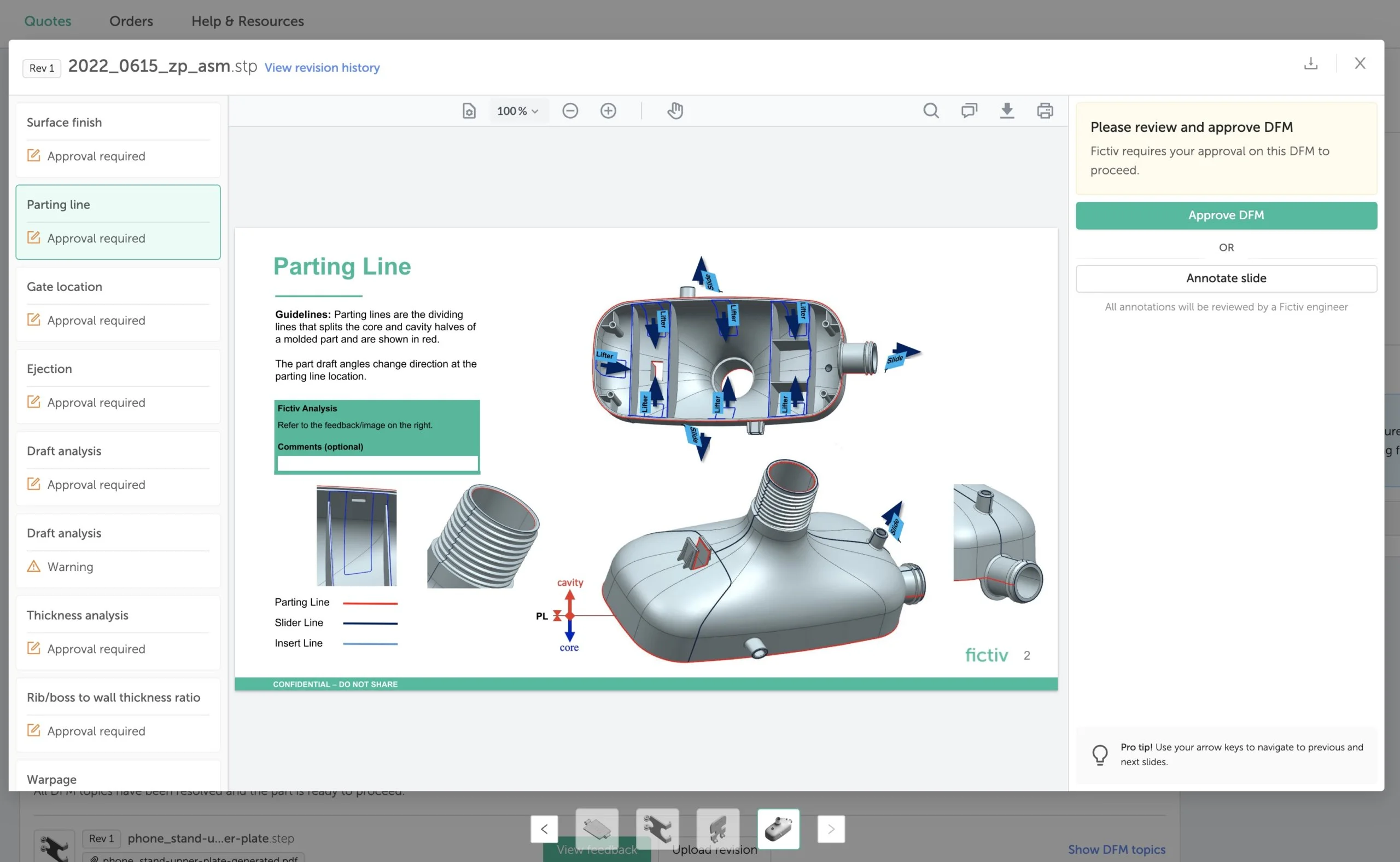

Preliminary DFM Feedback
Once a project is qualified for the injection molding process, DFM engineers evaluate the manufacturability of the part design by conducting pull direction, draft angle, parting line and thickness analyses. If a part includes elements that make it non-manufacturable or introduce risks to quality, design changes will be easier to make the earlier they are identified. During this time, you will also receive a quote, including price and lead time, for the mold and the requested parts.
Fictiv evaluates the manufacturability of the part design and provides a DFM report free of charge. The evaluation is enabled by Fictiv’s proprietary computational geometry technology. The report presents clarifying expert insight into the issues, a definition of project scope and next steps to address design issues.
IM DFM enhancement screenshot

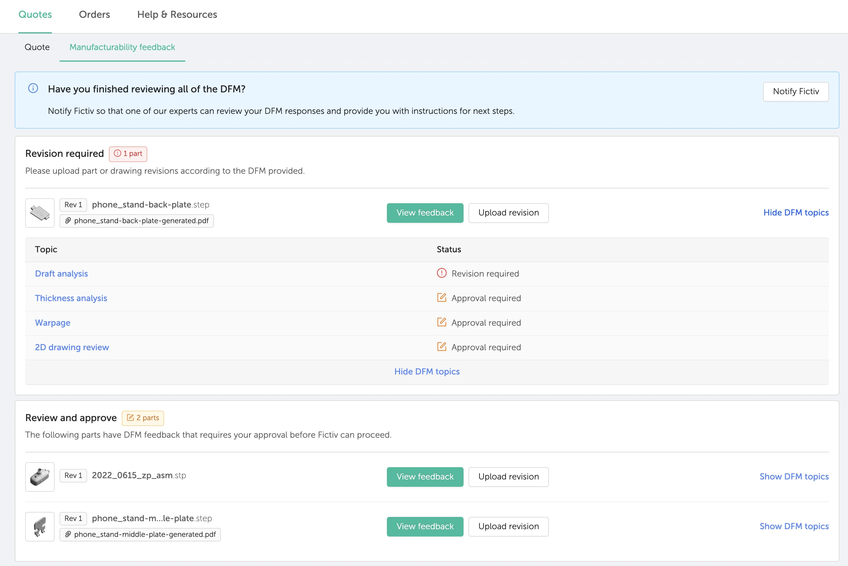

You can view all DFM reports online through Fictiv’s customer platform. The Fictiv platform is a secure web application that provides a fully streamlined process and makes all necessary information about your injection molding project available in one place. From the platform, you can:
  • View important issues at a glance
  • Upload updated CAD files based on provided DFM feedback
  • Submit approval to proceed
  • Follow project actions, updates and issue statuses
IM DFM enhancement photo
These capabilities have transformed the DFM process — removing the constant back and forth between customers and injection molding suppliers. This allows you to spend more time focusing on your part design and less time project managing.
