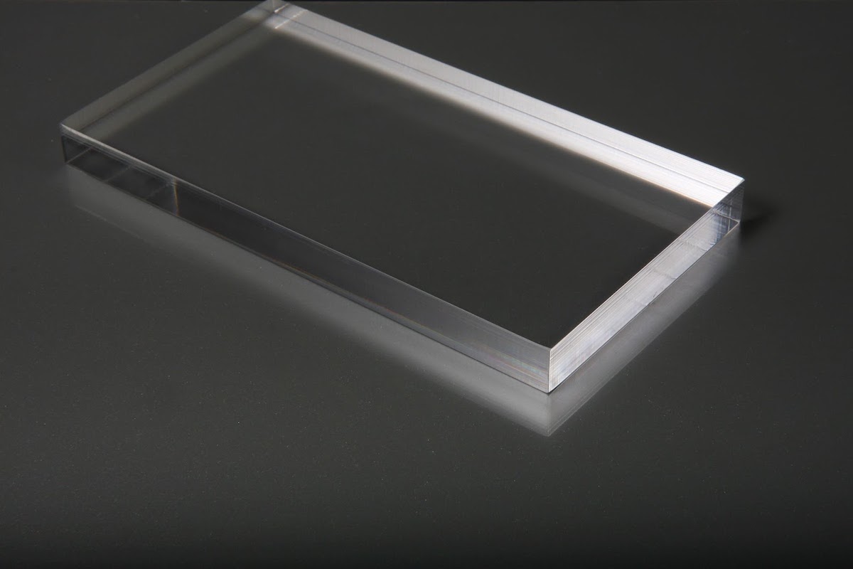

PMMA, or polymethyl methacrylate, is a type of plastic known for its transparency, strength, and durability. Due to its phyical structure, PMMA  is also resistant to UV light and has good weatherability, making it suitable for outdoor applications. These physical properties make PMMA well-suited for applications where transparency is important, such as signage and displays. It’s also used in applications where it’s subjected to wear and tear, such as automotive parts.
Acrylic is also a popular substitute for glass because of its cost effectiveness. For example, when this article was published, a 12”x12”x0.25” borosilicate glass sheet cost $49.60, but a 12”x12”x0.25” clear acrylic sheet cost $8.46 — that’s a huge difference in price!
PMMA is a popular choice for CNC machining because it’s easy to work with and can be machined to precise tolerances. It is relatively easy to machine, tough (more than 10x tougher than silicone glass) and easy to handle, making it a popular choice for even complex parts. There are two manufacturing methods for making PMMA for CNC machining applications: casting and extruding. Casting creates less internal stresses, so cast acrylic is less brittle than extruded acrylic and is more optimal for CNC machining processes. Ultimately, the choice between cast vs acrylic PMMA depends on your desired manufacturing process and product application.

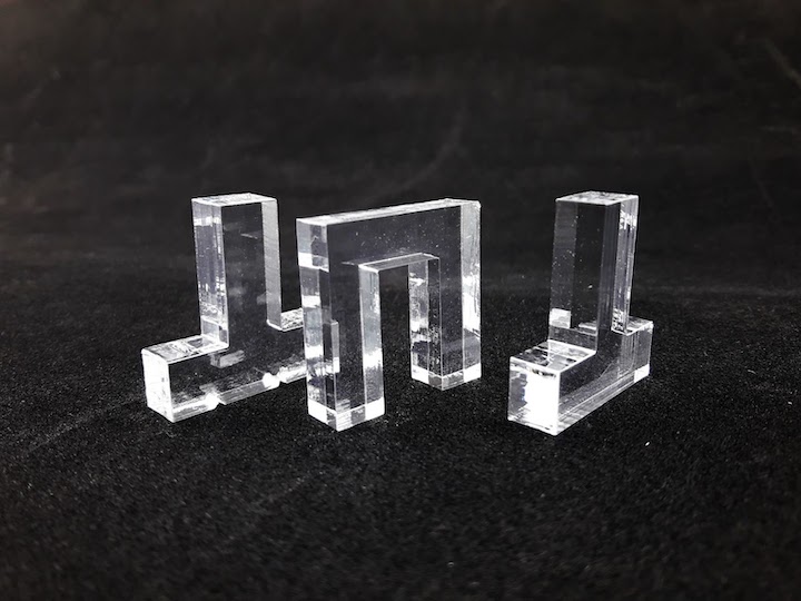

acrylic machined parts

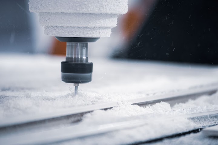

Tool selection: PMMA is a relatively soft material, and as such, it requires sharp and carefully chosen cutting tools to prevent tool wear and breakage. High-speed steel (HSS) tools are generally the best choice for machining PMMA, although carbide and diamond-coated tools can also be used. Only use tooling specified for plastic machining to cut PMMA — a good rule of thumb is to use a cutting tool with a high-shear flute geometry (1 or 2 flute tools), and around a 5° edge rake angle and a 2° clearance angle.
Cutting speeds: PMMA has a relatively low melting point, and as such, it’s critical to use moderate-to-low cutting speeds when machining the material. High cutting speeds can cause the material to melt or deform, leading to poor surface finish and tool wear.
Feed rates: Check out this study showing the impact feed rate has on the cut edge quality for PMMA machining.  It shows that a feed rate of 75% the rate at which the tool breaks was optimal for the cut edge quality. A more comprehensive white paper for utilizing a diamond micromill to maching acrylic can be found here.
Coolant: PMMA has a low coefficient of thermal expansion, and as such, it’s a good idea to use coolant when machining the material. Coolant helps prevent the material from overheating and improves surface finish. Since PMMA is compatible with a wide range of solutions, it’s not difficult to find a coolant that works.
