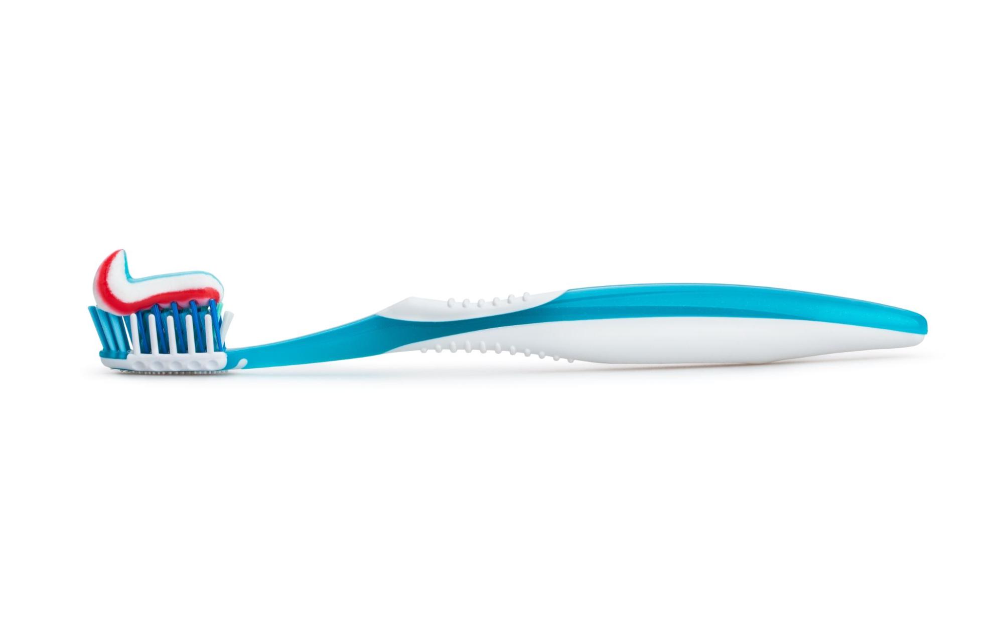

Many toothbrushes use overmolding to combine multiple materials

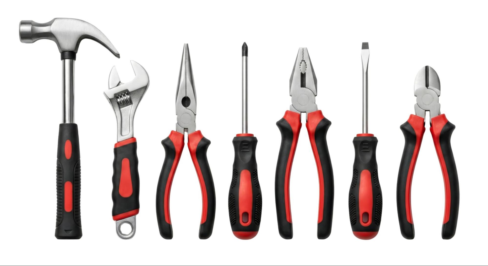

Tools with overmolded grips
