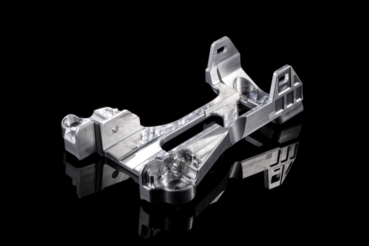

CNC Prototyping Cost
With CNC prototyping, the main cost drivers are the machining time, the amount of material that needs to be removed, and the complexity of the setup. More intricate features mean longer production time, which directly increases cost.
CNC machining is usually the preferred process when precision and real-world performance are the priority. Its main advantage is its high accuracy and ability to use production-grade materials like metals and engineering plastics, making it ideal for functional testing.
CNC-machined prototype cost

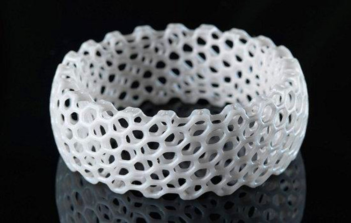

3D Printing Prototype Cost
3D printing is usually the best performer for early design-stage prototypes. The technology enables fast iteration, allowing designers to quickly fine-tune their concept. These designs can be made using minimal material, and cheap plastics typically suffice for initial testing and validation.
Key cost drivers are the type of material used, the time it takes to print a part, and whether there’s a need for support structures in the print. The more complex the part and the finer the details, the longer it will take to print the parts—which can affect the need for supports and whether or not post-processing steps will be needed.
The biggest advantage of 3D printing is its low setup cost and fast turnaround. Its main limitation, however, is that parts may not always match the strength or durability of production components.
3D-printed prototype cost

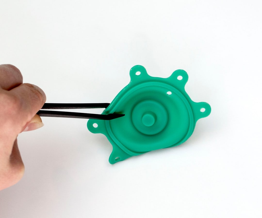

Urethane Casting Prototype Cost
Urethane casting is commonly used for low-volume functional and cosmetic prototypes that need production-like appearance without the high upfront cost of injection molding. The process typically starts with a 3D printed or CNC-machined master pattern, which is used to create a silicone mold for casting polyurethane parts. Tooling costs are much lower and lead times are faster than injection molding, making urethane casting a practical option for bridge production and small-batch prototype runs.
The main cost drivers for urethane casting are the creation of the master pattern, silicone tooling, material selection, surface finish requirements, and part volume. Silicone molds have a limited lifespan, so while urethane casting can produce high-quality parts with injection-molded-like aesthetics, it’s less cost-effective at higher volumes.
Urethane casting prototype cost

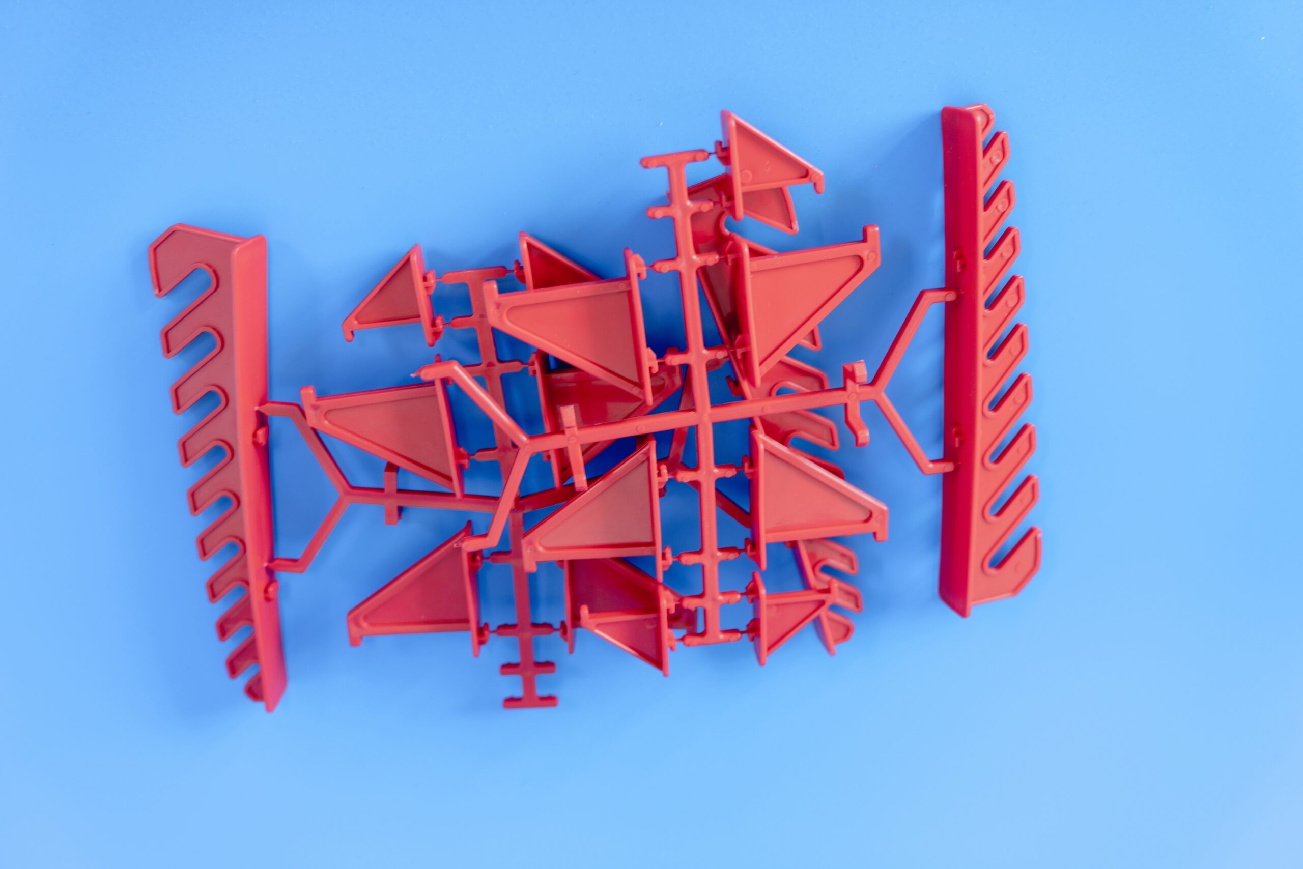

Injection Molding Prototyping Cost
Injection molding has a very different cost structure compared to the other methods. The biggest cost driver is tooling, which involves designing and manufacturing a custom mold before any parts can be produced. This upfront investment is what makes injection molding expensive for prototypes.
Once the mold is created, parts become less expensive to produce, especially at higher volumes. That makes injection molding a strong choice for production-ready prototypes or large-scale production of final parts. The trade-off is the high initial cost, which can be difficult to justify for small quantities or early-stage designs.
Prototype injection-molded part cost
