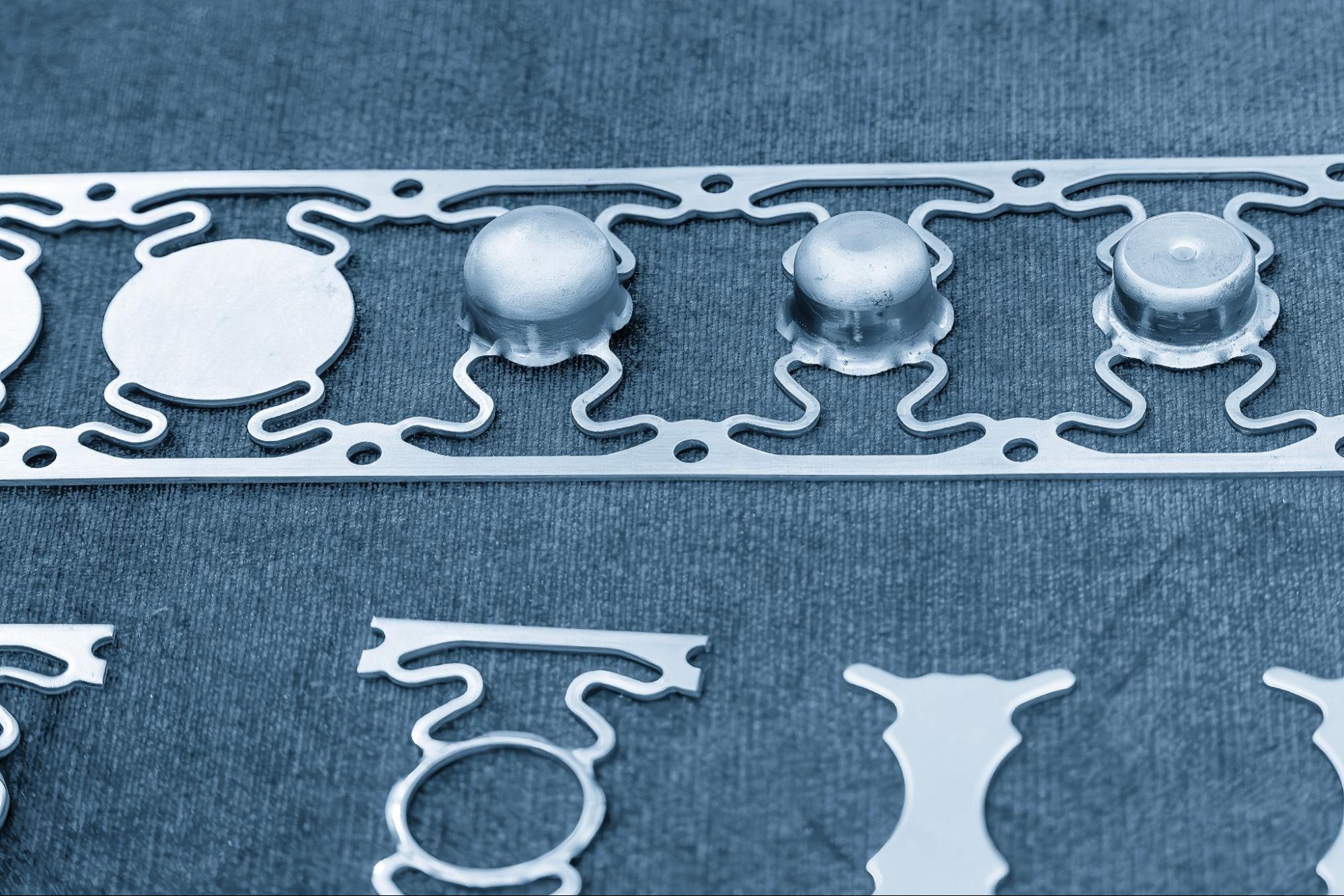

Metal parts made with a progressive die.

Progressive stamping is a metal forming process in which a continuous strip is fed through a single die set containing multiple sequential workstations. Each station performs a specific operation on the strip, and with every press stroke, the strip advances to the next station until a finished part is produced.
Unlike traditional sheet metal fabrication, where a part is cut from a sheet and then moved, progressive stamping keeps the part attached to a continuous “carrier strip” throughout the process.
The progressive sheet metal stamping process includes:
  1. Feed: A motorized decoiler feeds a metal coil into the press.
  2. Stroke: The press moves downward and engages the entire multi-station die simultaneously.
  3. Progression: Each station performs its task simultaneously. As the press opens, a feeder advances the strip.
  4. Result: With every stroke, a finished part is completed and ejected.

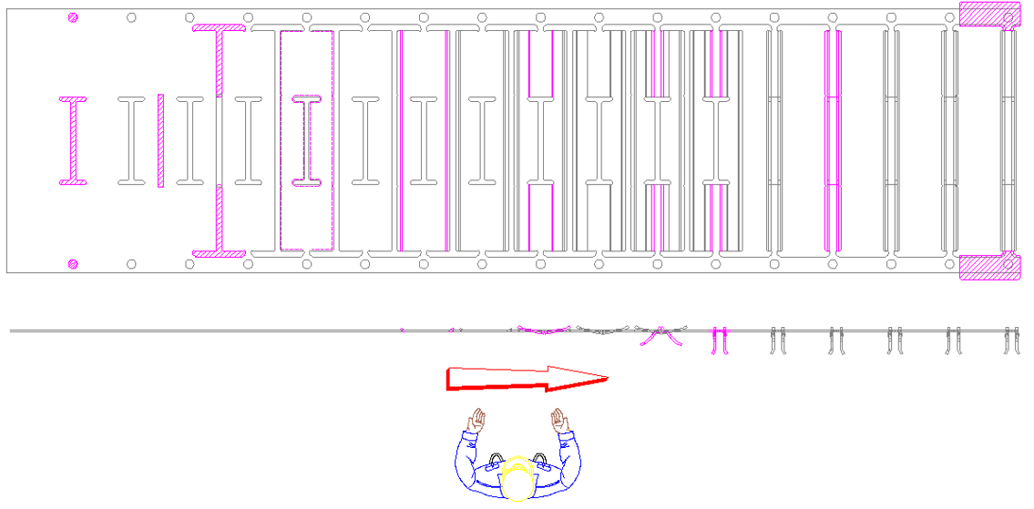

Anatomy of a Progressive Die
  • Stations: Stations are the sequential stops in the tool for punching, notching, bending, etc.
  • Pilots: Pilots are conical pins that enter previously punched holes in the carrier strip to ensure perfect alignment before punches hit. This registration is vital for maintaining tight tolerances across millions of parts.
  • Punches and Dies: Punches are the upper components that penetrate the material into the lower die blocks to create shaped features and cut geometry.
  • Strippers: Strippers are plates that hold the strip flat and strip the metal off punches as they retract to prevent jams.
The engineering required to time these stations is significant. If the strip advances slightly off-progression, it can chip punches, collapse die steel, or catastrophically damage the tool. While this complexity drives the high upfront tooling costs, the payoff is an automated factory system engineered for millions of cycles without failure.
Progressive stamping diagram showing pink for parts in motion and tooling for each press series
