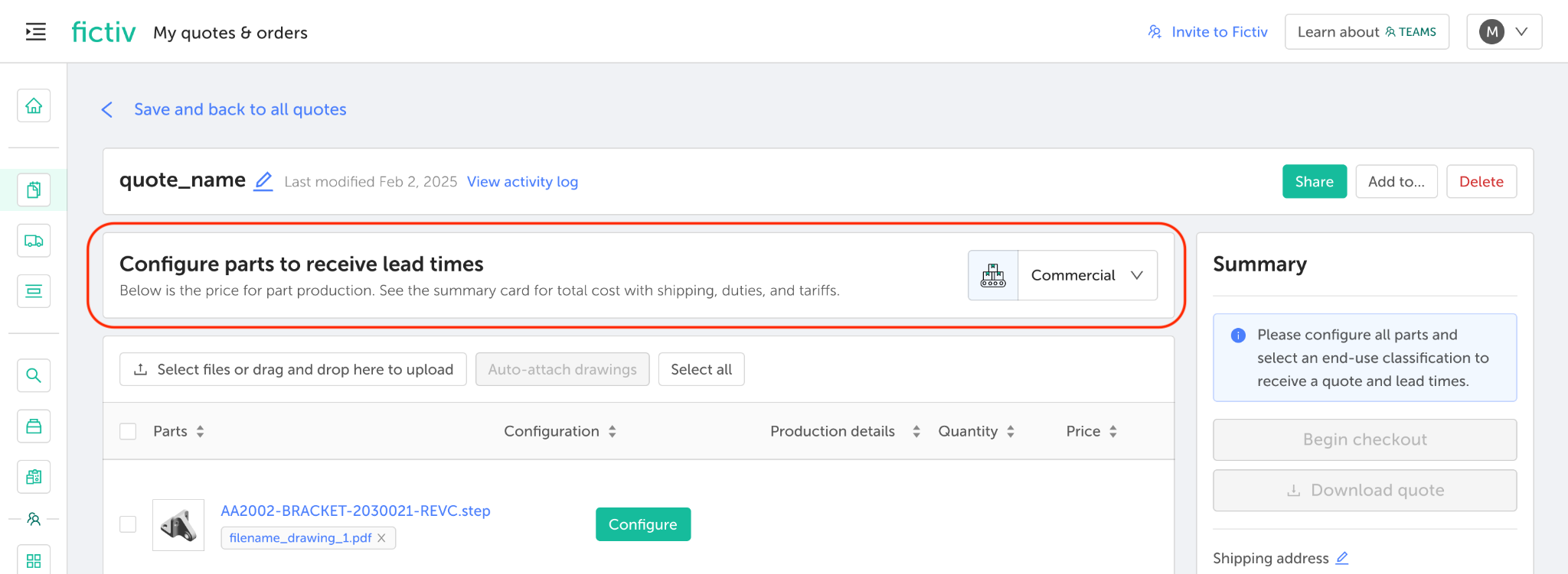

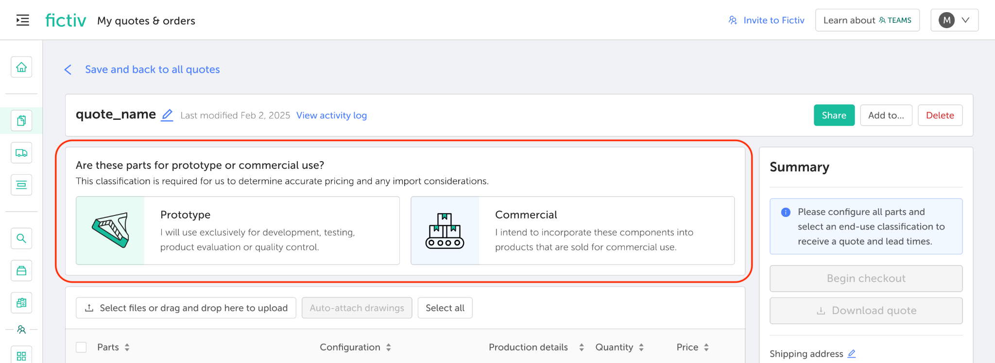

2. Select a Classification
After uploading your parts, you’ll be asked to specify their end use (e.g., Prototype or Commercial). This step is required to see pricing, but you can continue configuring parts before completing it.
Fictiv platform end-use selection prompt (Prototype or Commercial) required to view pricing.
Note: This applies to new quotes, existing quotes, and reorders, as it affects tariff calculations.
3. Confirm Classification Display & Configure Your Part(s)
Once a classification is selected, it will appear at the top of the delivery date selection module.
Select the process, material, and finish that best fit your needs—or reconfigure your part for a different process.
You can update the classification at any time. Pricing will be displayed as long as parts are configured. Keep in mind that tariff costs will adjust based on your selection.
Fictiv platform showing a prompt to configure parts.

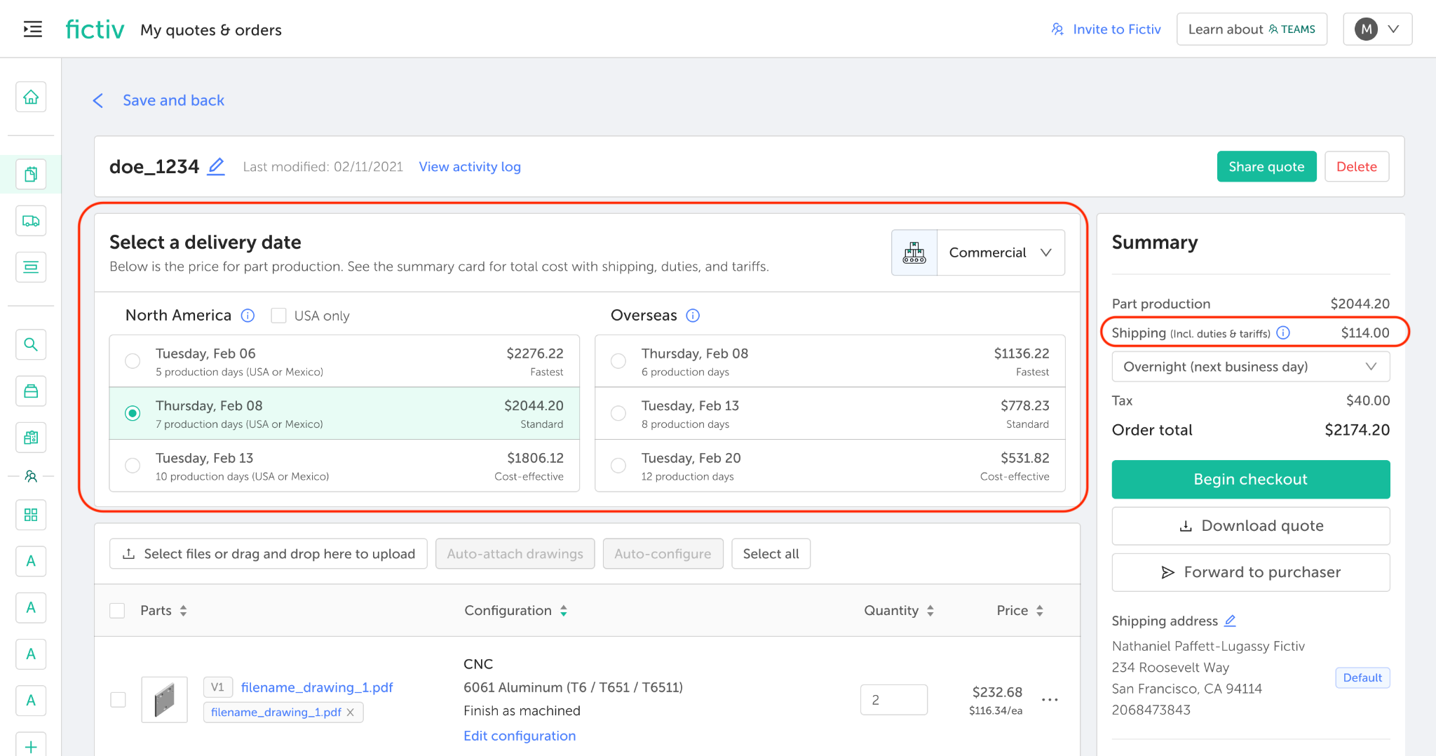

4. Select a Delivery Date
Once configuration is complete, the next screen will show lead time and pricing options.
You’ll see the Order Total in the Summary section (right side), which includes the total landed cost—covering shipping, duties, and applicable tariffs.
Fictiv platform showing delivery date selection and shipping including total landed cost.
5. Review Shipping Costs With Tariffs & Duties
After selecting a lead time, any applicable tariffs and duties will be included in the shipping cost.
These will be clearly labeled:
  • (Incl. tariffs & duties) when applicable
  • (No tariffs apply) when tariffs don’t apply

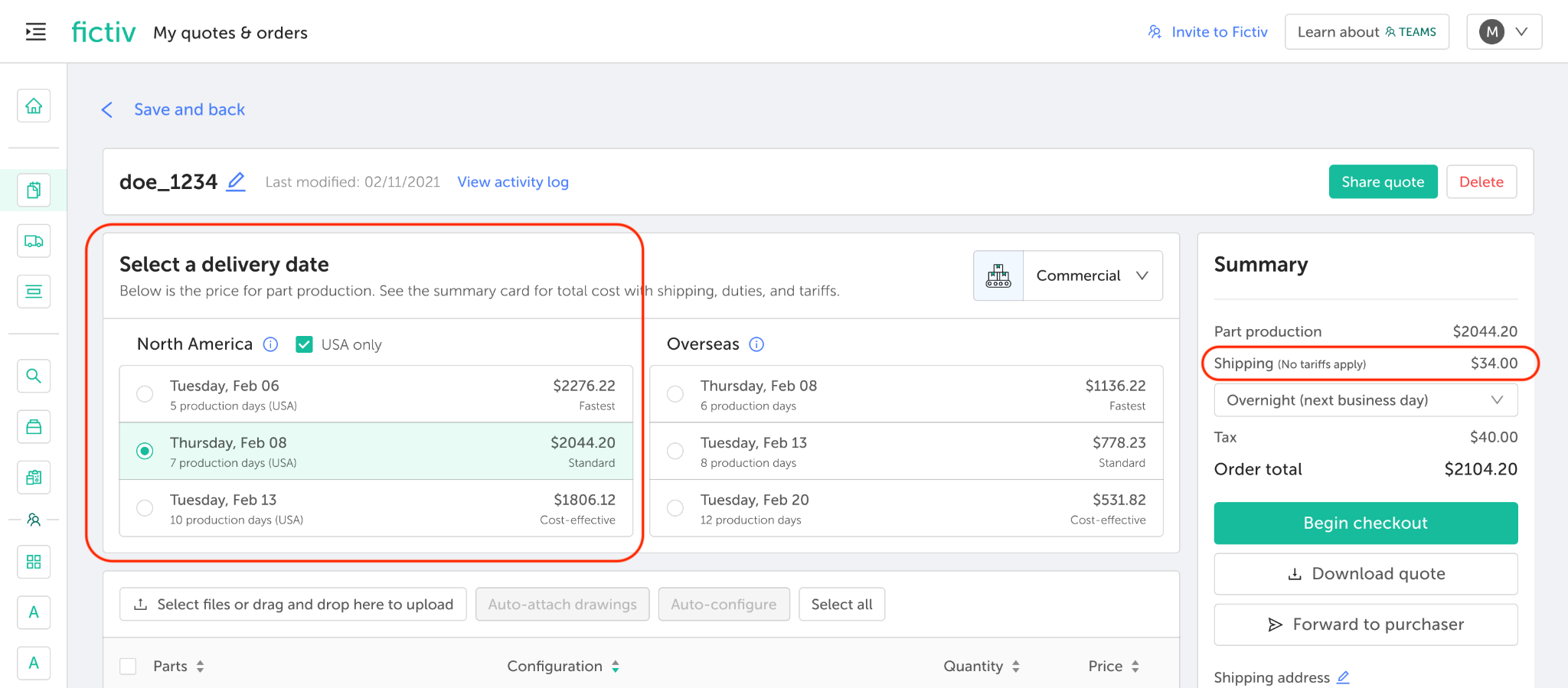

Fictiv platform showing domestic shipping with no tariffs applied.
Pro Tip: Check the “USA Only” box to source domestically—tariffs will not apply to these quotes.

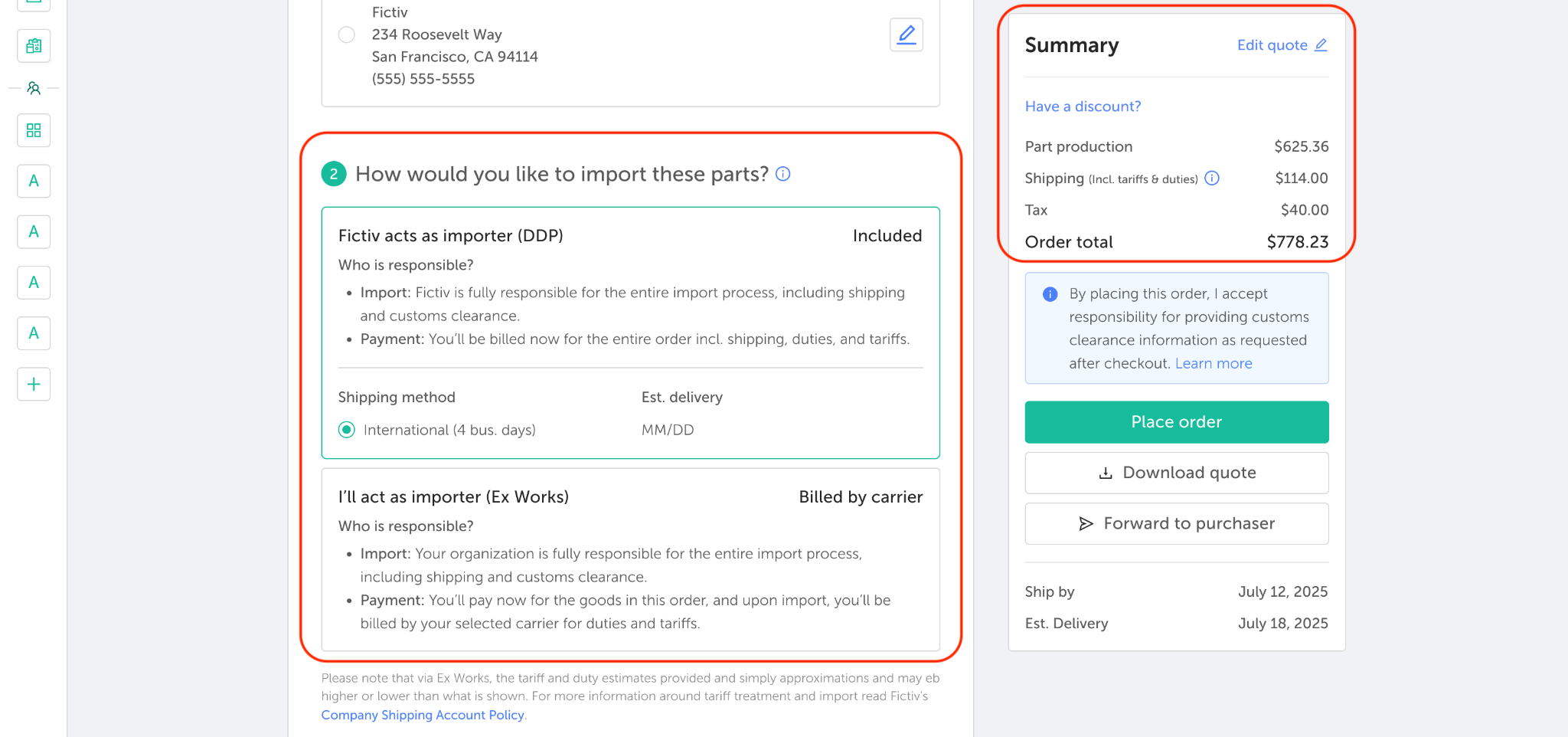

6. Begin Checkout to Access DDP & IoR Options
Start the checkout process to see total shipping, duties, and tariff costs clearly itemized. This is where you’ll choose who acts as the importer.
Fictiv platform showing DDP vs. Ex Works importer selection.
7. Importer Designation: DDP vs. Ex Works
  • DDP (Fictiv as Importer):
    Fictiv handles customs clearance and import responsibilities.
    The price shown includes all fees—no additional costs on delivery.

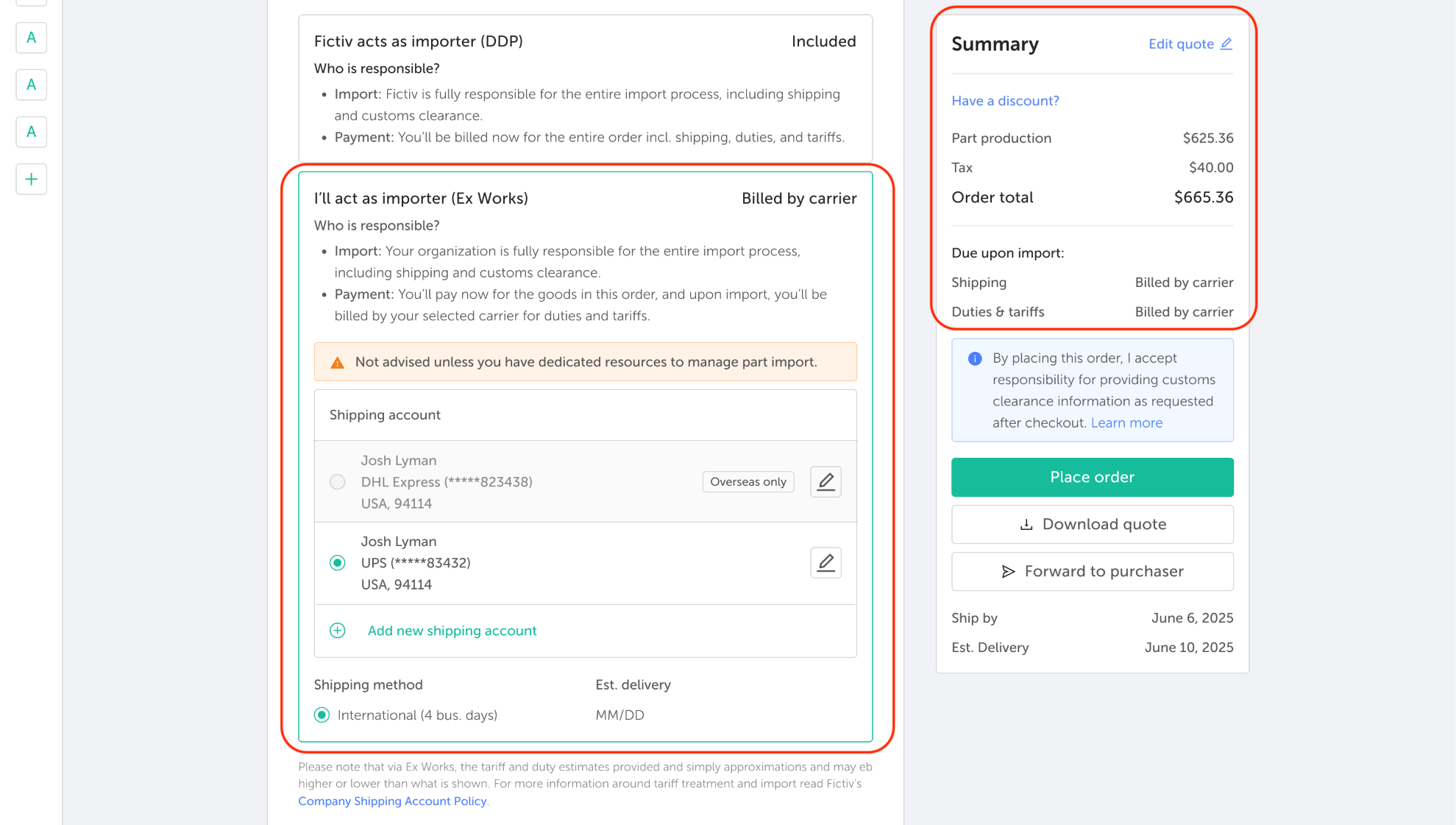

  • Ex Works (You as Importer):
    You’re responsible for calculating and paying tariffs and duties through your carrier.
    You’ll need a valid shipping account and assume full responsibility for customs and compliance.
Ex Works Configuration:
If Ex Works is selected, you’ll configure shipping using your own carrier account. Fictiv will not include duties or tariffs in your quote.
Fictiv platform showing Ex Works selection.

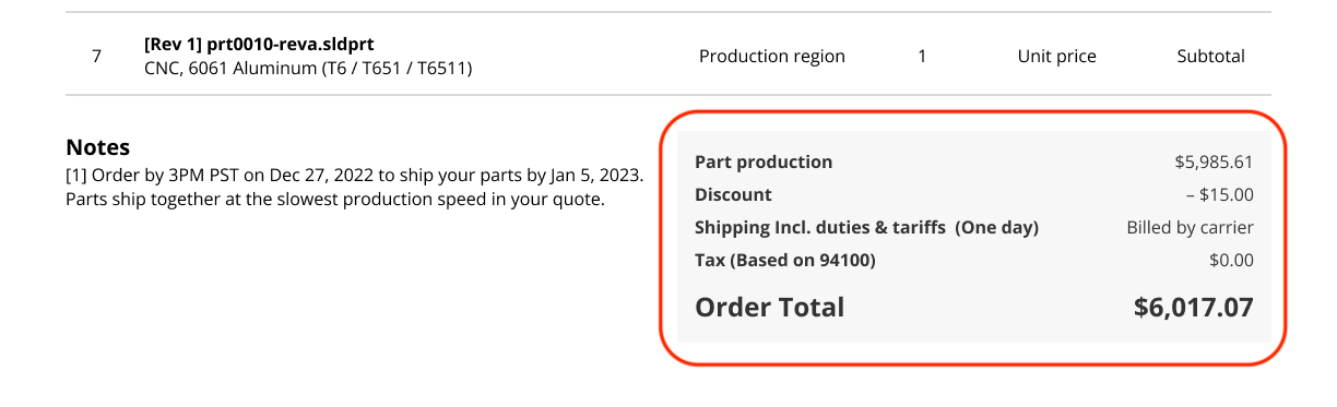

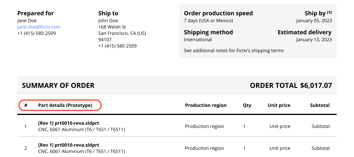

8. Review Your DDP Summary
During checkout, refer to the Summary card for a clear breakdown of shipping, tariffs, and duties—all included in the Order Total if DDP is selected.
Fictiv Order Summary PDF showing prototype part details.
Fictiv Order Summary PDF showing order total with tariffs included.
Note: Incoterms are not displayed on the quote PDF.

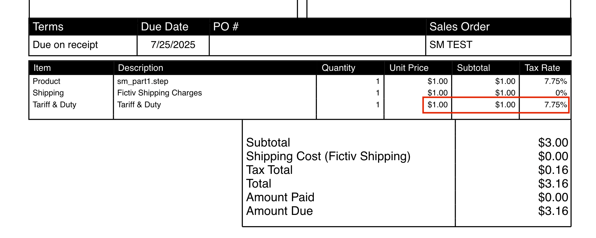

9. Review Customer Invoice Details
Customer invoices display pricing differently than the quote summary or PDF.
They include a breakdown of:
  • Tariffs and duties
  • Shipping costs
  • Taxes
This ensures full visibility for procurement and accounting teams.
Fictiv Customer Invoice.
