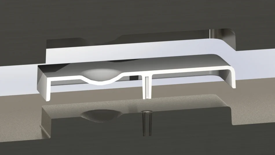

Why are edges so difficult? In the injection molding process, plastic is injected into a multi-part mold, cooled, and ejected. For a part to mold well, the plastic must be able to flow easily into the mold, and that’s the first reason that edges should be avoided: Plastic, even melted plastic, doesn’t flow easily, and filling edges requires higher pressure.
Also, when the part is released, edges often stick to the mold, so the defect risk is higher. These both increase cycle time and part cost.
Sharp external edges on a part increase complexity in mold making. Positive and negative space are reversed between the mold and your part: A post on the mold is a hole in the part; a convex hemisphere on the mold is a bowl on the part; and a sharp external edge on your part requires a sharp internal edge on the tool. Why is that a problem?

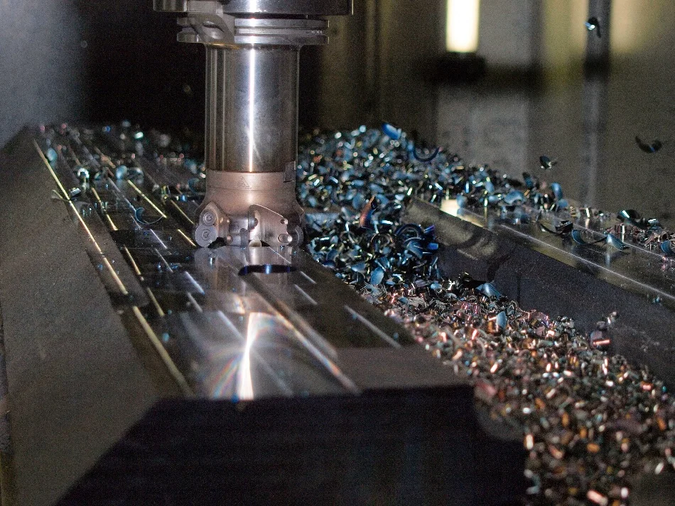

Think one step back: Before molding occurs, the mold must be made, and is typically machined of high-strength tool steel in two halves. The standard, easiest, fastest, and least expensive, method for making the mold components is to machine the parts using a CNC end mill, where a cutting tool rotating at high speed removes material from the block of steel to form the mold geometry.
Because a sharp corner on a bit wears away almost immediately upon contact with tool steel, endmill bits end up with very slightly radiused corners. Therefore, milling a sharp internal edge in steel is nearly impossible. That means that a sharp external edge on a molded part is also nearly impossible with standard machining. Does that mean there’s no solution?

Contrast that with the sharp edge in the lower-right corner (highlighted above in orange), where the mold tool would require one of the difficult-to-machine sharp internal edges. This edge should be radiused for easier machining with a CNC mill, unless absolutely required. And of course, if it is required, then plan on a slight increase in cost and lead time as the mold is machined on an EDM machine.
