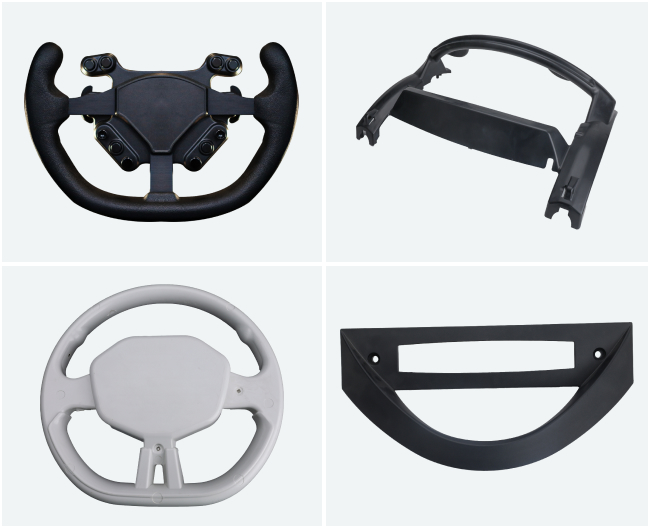

Examples of parts injection molded with gas assist

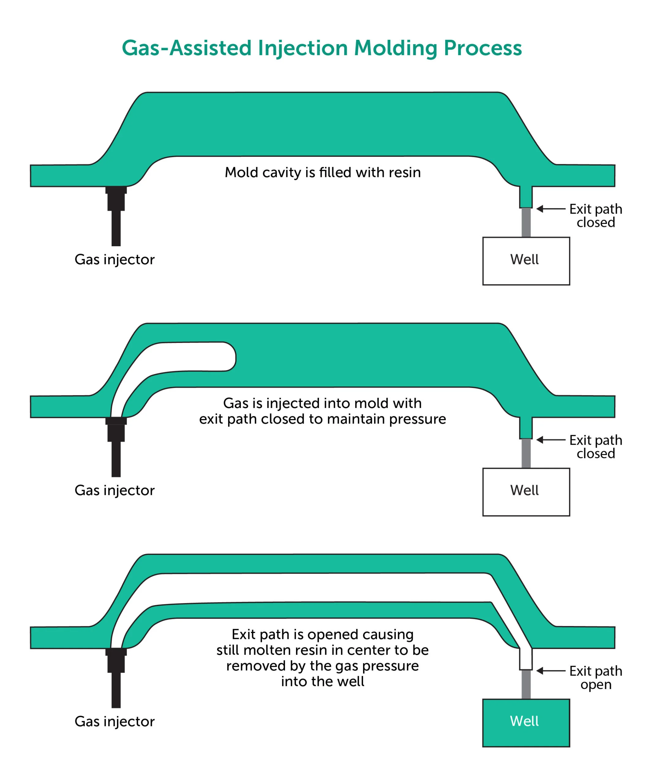

How Gas-Assisted Injection Molding Works
Gas-assisted injection molding begins by filling the mold cavity with molten thermoplastic up to 70–90% of capacity. An inert gas (usually nitrogen) is then injected through a nozzle or gas pin into the molten thermoplastic core. The gas displaces the thermoplastic, creating a hollow channel within the part that provides the additional volume required to ensure the mold cavity is filled. The gas pressure provides internal support while the plastic cools and solidifies. The gas is vented, the part is fully cooled, the mold is opened, and the part is ejected.
Key process parameters followed for gas-assisted molding:
  • Gas Injection Pressure: Usually between 2,000 and 4,500 psi, depending on the viscosity of the polymer and the wall thickness.
  • Timing: Gas should be introduced immediately once the fill is 70–90% complete; any delay can create incomplete channels.
  • Gas hold time: 5–10 seconds for packing pressure during cooling.
  • Penetration Depth: Controlled to 60–80% of the intended channel length to maintain channel stability.
  • Gas Channel Diameter: 4–12mm is common for medium-sized parts; smaller channels may block, while larger channels could collapse. However, channels for small and large parts can be designed to range from approximately 2–4 mm and 8–16 mm, respectively. In all cases, the ratio of gas channel thickness to the surrounding wall thickness should be in the range of 2:1 to 4:1.
  • Melt Temperature: Ensure temperature allows good flowability; a melt that is too cool will solidify prematurely.
