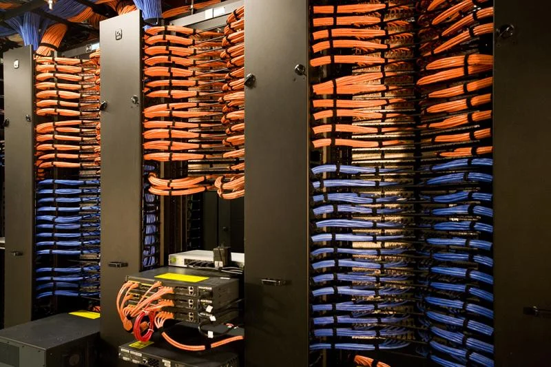

well-routed cables
Well routed cables have their own beauty Go Broncos image source

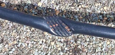

Pinched wires

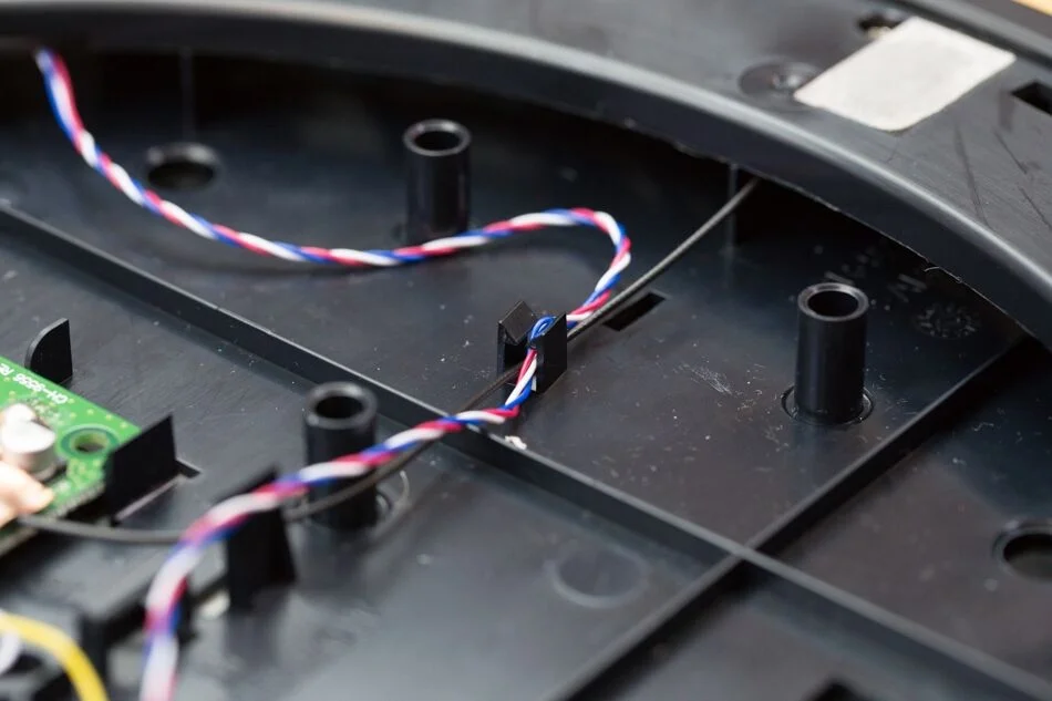

Think about how the components will move and potential strain on the wires (image from Fictiv teardown of the Anki robot)

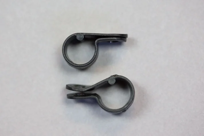

Cable Guide Clips
Cable guide clips are easy to use and cheap, and will guide your wires and cables without causing any pinching. For many projects, these guides provide what you need in the case design and only require that you pay attention to the location of the boss for the screw inside the case. While functional, guide clips are not exactly beautiful, and the additional components add cost and time to assemble.
cable wire guide clips

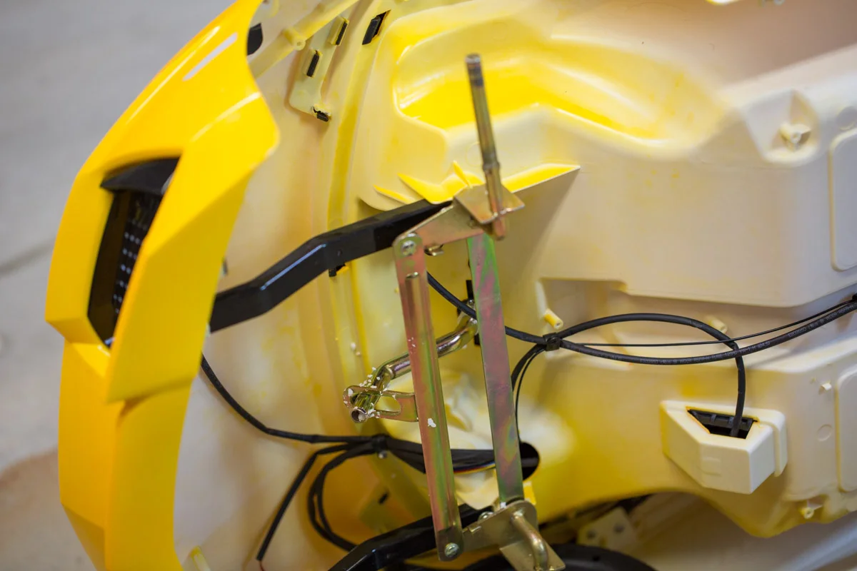

Clips are inexpensive and easy to use but can cost assembly time and simplicity images from our Lambo teardown
While you can design your own cable guide clips, options are probably already available for your specific application — so focusing on other design aspects is a better use of your time.

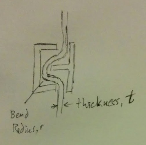

Strain Relief Wire Guides

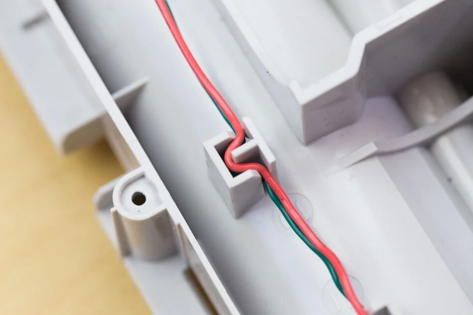

With many wire guides, strain relief is a major requirement, so it’s a good idea to include a strain-relieving wire guide as the first wire guide point after a connector. The most common strain-relief wire guide creates a double bend, pinching the wire between a post and a horseshoe to create slack at one end, even when there’s tension on the other.
horseshoe and post strain relieving wire guide
The horseshoe and post strain relieving wire guide
The strain relief wire guide design requires a balance between:
  1. Not bending the wire too tightly, which can create its own strain, AND
  2. Creating sufficient friction between the two parts to ensure that the wire won’t slip under tension
For repeated wire bending, you’ll need to limit the bend radius to at least eight times the wire thickness. A minimum bend radius of the wire diameter will generally be sufficient in a design where the wire will only be bent once.
As long as the minimum bend radius is greater than the thickness, you’ll be fine—for at least one bend.
As long as the minimum bend radius is greater than the thickness youll be finefor at least one bend
The second critical design consideration is creating sufficient friction to keep the wire in position. Formulas are simple but always require complex interaction between materials — the rule is that the tighter the bends in the wire, the more force it can handle without slipping. Since this cuts directly against our first goal of minimizing strain, best practice is to use the minimum bend radius (one wire thickness) in your design where possible.

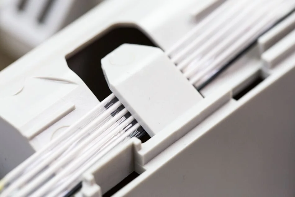

Snap-In Wire Guides
Ideally, assembly should be as easy as a snap of a finger (groan), and snap-in wire guides have the easiest assembly of any wire guides. No screws or other hardware, no heating, no careful bending, just push the wire through, and it remains fixed.
snap-in wire guides
Snap in guides are effective and ease assembly while minimizing part count
Snap-in guide design is simple, too. Snap-in guide design, particularly in the context of cantilever snap fit, is straightforward. A snap in this design is essentially a cantilever beam, where the desired deflection matches the depth of the snap. At this level of deflection, it’s important that the maximum strain does not exceed the plastic deformation limit of the material. These critical values can be determined using this simple formula:
