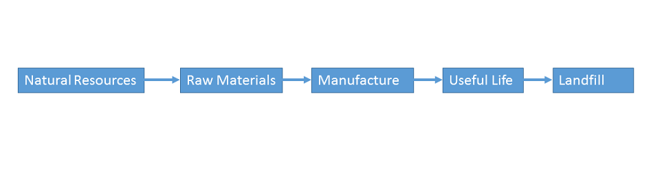

Since the 1950s, when electronics and plastics were becoming common consumer products, we’ve used a linear lifecycle plan for new designs: natural resources to raw materials to manufactured products to consumer use to landfill. But isn’t there a better way? Of course!

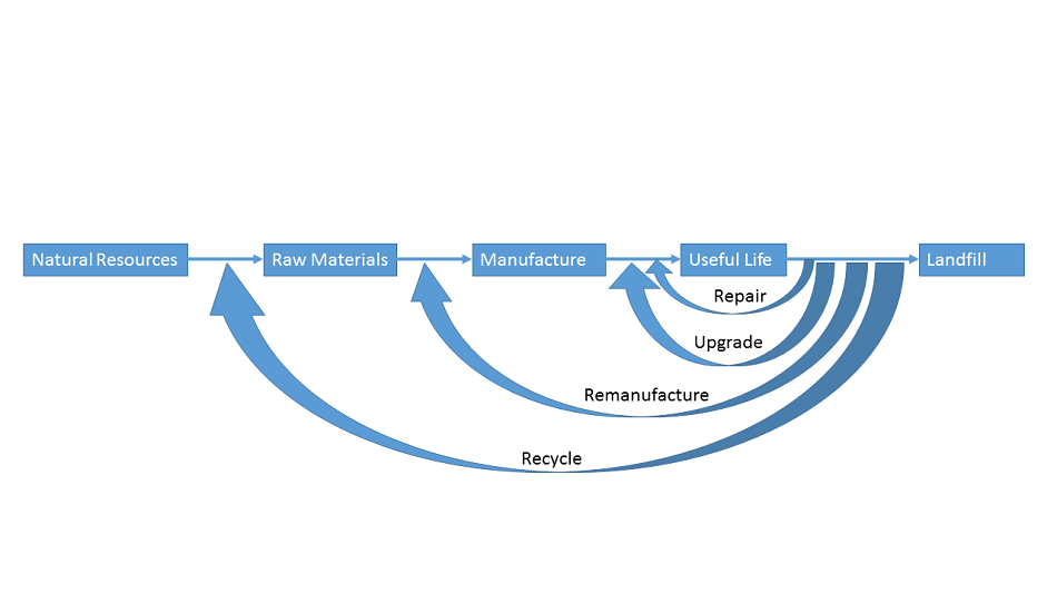

Instead of thinking linearly, with design for disassembly, we open up possibilities to extend usable life—and to shorten the loop on recycling—without breaking down components into raw materials to become useful again. Hardware designs often use valuable components that can be repaired, upgraded, reused in new products or, at the end of life, recycled to save natural resources. For any of these potential redemptions of hardware, an important aspect of the design is that it be easily taken apart. In other words: Design hardware for disassembly, to extend its life.

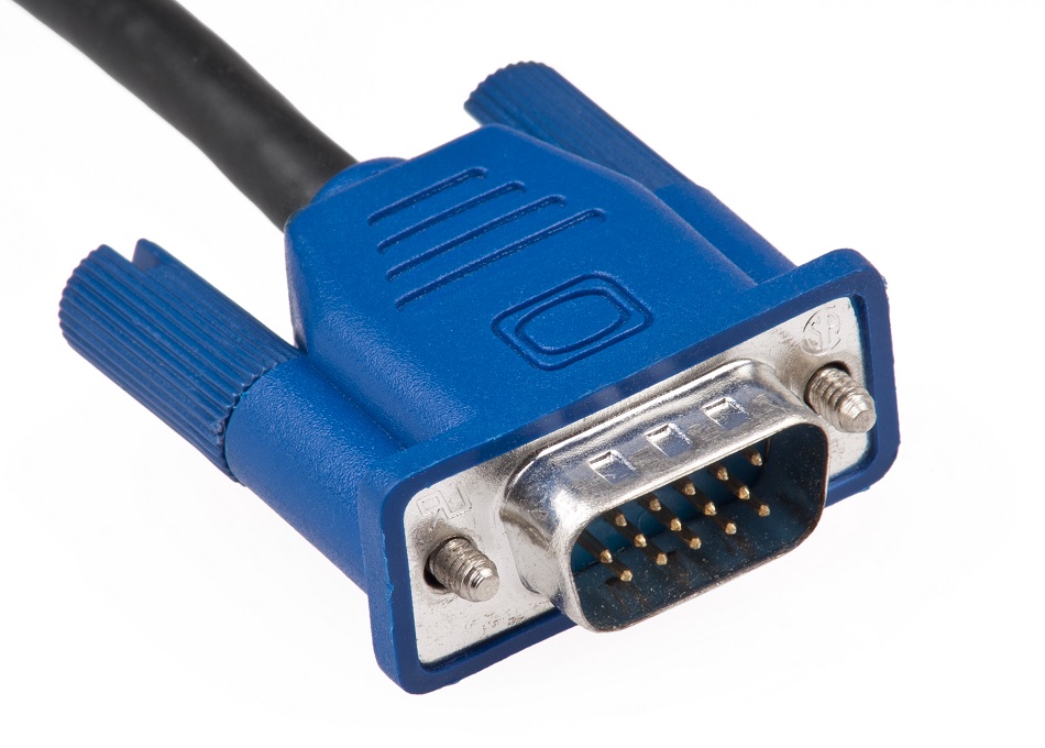

Also important: standard connectors. Think about the 15-pin VGA connectors still used to connect monitors or projectors to computers: They were common in the late 1980s and are still used frequently in industrial equipment, allowing for thirty years of easily interchangeable components.

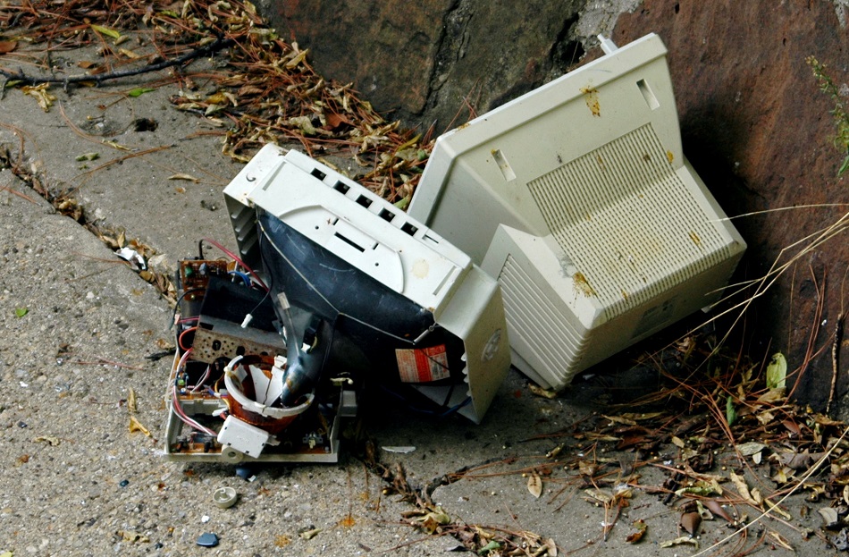

When a product can no longer practically be repaired, upgraded or remanufactured, the lifecycle has come to an end. However, there’s no reason for hardware designs to end up in a landfill: All hardware has costly raw materials just waiting to be reused. But how do you access those materials? Design for disassembly, of course.
One of the biggest hindrances to material recovery is that materials are mixed together. Aluminum and plastic are both easily recyclable separately; when bonded together, they both become waste. Ensure different types of recyclable materials are easily disassembled from each other and that each is clearly labeled for recycling.
