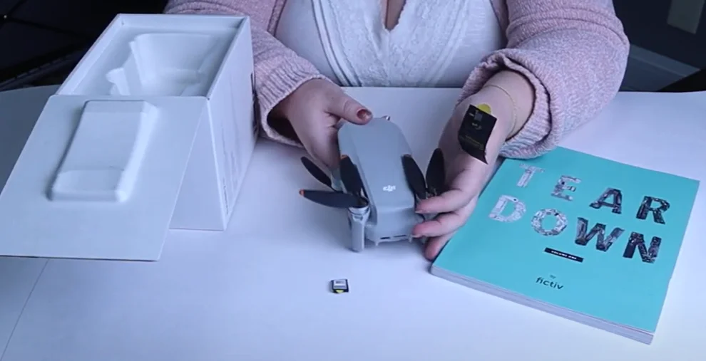

Unboxing Experience
I felt it prudent to talk about the unboxing experience as the packaging for this drone is so well thought out and intuitive. I remember when, a decade + ago, sleek packaging like this was reserved only for cell phones and the like. But, now that our manufacturing capabilities have expanded, higher quality packaging, with some eco-friendly elements to boot. I am a sucker for renewable resource utilization, and DJI hit the nail on the head with their recyclable box and molded interior supports for the drone and remote control.

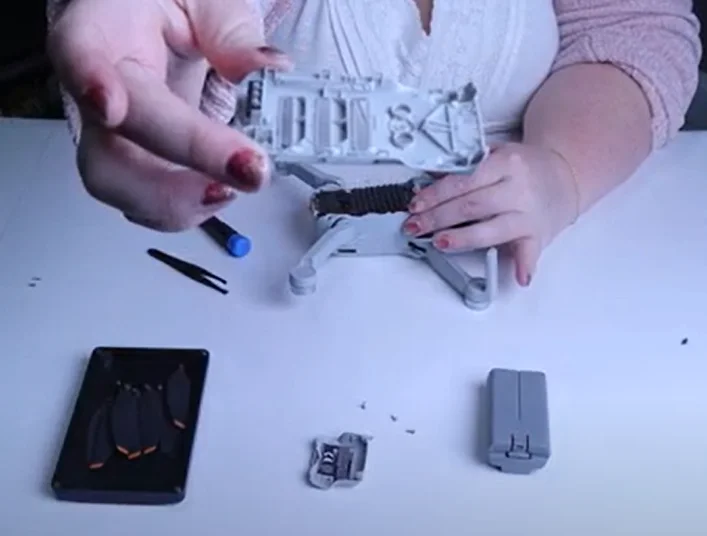

Removal of Top Enclosure
![](https://www.fictiv.com/wp-content/uploads/2023/12/image10-jpg.webp)
The top enclosure removal is what I did next. It required tons of patience because of all the snap fits within it that I couldn’t see. For the next teardown, I am asking for a CT scan of the assembly first (Am I right?). The top enclosure was attached with several snap-fit locations and screws alongside hinge insert holes for the camera door. It’s a pretty complex and sturdy injection molded part. Here is the top enclosure, which is a single injection molded part.
![top electronics enclosure, single injection molded component](https://www.fictiv.com/wp-content/uploads/2023/12/image6-jpg.webp)
I also recognized the copper conductive tape near the midsection of the enclosure because it reminded me of my days using copper conductive tape to calibrate a scanning electron microscope. A good blast from the past!
I also want to point out that here is where I started noticing some intuitive and intelligent vibration dampeners throughout the drone assembly, some of which I haven’t seen before. I’m not exactly sure what the materials are, but some had pretty intricate designs that I could tell were specific to this application. Another brownie point for the engineers at DJI.

Drone Arm Disassembly
I disassembled the drone arms more or less throughout the teardown, so that’s why it’s our last section here. Each drone arm consists of one screw attaching to the main body and three screws under a foam pad, connecting each arm to a bearing on the propeller blades. At the attachment of the drone to the drone body is also a likely sheet metal or CNC machined bracket and cylinder/shaft assembly where the wires feed through on two of the drone arms and around on the other two drone arms. Within each bearing assembly are copper windings and three cables that feed into the windings, likely to turn the bearing and the propeller blades.
