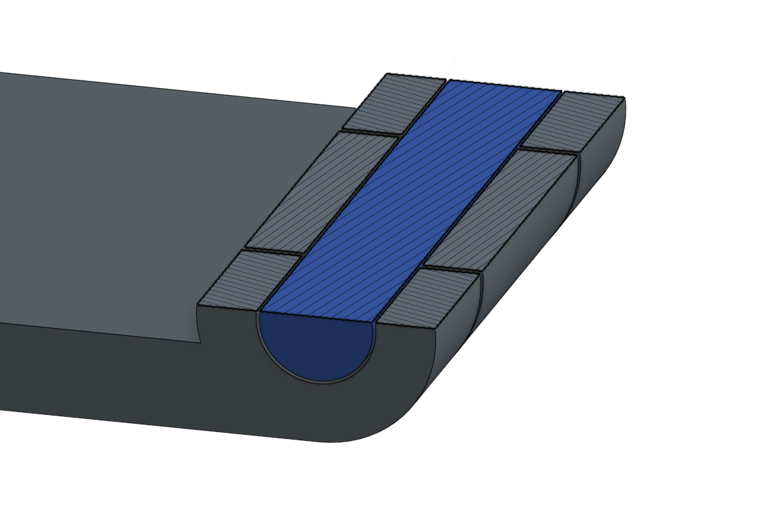

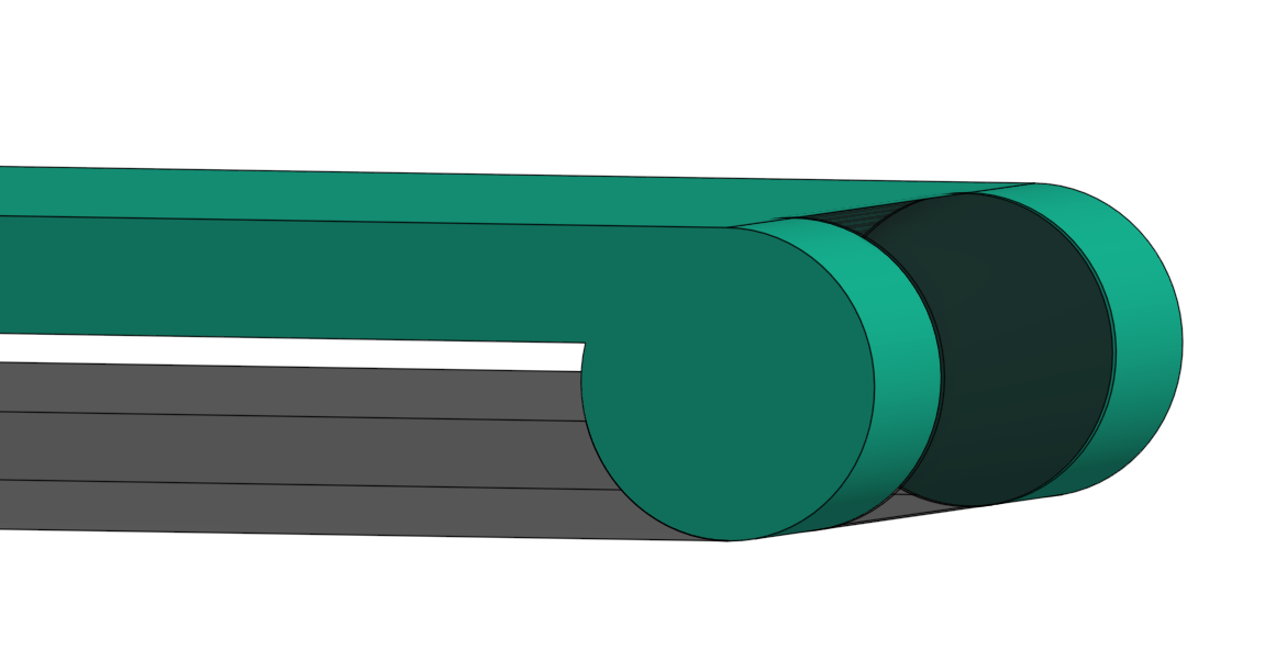

Splitting the Master Part Into Hinge Components
One of the first challenges in hinge development is determining how to split the master part in CAD for optimal functionality, molding, and assembly. For my hinge design, this meant separating the pin from the mating parts of the bore so that each part can be tooled and molded without undercuts or complex slides.
Taking a look at the design, you can see how I split the three parts to confine them along the horizontal axis, while allowing rotation about that axis.
Hinge split shown in CAD

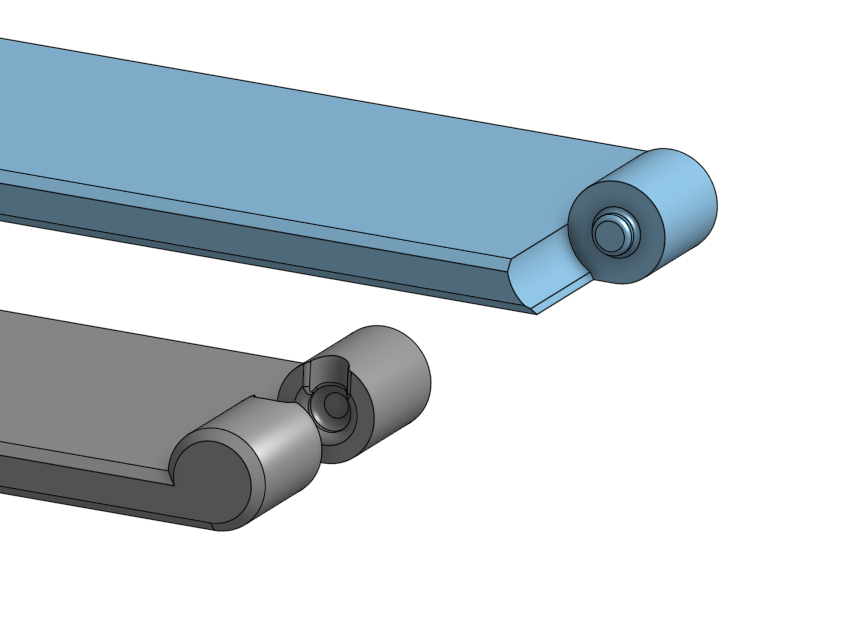

Overall Hinge Diameter
I started this model with a middle plane to mirror the main parts with symmetry, which would also act as the midpoint of the hinge. I used a circular sketch tangent to the front face, with the center point coincident with this plane, as a driving component for this section. Adjusting its diameter to account for the wall thickness necessary also drove the overall thickness of the collapsed assembly.
Inner and Outer Hinge Section
I then had to extrude the overall hinge section and split the main front and back parts so that the back included an inner cylinder and the front included outer bosses to constrain it. Depending on your modeling preference, this can be done with offset surfaces or sketch-driven extrusions. I included offsets from the driving sketches to create the necessary clearance.
Hinge Pin Integration
The boss for the hinge has been split, but I needed to integrate the bore to hold the pin in place. I did this by coring out both parts with another offset circular extruded cut. Then I added two more recessed cuts for the head of the pin and the snap feature on the other side. This allowed me a nice slot to model in the pin itself.

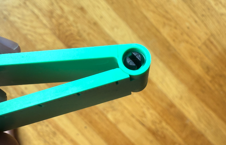

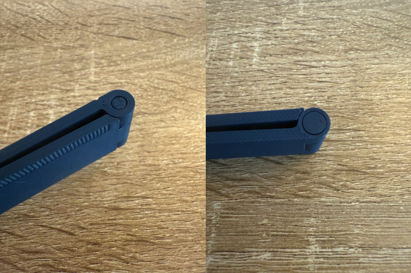

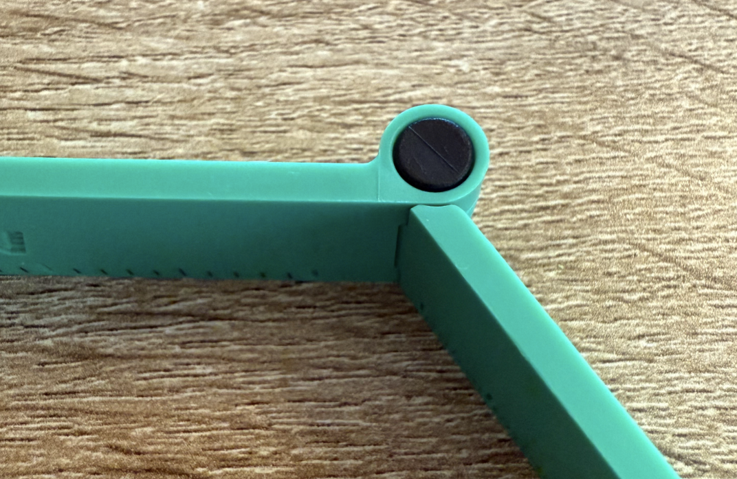

Prototyping the Hinge With 3D Printing
To test out the concept, I started with 3D printing. I designed a simple, flanged pin with a slight press fit that was just enough to hold it in place. This was relatively straightforward to accomplish, thanks to a quick tolerance stack analysis based on the resolution of the 3D-printed parts.
Initial hinge cross-section for prototype
Tip: With similar designs, it’s essential to consider the type of fit you are aiming for and design it accordingly. Especially with metal parts—you will have slightly less flexibility than with plastic.
3D-printed prototype hinge

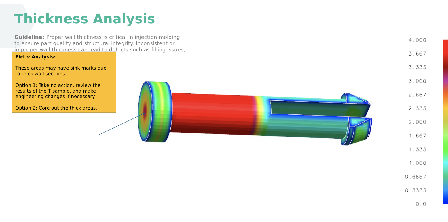

Coring and Flexibility

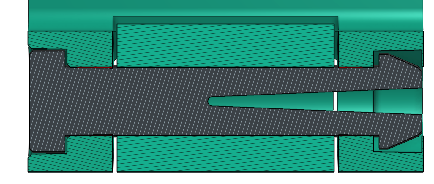

Snap-fit pins often require cored-out sections to provide flexibility during assembly and reduce the risk of sink in thicker sections. However, too much coring reduces rigidity and leads to premature loosening, as I discovered with my initial design.
DFM thickness analysis of hinge pin

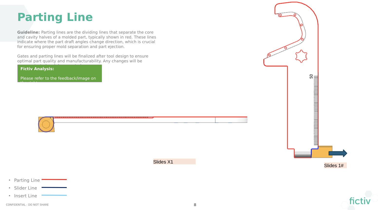

Parting Lines
In the design, I also had to consider the parting lines and draft, which affected the fit and clearance. Because the hole for the pin had to be pulled on a slide (in a perpendicular direction to the mold core and cavity), there had to be a break in the draft at the parting line.
DFM parting line and slides for hinge

When the T1 samples arrived, the hinge rotated and the pin could be easily assembled, but the fit was too loose. The pin could be flexed open and even disassembled without excessive force. Functionality was not up to par, and the product quality felt compromised.
Working with Alex Fu, TPM at our manufacturing partner in China, we reviewed options:
  • Tool Modification: Removing steel to add plastic material on the pin and back components to close the clearance gap between mating parts.
  • Pin Redesign: Adding material for structural reinforcement to the snap feature to reduce flex. This had to be done strategically to add rigidity in consideration of moldability and defect concerns such as sink.
  • Material Adjustment: Considering a resin with slightly higher stiffness for better retention. I did some calculations and FEA for the snap force, and we ended up going with glass-filled nylon as the new
These iterative refinements produced a hinge that not only functioned as intended but also conveyed a sense of durability and quality in the assembled product. This case shows the importance of anticipating adjustments and designing hinge features with modification paths in mind.

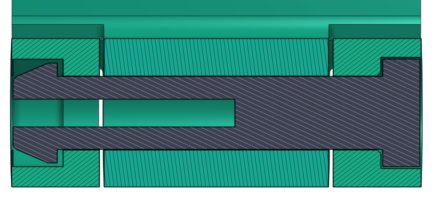

Let’s take a look at the hinge cross-section in the CAD snapshot below, showing the final clearances.
Hinge assembly cross-section in CAD
Cross section of hinge assembly in CAD
