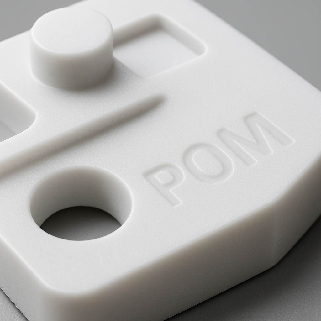

POM (polyoxymethylene), also known as acetal or the branded name Delrin®, is a high-strength engineering thermoplastic valued for its dimensional stability, ease of machining, lubricity, and excellent wear resistance. These characteristics make it a strong candidate for use in precision mechanical parts where low friction, reliability, and accuracy are essential.
In this article, we’re not talking about small dogs or pom-poms. We will explore POM’s most important physical and mechanical properties, its advantages and limitations, and how it compares with other engineering plastics, as well as key design considerations for engineers utilizing this polymer.
