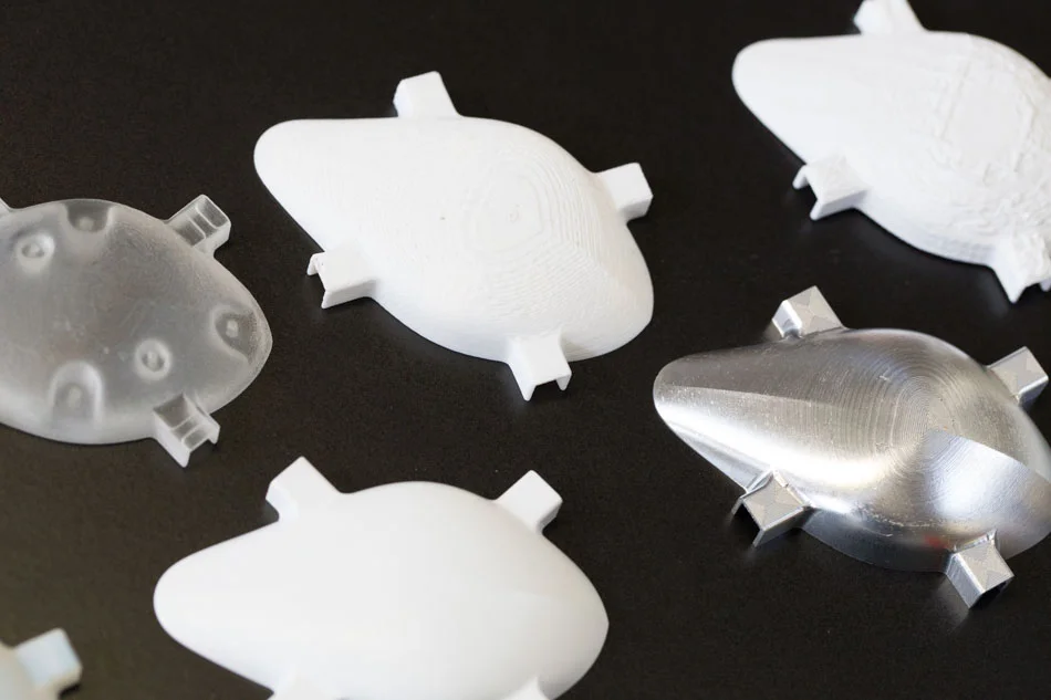

Prototyping and assembling parts helps give you validation along the way of the steps required for a manufacturer to make that part at increasing fidelity, which helps bridge the gap between design and manufacturing.
Some mechanical engineers get what I call CADitis (I have been a victim): When you’re designing parts in CAD, you can zoom in and out, but as you’re working, you can lose your sense of how your design will work in reality. 3D printing is really useful because you can print a few designs and see what size they really are. Sometimes, you have to circle back to your engineering equations (bending stress, moments of inertia, etc.). I now have a pair of calipers at my desk to spot-check my reality (i.e., this belt looks more like a rubber band…I wonder if it can actually hold the load).

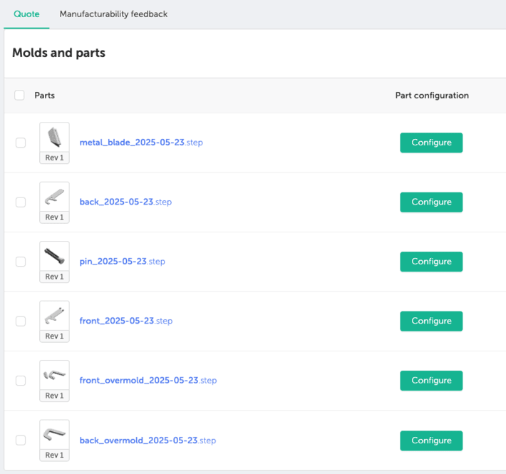

I talked about some of the ways you can use 3D printing to prototype and do initial reviews, but you can also use Fictiv for CNC DFM to understand part limitations. You might learn that something can be done if you add certain processes that might be more expensive. You might learn that it can’t be made or that it must be made with a 5-axis. You might get insight into random features you’re unsure about.
Fictiv can help with design experimentation. If you’re unsure about something, make three versions of the part and test them. Fictiv can also help provide parts for testing, when you’re evaluating materials selection, surface finish options—everything that contributes to your design and prototype performance.
