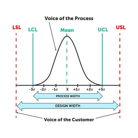

“Sigma” (σ) is the statistical symbol for standard deviation, or how much a process varies from its target. Six sigma means the process average is at least six standard deviations from the nearest specification limit, making the defects extremely rare. In practice, this equates to fewer than 3.4 defects per million opportunities (DPMO), with a failure rate of only 0.00034%, assuming a 1.5 sigma shift in the mean (a standard convention in Six Sigma).

Process width and design width

Control Charts (SPC / IMR)Track process variation over time against control limits.

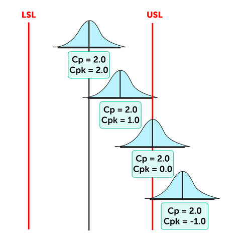

Cp / CpkProcess capability indices: Cp measures potential capability, while Cpk shows actual performance while accounting for centering.

Cp and Cpk values shown within process limits
Learn how to design for variance within control limits by reading Tolerance Stack Ups 501
