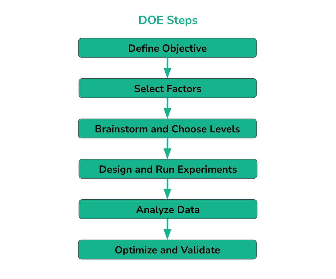

Design of experiments (DOE) steps.
Design of experiments DOE steps

The DOE Process: Step by Step
DOE provides a structured path from experimental planning to validated results:
  1. Define Objective: Identify the problem (minimize warpage in molded part)
  2. Select Factors: Choose input variables (wall thickness, gate location, melt temperature)
  3. Choose Levels: Assign settings (low, medium, high pressure)
  4. Design Experiment: Plan test matrix (RSM or 3-level factorial design)
  5. Run Experiments: Execute plan (run 8 trials per matrix)
  6. Analyze Data: Use statistical tools (ANOVA, main effects plot)
  7. Optimize/Validate: Implement best settings (reduce defects by 30%)

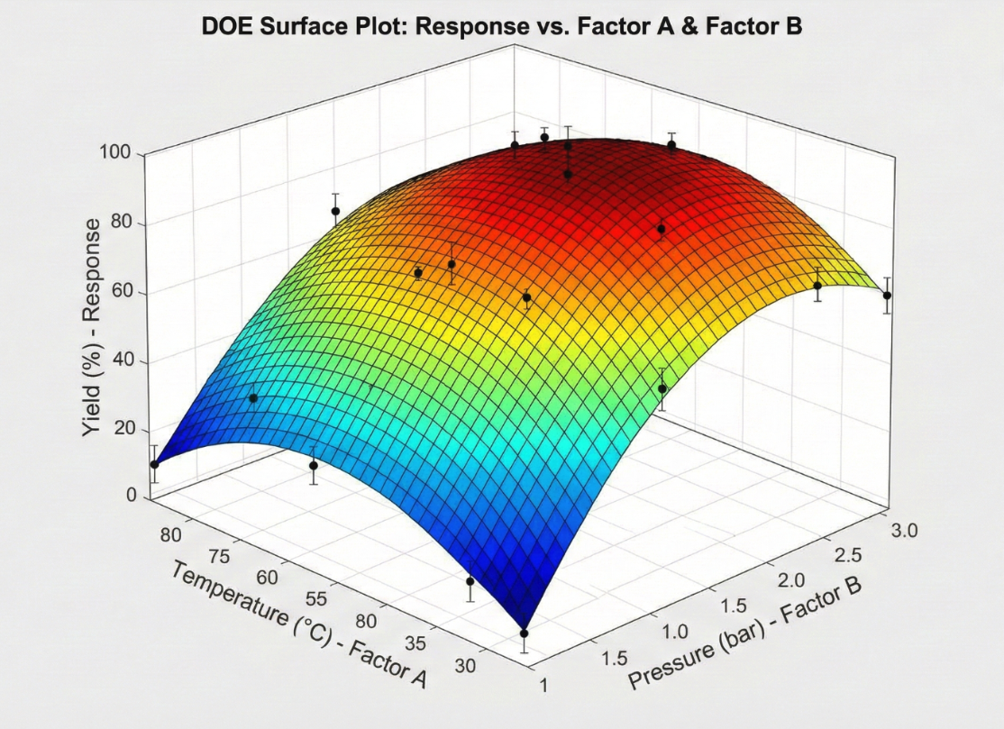

Visualization with Contour and Response Surface Plots
DOE analysis expands experimental insight by combining the effects of two or more factors on the response using contour plots and response surface plots. These plots are particularly valuable for optimization since they identify trends, ridges, and trade-offs that may not be apparent from tables alone.
In the DMADV and DMAIC Improve phases of Six Sigma, response surfaces allow engineers to find developing ranges rather than individual solutions, enabling the creation of more robust designs that meet performance targets while minimizing sensitivity to noise in mechanical processes.
Surface plot based on data points from design of experiments (DOE).
Surface plot based on data points from design of experiments DOE

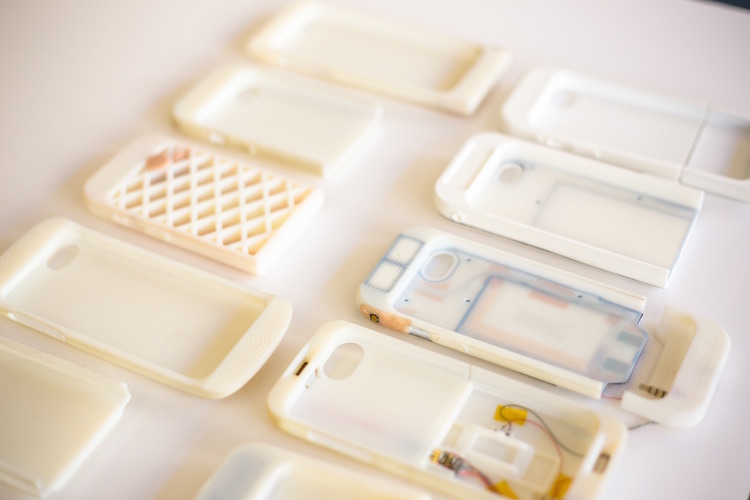

Prototyping and Iteration Using Design of Experiments
DOE is especially valuable during prototyping, where engineers can evaluate multiple design and process variations in parallel rather than relying on sequential trial-and-error builds. By planning prototype runs that intentionally vary key design parameters or manufacturing inputs, teams can generate meaningful performance data from a single iteration.
In CNC machining, this might include testing dimensional tolerances, surface finishes, or machining parameters across multiple parts in one batch. In injection molding, DOE-based prototyping can assess combinations of gate location, wall thickness, material selection, and processing conditions within a structured experimental plan. In 3D printing, this may mean creating multiple form factors for a user experience study.
3D-printed prototypes for testing with design of experiments.
3D printed prototypes for testing with design of experiments
This parallel approach to prototyping reduces development time while improving the quality of design decisions. Rather than converging slowly on a solution, DOE helps engineers identify which factors truly influence performance and define acceptable design windows early in the development process. When combined with rapid manufacturing, DOE-driven prototyping enables faster learning, fewer prototype cycles, and greater confidence before transitioning to production.
