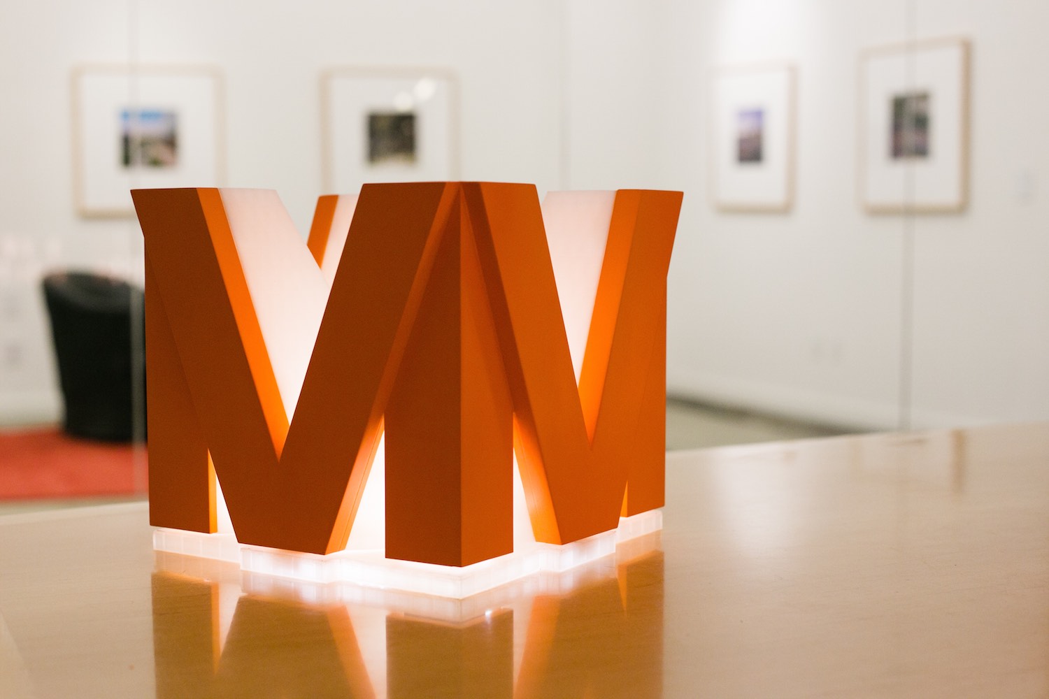

Mark: This was a really fun project because it’s a great logo to work with. So my first thoughts were all around how I could manipulate the form of the logo into something that had a bit of magic in it. For every job I have an initial mental concept and for this one I had this image of some sort of glowing orb. A centerpiece that would be interesting to talk about. With everything I do I want there to be something indescribable about the product; a touch of magic in the experience. A little bit of surprise is a good goal for every project.
Dave: Mark did such a great job arriving at the initial concept for the product. All we gave him was a 2D logo and then he came up with this idea for a table centerpiece that used the logo and had this magical glow to it. Our company saying is “Fictiv, created by imagination” and I’m continually inspired by people like Mark who can create something amazing out of nothing.

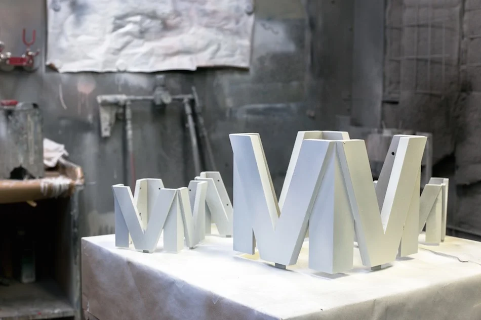

Mark: Initially we started building it up digitally and then including more practical considerations. Under the considerations of cost and a small-scale manufacturing system, Dave and I decided that laser cutting the majority of the body would be a great cost-effective way to approach it. So I started separating the M logo into multiple faces that were laser-cuttable to create the outside frame. For all the smaller details, thank god for 3D printing. It’s so quick and cost effective and the outcome was great.

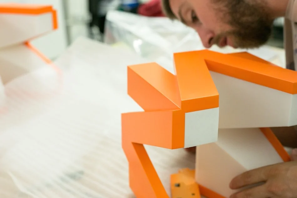

Mark: Repeatability was certainly a big issue. It’s very much a hand-crafted, sculptural piece, but it is still a manufactured piece.

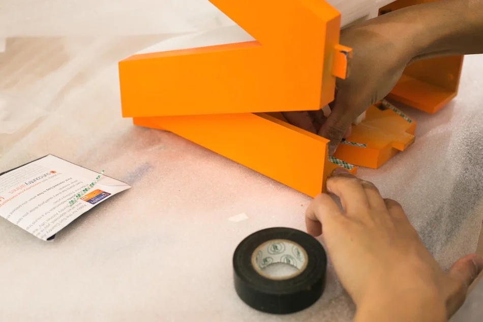

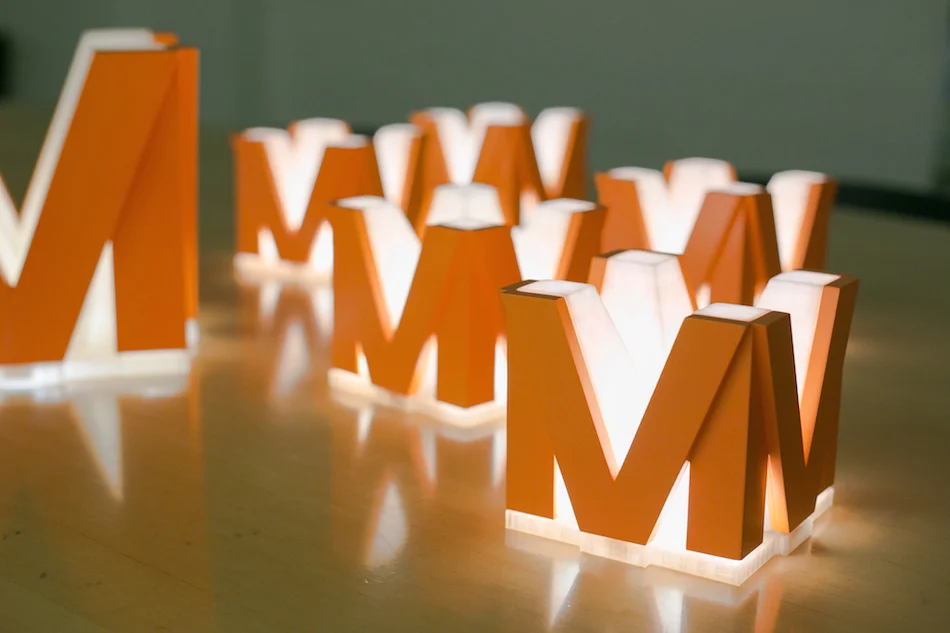

Dave: We ended up doing 16 of these which made it even more challenging because with one piece you can make it non-scalable and just hack the thing together. But by making 16 of them we had to essentially make a mini-manufacturing line that could be repeatable so all 16 pieces look the same. We had to hand build these things in a very systematic way which was why laser cutting the frame and 3D printing the smaller internal parts made sense.
“For all the smaller details, thank goodness for 3D printing.”
Dave: We made 2D laser cut panels which we welded together. We then made a frame which is the M and painted that in the orange color Menlo Ventures wanted. We used a silver-based paint to keep the light from shining through the inside so the light is nicely reflected. We then printed all the inside white pieces in PLA, which is a great inexpensive material, and then assembled the whole thing using locator pins and adhesive with custom-made electronics.
