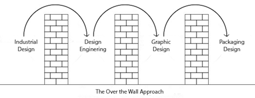

Over The Wall Engineering (The Old Way of Thinking)
![Sequential engineering approach diagram](https://www.fictiv.com/wp-content/uploads/2020/07/concurrent-engineering-image1.jpg)
Over the Wall Engineering came about after the industrial revolution, with the introduction of the assembly line and task specialization. In the over the wall engineering approach to product design, each team member performs his or her tasks and then passes that collateral on to the next team member. The term “over the wall approach” came about because each person’s work is handed over the hypothetical (or actual) cubicle wall to the next person. This methodology relies on tasks being performed sequentially and with very little need for communication or collaboration.
The primary advantage of this method is that it makes a highly complex project easy to understand and track. This method also makes it easy to identify underperformers. For this method to work as intended, each person has to be given all of the right deliverables and/or specifications from the previous person AND perform his/her task exactly as required, before passing the work on to the next person.
Of course, things don’t always go as planned, and issues arise. When an issue does come up, the work has to be passed backward over the wall, fixed, and then sent forward over the wall again. This is called reverse flow and is a major source of this method’s inefficiency.

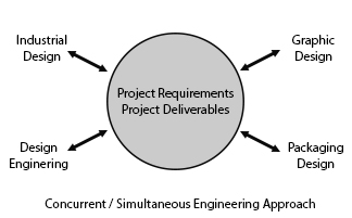

Concurrent Engineering Approach (The New Way of Thinking)
![Concurrent Engineering Approach](https://www.fictiv.com/wp-content/uploads/2020/07/concurrent-engineering-image02.jpg)
In the concurrent engineering approach, also called the simultaneous engineering approach, team members from different job functions collaborate early and often. In this approach, there are no “walls,” and everyone works together. The general idea behind this approach is that by collaborating, team members can identify and solve issues early on AND can create efficiency by having different team members working on tasks at the same time.

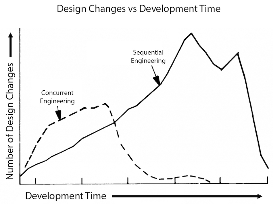

Iterations Take Place EARLIER
The graph below compares the development time of each approach as it relates to the number of design changes. As mentioned earlier, the concurrent engineering approach is intended to identify and solve issues early on. You can see this in the graph, where concurrent engineering undergoes many more design changes at the early stages of development than sequential engineering. In contrast, sequential engineering undergoes the most number of design changes pretty late in the game. These late stage design changes tend to have the greatest effect on a project’s timeline.

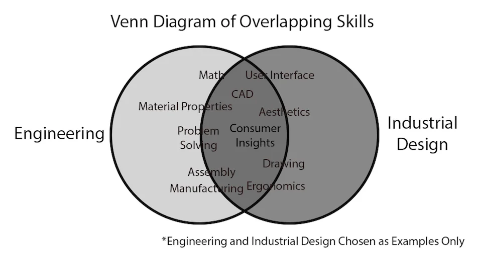

More Creative Solutions
Concurrent engineering yields more creative solutions because more people have the opportunity to identify, review, and solve a given problem together. Don’t forget that team members likely have overlapping skills. Just because someone’s title is industrial designer doesn’t mean that he/she isn’t skilled in mechanical design or doesn’t have an intimate knowledge of manufacturing processes. Conversely, an engineer might have a great eye for aesthetics and form. The Venn Diagram below shows a few examples of overlapping skills between an industrial designer and a design engineer.
![Venn diagram of industrial designers' and design engineers' overlapping skills](https://www.fictiv.com/wp-content/uploads/2020/07/concurrent-engineering-image04.jpg)
As mentioned earlier, there is likely a specific team member in charge of solving a particular problem because of his/her specialty, but the issue is visible to all team members. Therefore, valuable input can be provided by anyone.
