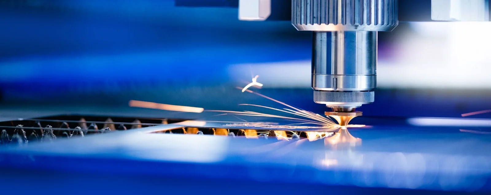

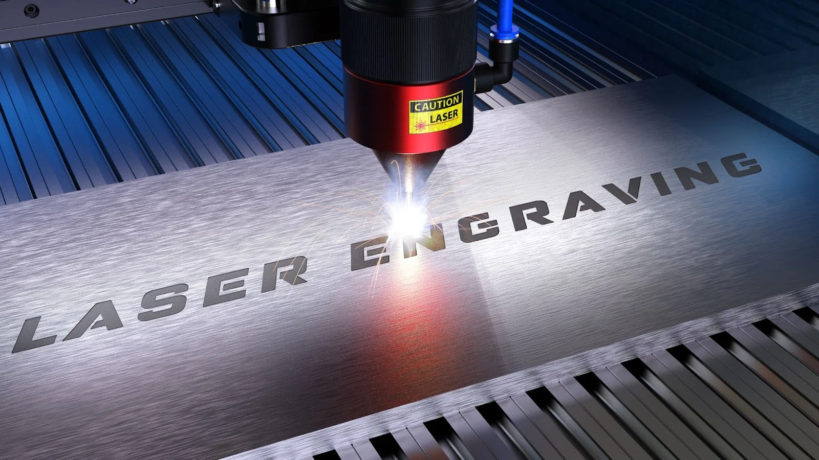

Laser Engraving
Laser engraving is the most flashy and expensive engraving method. Whereas laser etching melts the material to change its roughness, laser engraving sublimates and removes material from the surface.
On a microscopic level, laser engraving works by superheating the metal to its vaporization temperature. That’s right, the lasers literally vaporize metal. That temperature is around 1000-3000℃ for most metals, and must be reached within a few milliseconds to be successful and repeatable.
The metal that the laser makes contact with must change directly from a solid to a gas without becoming a liquid — molten metal would re-solidify and disrupt the shape being engraved. As the metal is vaporized, it becomes fumes and is extracted from the area.
While the cost of laser engraving is significant, the part marking will never fade or wear because of its depth. Laser engraving can also be utilized to engrave hard materials that are otherwise difficult to engrave mechanically. Most laser engraving is performed with CNC laser engraving machines.
