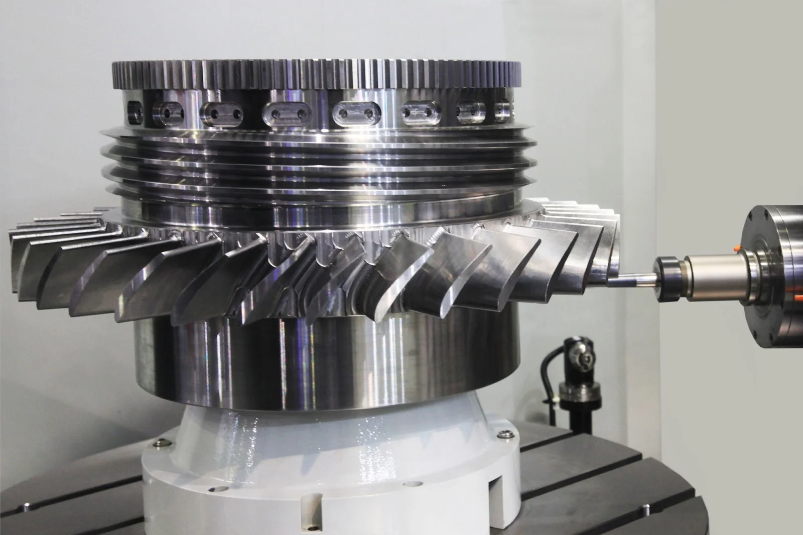

Complex custom CNC machining in action
Part Complexity
One of the most impactful factors to consider for the CNC machining price is part complexity. CNC machining complex parts is expensive because the cost of machining is directly proportional to the complexity of the design — the more complex a part, the longer it takes to machine. And remember, you have to pay for setup time, the number of setups, programming time, and machining time. It adds up quickly.
One way to cut costs related to part complexity is to ensure you follow all Design for Manufacturability (DFM) feedback. When designing parts for CNC machining, it’s best to do so with your chosen manufacturing techniques and capabilities in mind.
For example, moving a feature to another side of the part so that you only need one setup (instead of 2) for a machining operation. Or maybe you can machine the part on a 6-axis machine — instead of a 3-axis machine — to increase throughput and reduce costs without sacrificing complexity. Whenever possible, limit the CNC machining to a few faces of the part to reduce CNC machining complexity as well.
Where you can, always look to reduce complexity by limiting the number of parts that you have to machine for an assembly. If possible design features within a single part to reduce CNC machining costs, instead of requiring CNC machining of several smaller components.

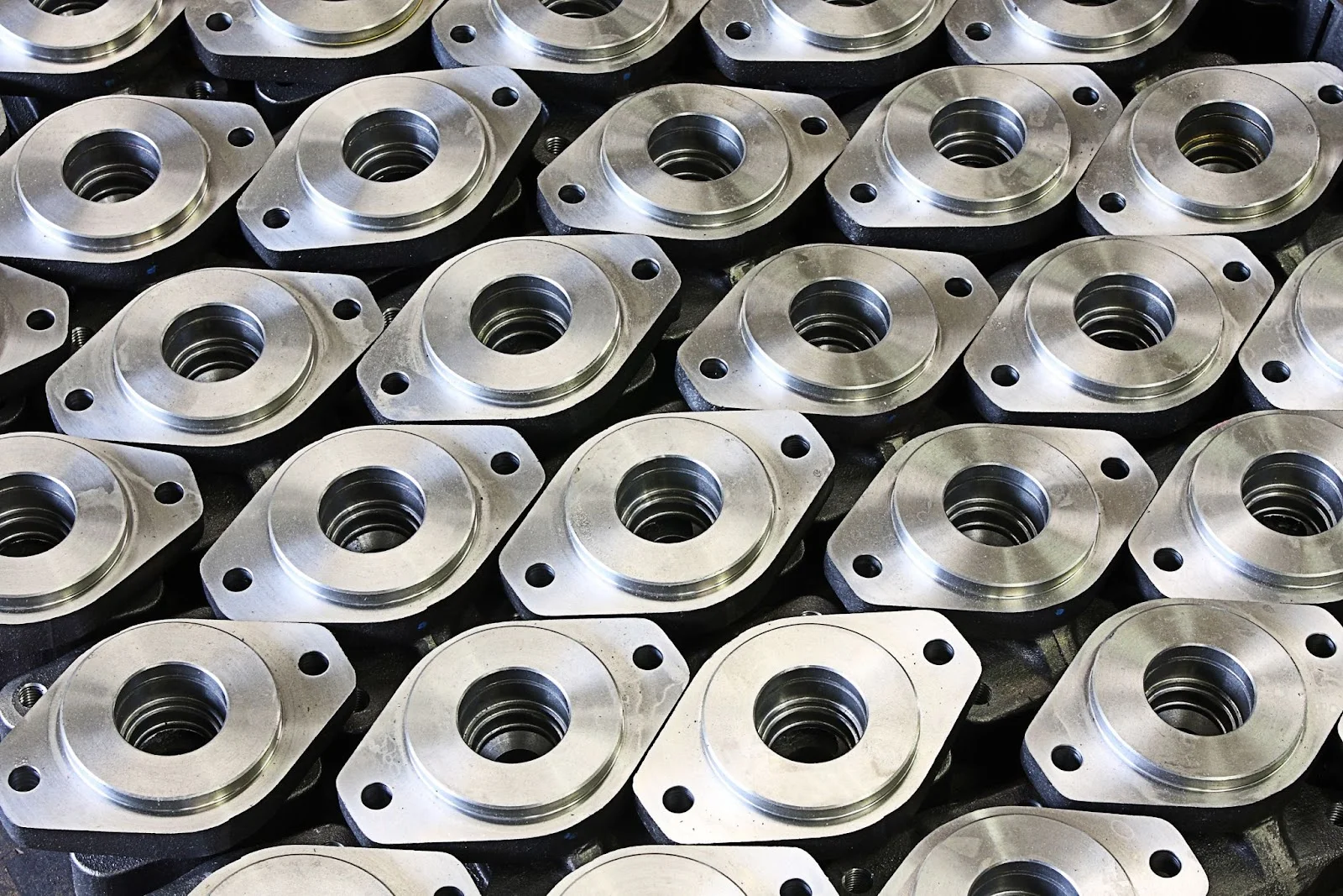

Larger order quantities can reduce CNC cost
Order Quantity – Prototype or Large Volume
Because setup and programming costs are significant for every new CNC machining job, smaller volume orders cost more per part than larger ones — typically, the higher the order quantity, the lower the price you pay per part. This maxim holds for repeat orders.
With traditional machining, you pay exorbitant amounts for prototypes or custom, one-off parts. But, with custom machining platforms like Fictiv, you can get prototypes made at reasonable prices and excellent leadtimes without sacrificing quality.
