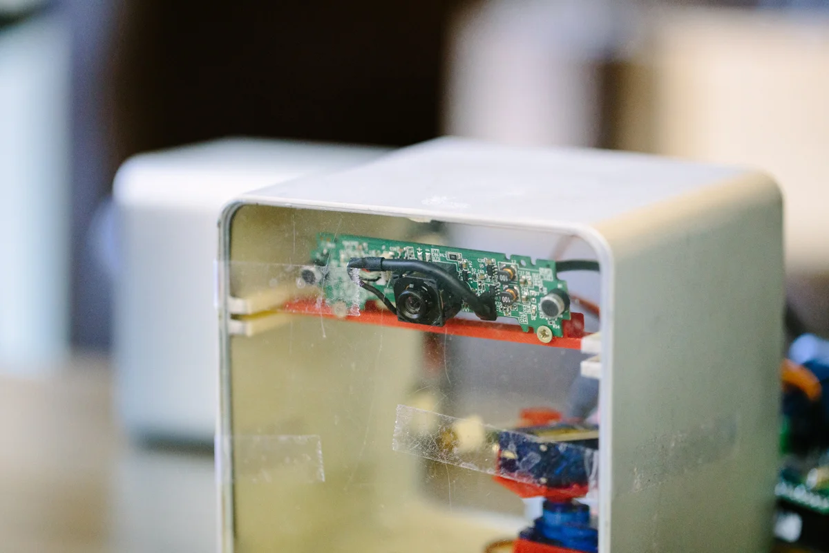

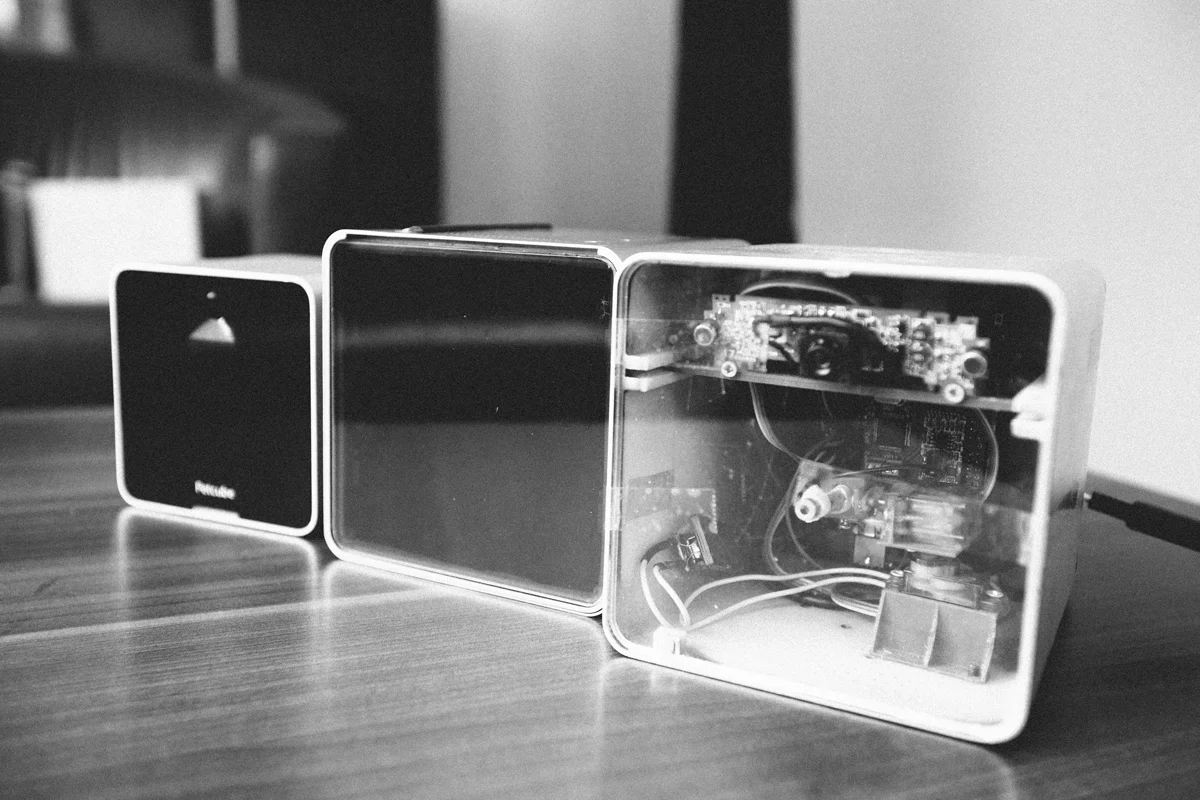

Test Everything
Before it was time to ship the product to the team’s Kickstarter backers, Alex had a strange dream. In the dream hundreds of Petcubes in palates on a ship at sea were caught in a violent storm, causing them to shake and ultimately be destroyed.
“I woke up from this dream and immediately thought, ‘I need to do a shaking test,’” Alex recalls. That same day he went to the factory and asked if a shaking test had been done. It had not. So he set one up and, low and behold, one of the mechanical parts was unstable.
From this point on Alex knew he would have to take the initiative to effectively test and analyze each of the products’ components.
Another test conducted was an aging test for which he placed the device in a fridge at a very low temperature, below -20 degrees Celsius, and also in a hot box with a temperature above 40 degrees Celsius. The device passed the cold test, but in the hot box the camera overheated and failed.
The only way to solve problems with your assembly line is to study the vulnerabilities and correct them gradually
