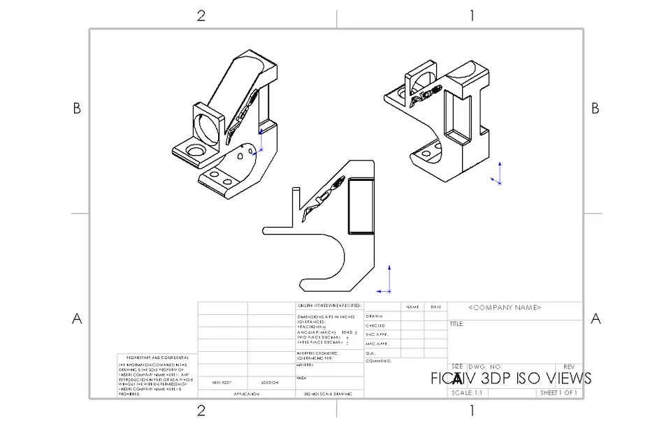

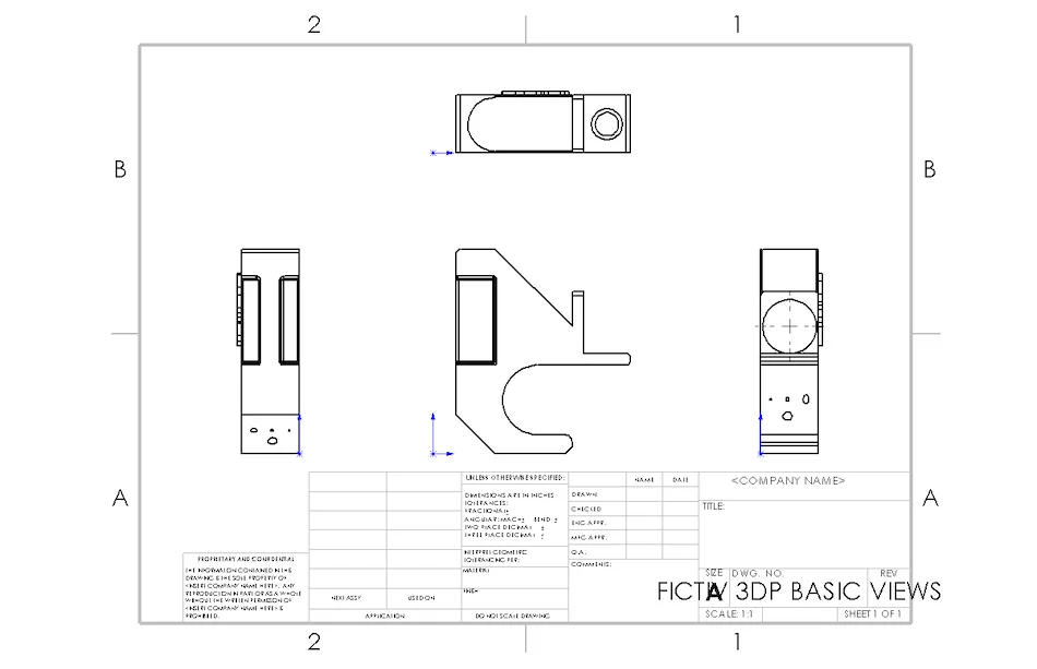

Introducing the Test Design
Engineering Drawing of 3D Printed Test Design
<em>Engineering Drawings of 3D Printed Test Design<em>
The 3D printed test design is meant to serve as a pencil/pen holder that can be easily attached to a desk’s edge. As a personal feature, the design can be branded with the user’s short nickname on the side. The design contains a variety of fillets, extrusion cuts, holes, and chamfers, which we will compare across both printing materials.

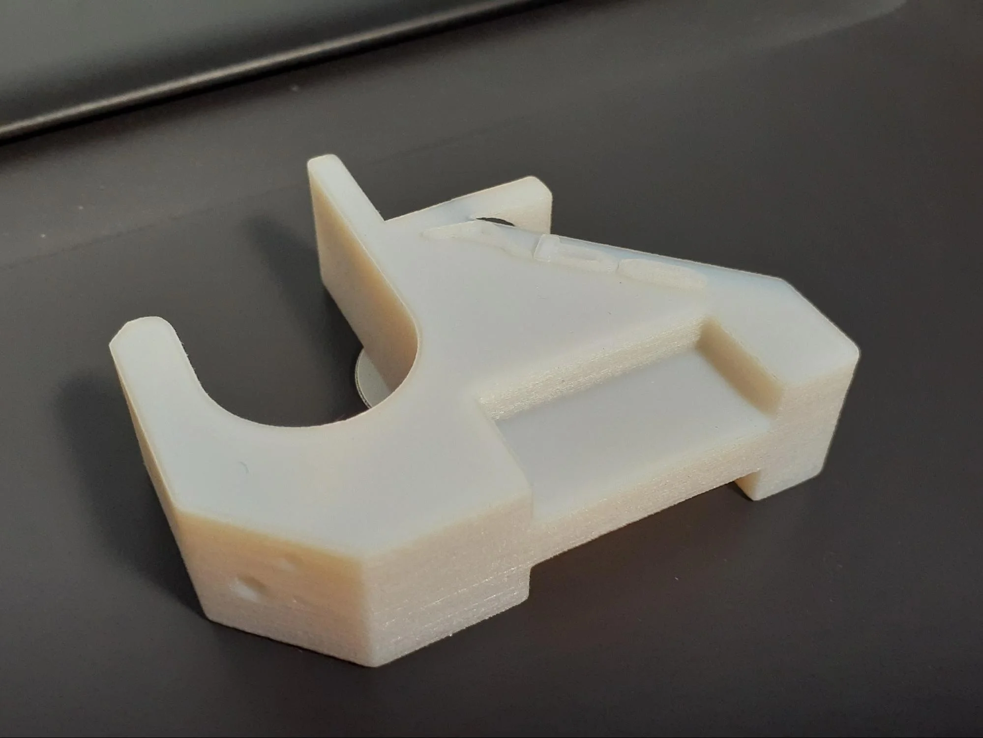

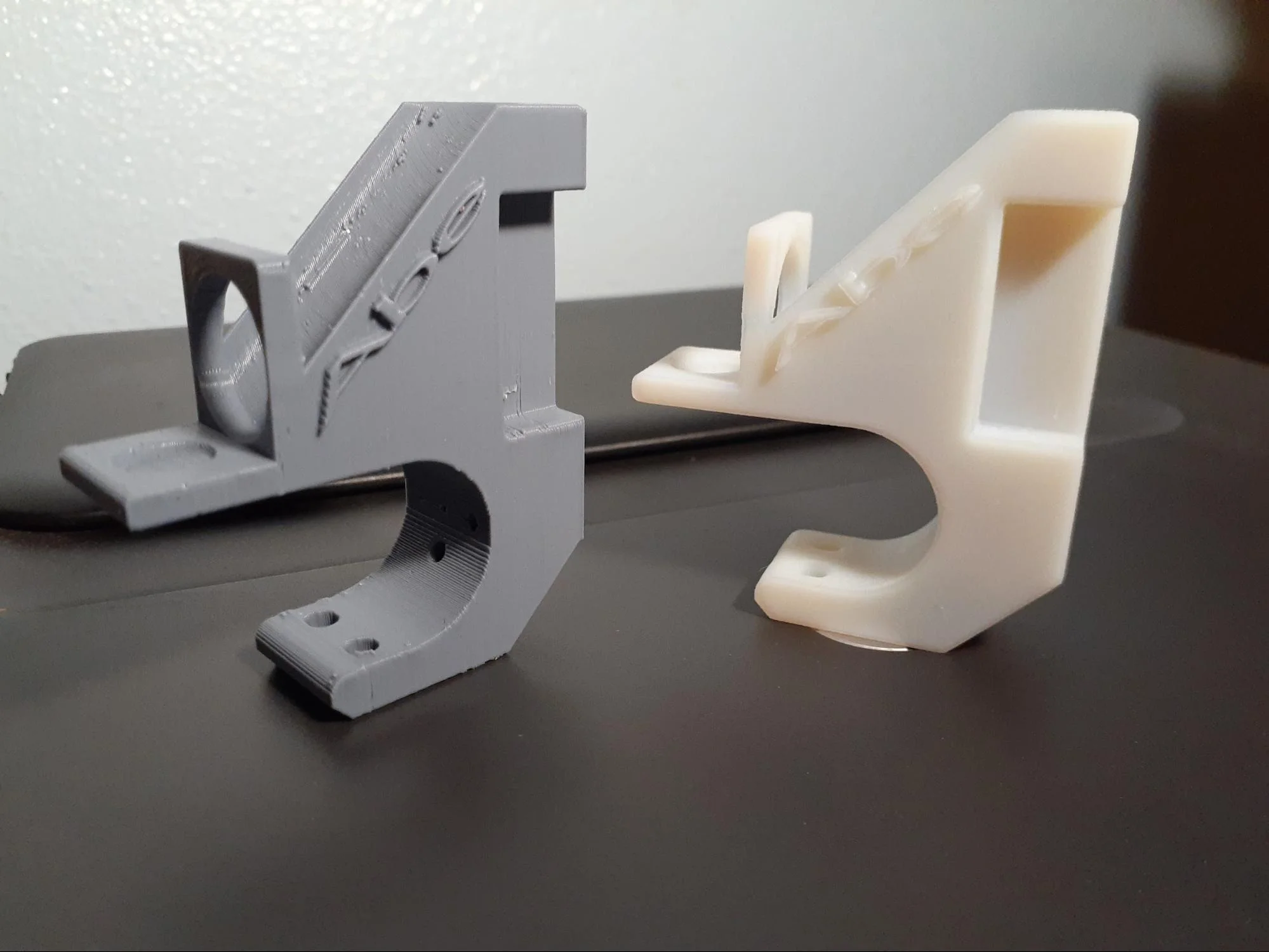

How does each material look and feel on a finished product?
3D Printed Pencil/Pen Holders standing upright.
<em>3D Printed PencilPen Holders standing upright<em>

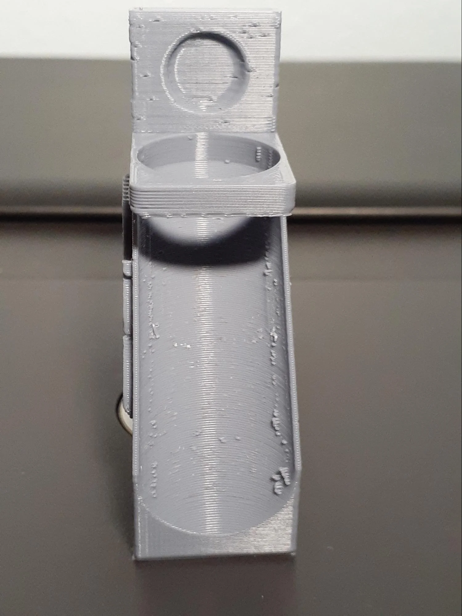

Upon receiving both 3D printed parts, I was speechless, to say the least. In order to avoid color preferences in either material, I tried to choose neutral colors for both pieces; the gray piece on the left was printed using PLA, while the neutral (white/yellow) color piece to the right was printed using ABS-like material. However, the ABS-like piece turned out to be more visually appealing than the PLA material. Not only does ABS-like material have a sleek and well-finished look, but the print lines are virtually invisible to the naked eye.
3D Printed pieces shown in their respective print orientations.
3D printed pencil sharpener
<em>3D Printed pieces shown in their respective print orientations<em>
On the contrary, the PLA material’s print lines are very apparent, but they give insight as to how the piece was oriented during the 3D print. In this case, the ABS-like part was most likely printed on its side with the text facing up, while the PLA part shows signs of being printed on its “back”.

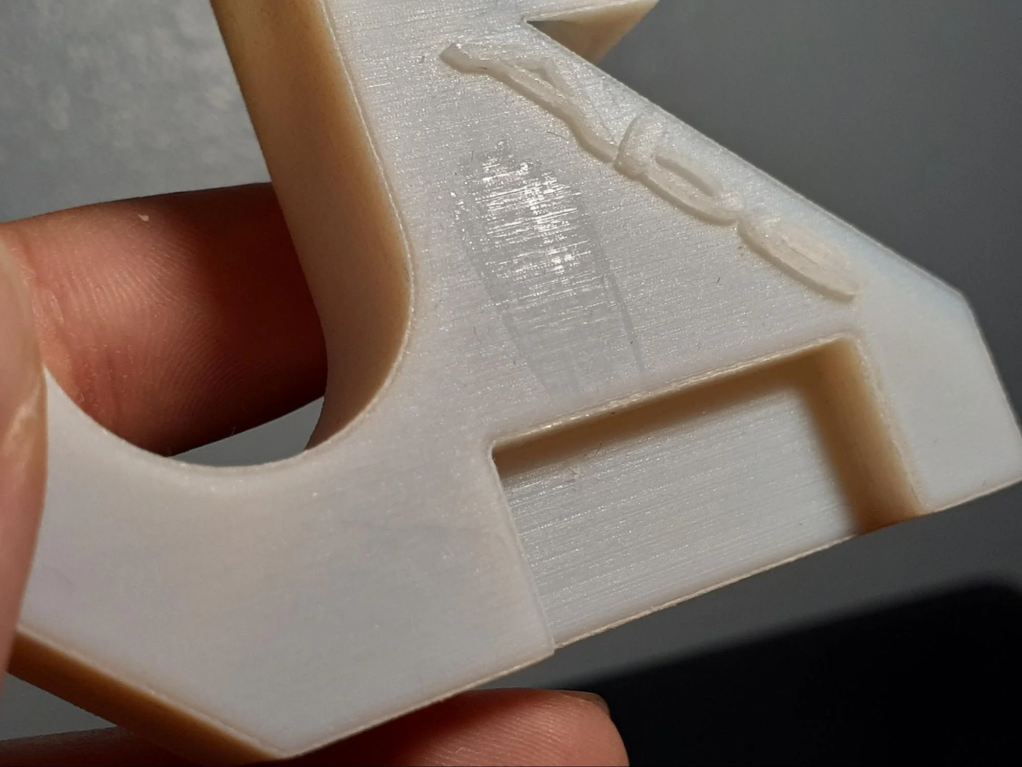

How well does each material withstand an abrasion test?
Proof of slight wear on ABS-like printed piece after performing abrasion test.
<em>Proof of slight wear on ABS like printed piece after performing abrasion test<em>
However, the superior finished look of the ABS-like material is at a greater risk of being permanently damaged. For example, I performed a small abrasion test on both pieces with my fingernail horizontally across underneath the text; while the PLA part remained intact, the ABS-like piece showed visible signs of damage and lost some material on its surface.
Showing rough areas where support material was needed when printing the PLA piece
<em>Showing rough areas where support material was needed when printing the PLA piece<em>
Furthermore, the finished ABS-like material leaves no visible effects of supports which were used when printing the part; the PLA material looks and feels especially rough in such areas.

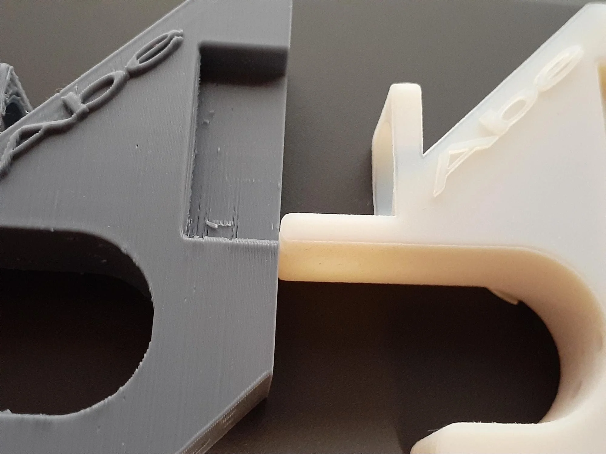

How is text affected by each material’s printing procedures?
The nickname ‘Abe’ is easily recognizable in both 3D print materials
<em>The nickname Abe is easily recognizable in both 3D print materials<em>
Moving into the features of the design itself, we can begin by analyzing how the text compares in both materials. Although the ABS-like piece does boast better-looking text, the visual difference is really only marginal to that of the PLA piece. As a matter of fact, the only noteworthy difference might be the letter spacing; while the ABS-like material magnificently keeps the letters appropriately spaced, the PLA material shows residue that is stuck in between the text’s letters. Granted that the letter spacing is less than 1mm wide, this issue really only becomes a major problem as you increase the letter count in your text. Still, keep in mind that for such a feature to be recognizable and survive the cleaning process of an ABS-like print, the text thickness needs to be a 1.2mm minimum.

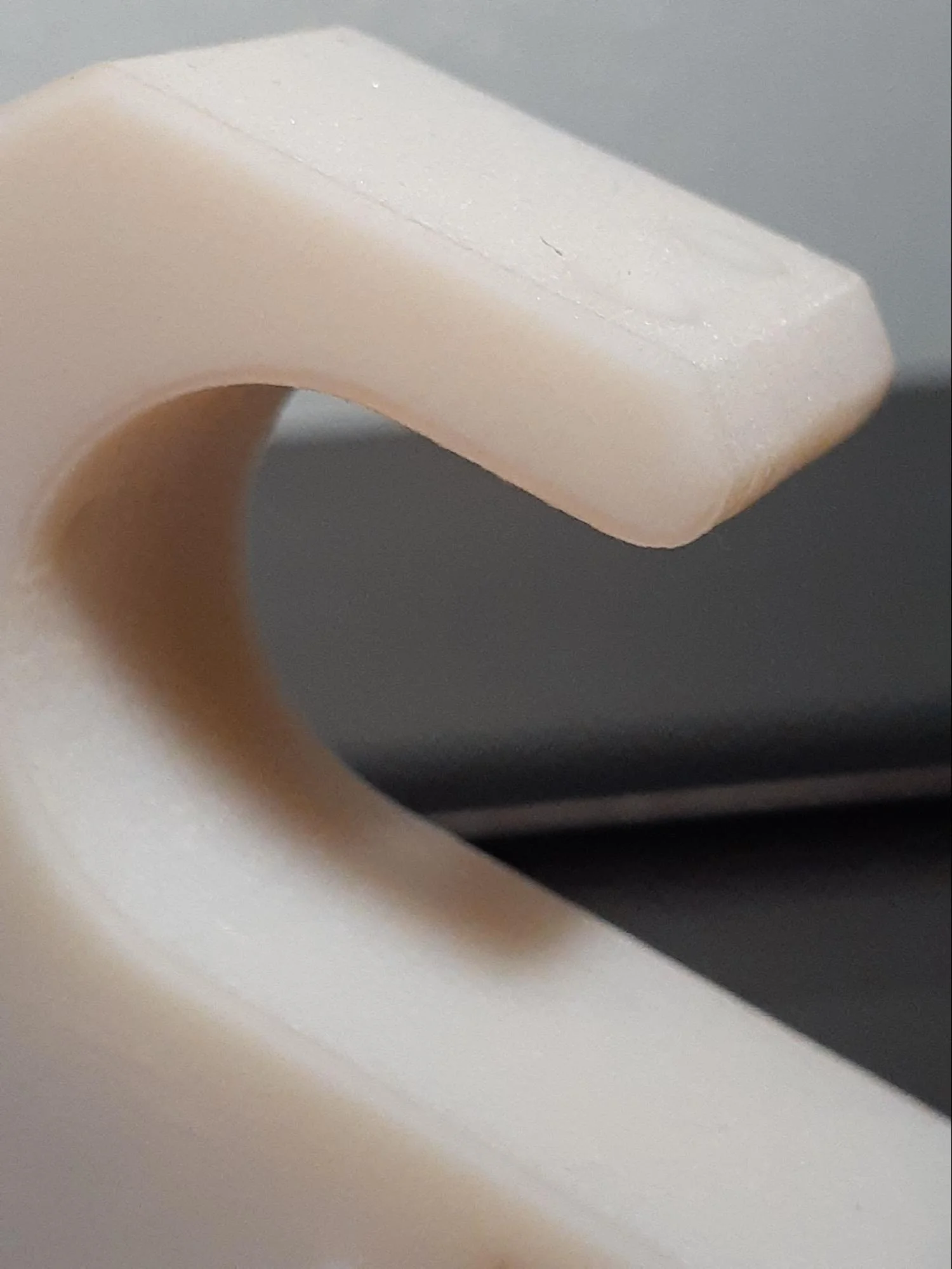

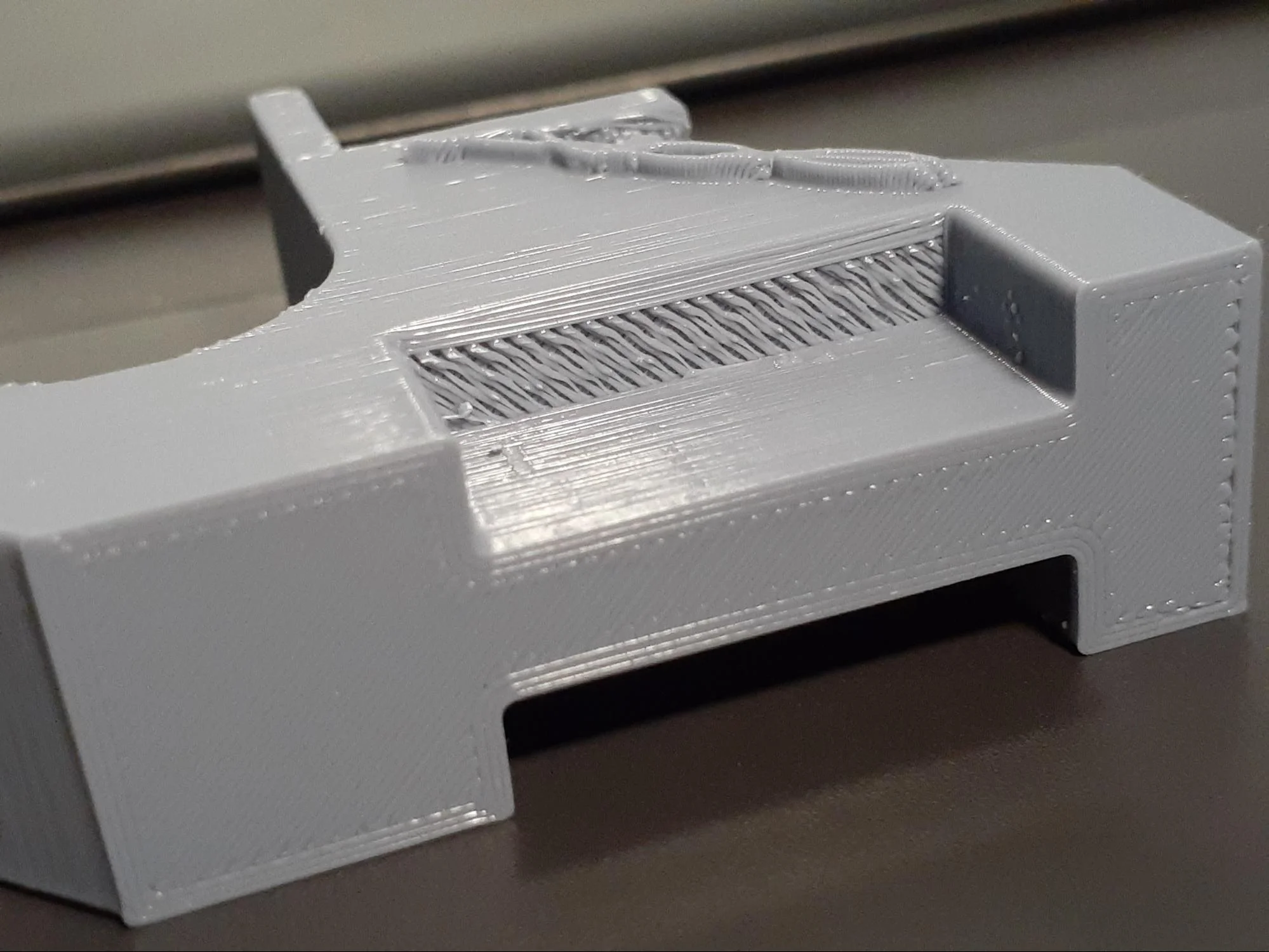

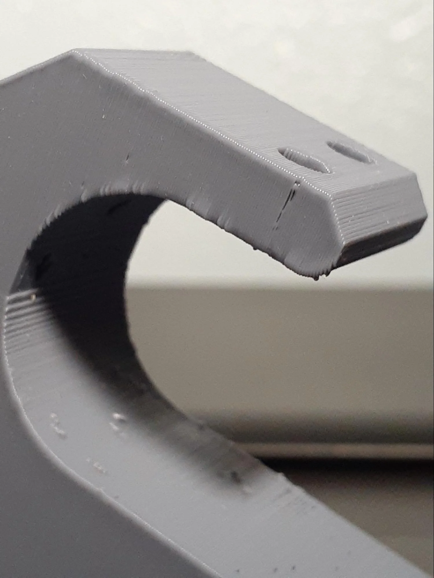

How do simple features such as fillets and chamfers compare in each material?
The PLA part has a rougher transition from chamfer to fillet at the common edge
The ABS-like part has a smoother transition from chamfer to fillet at the common edge
<em>The ABS like part has a smoother transition from chamfer to fillet at the common edge<em>
Focusing on the lower lip of the 3D printed design, there is a chamfer and a fillet of about the same size sharing a straight edge. Although both 3D prints successfully incorporate these specific features, the ABS-like print more precisely defines where the fillet ends and where the chamfer then takes over. In other words, the PLA print blurs the features’ common joining point by widening the straight edge which both the chamfer and fillet share. Furthermore, you can see the many layers of PLA material needed to create both features; however, the ABS-like part does not show these print layers in either chamfer or fillet, due to the material’s higher resolution.

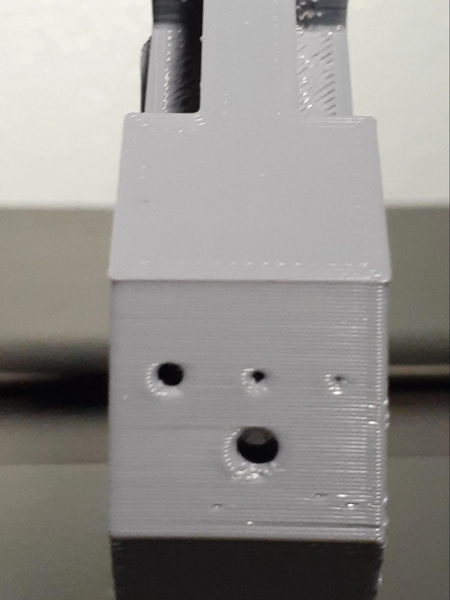

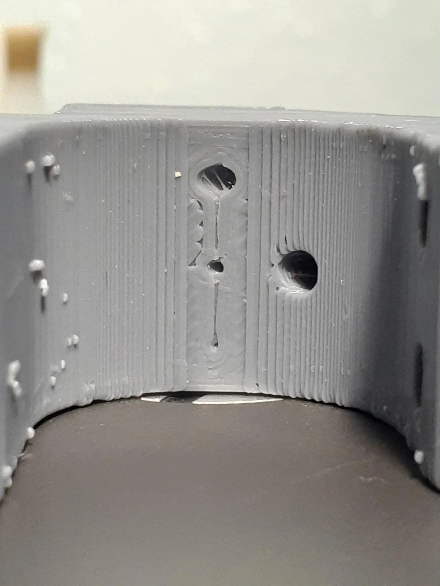

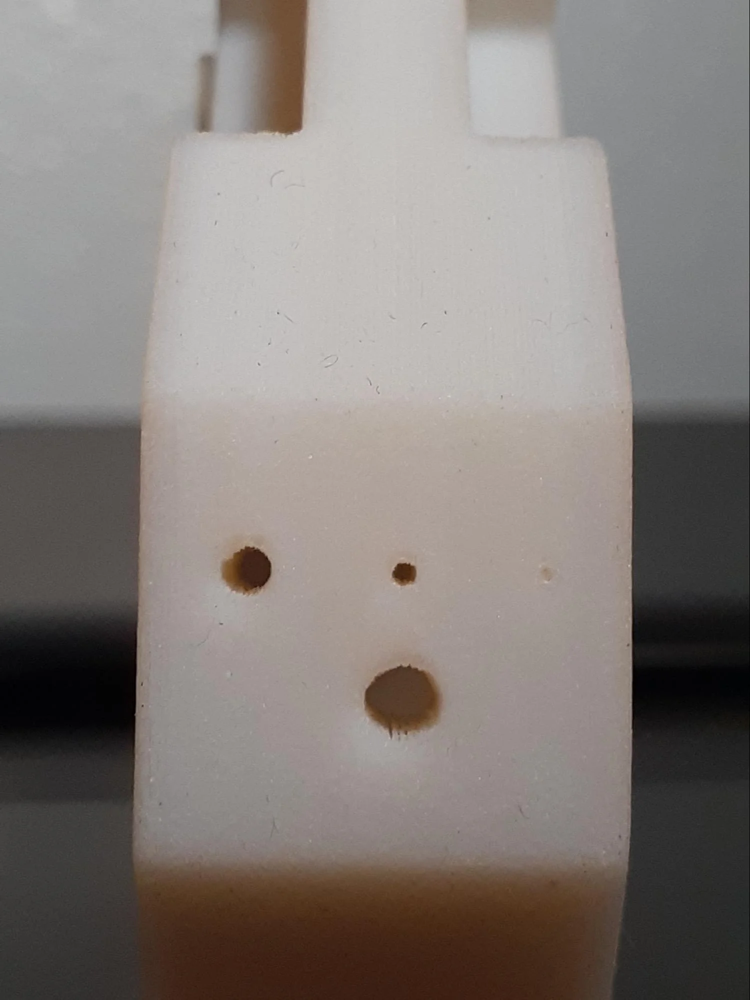

How do simple features such as holes compare in each material?
Comparing the different holes on each material from the back end of the parts.
<em>Comparing the different holes on each material from the back end of the parts<em>

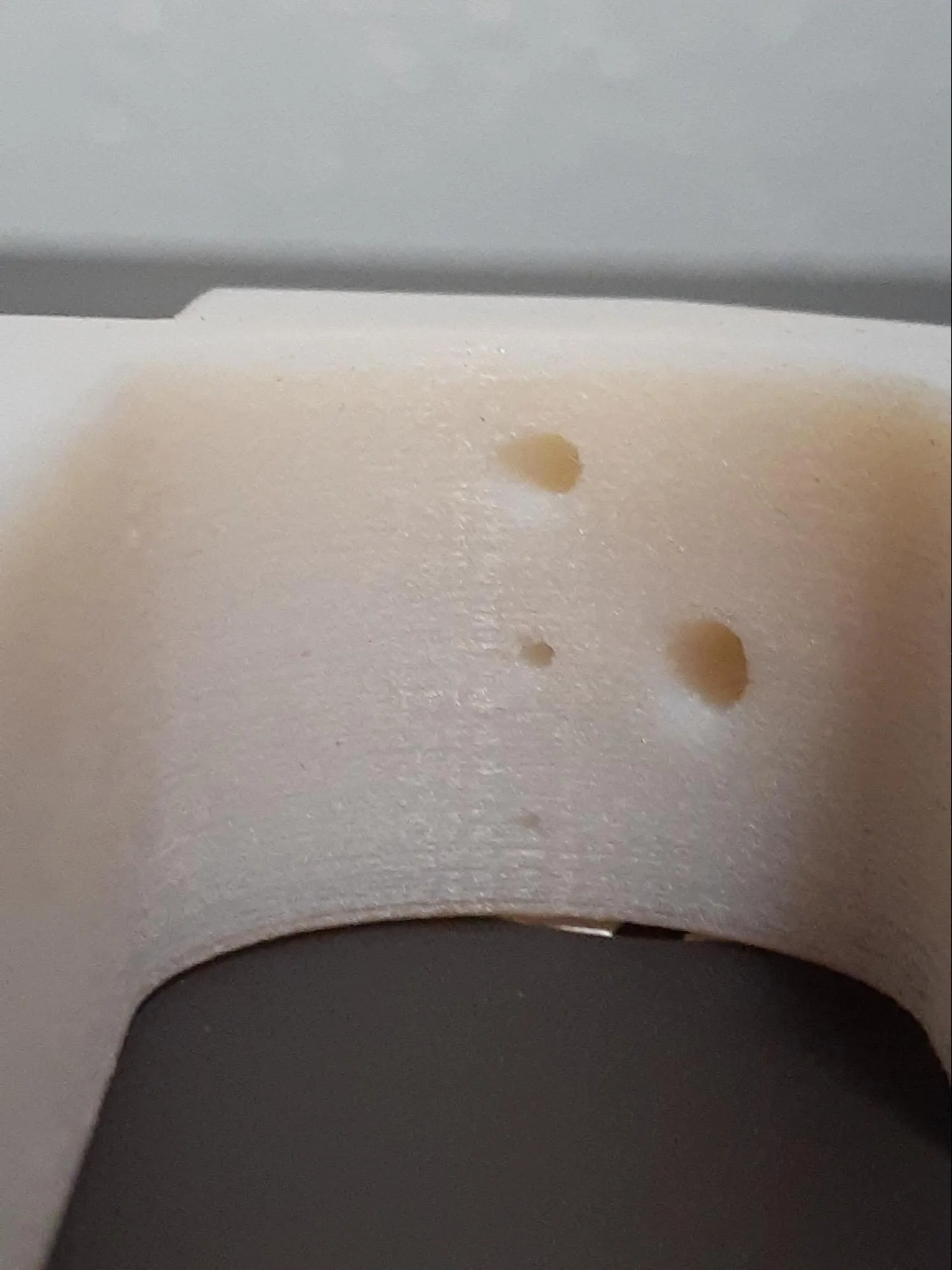

Comparing the different holes on each material from the front along the part’s hidden curved surface
<em>Comparing the different holes on each material from the front along the parts hidden curved surface<em>

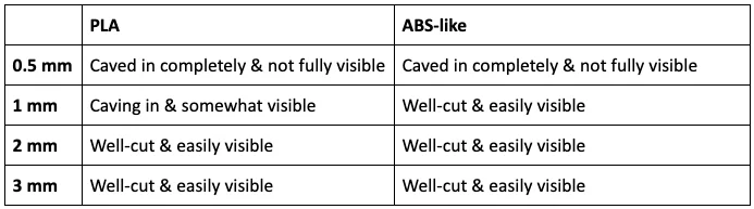

As for the holes, I decided to compare four varying diameters across each printing material: 0.5mm, 1mm, 2mm, and 3mm.
PLA vs. ABS-like
<em>This table outlines descriptions used when analyzing the various holes across both 3D print materials<em>
