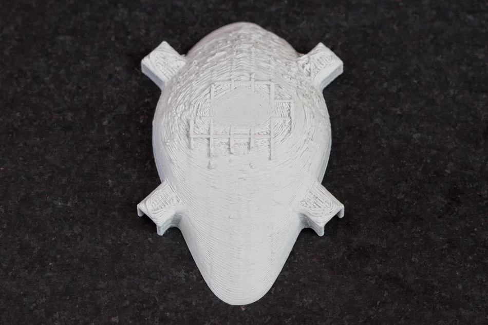

PLA is printed using a breakaway support, a rigid material that is the same as the PLA filament itself. This support is removed by hand (via pliers), meaning that the surface in contact with the support structure is rougher.
the rougher surface of a PLA printed part after support material is removed
The rougher surface of a PLA printed part after support material is removed.

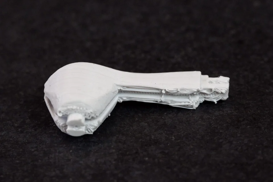

Because the support is broken off, for intricate or fragile features, there is a likely chance that removing support would break the part features.
In some cases, PLA is printed without support at all, in order to get a smoother surface or to avoid the breaking of certain components. The tradeoff is that overhang features are more prone to sagging. If you’re considering PLA, check out our Design Guidelines for Prototyping with PLA for a more in-depth look.
overhanging features have “stringing” on the underside
Overhanging features sag when printed without support, so they have “stringing” on the underside.

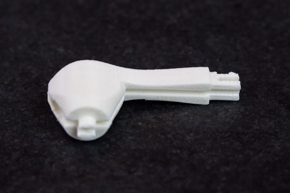

ABS uses a soluble support system. Support is removed via immersion in a bath, followed by drying of the part. As long as every feature has a clearing for the support to be removed, and there are no enclosed channels, support is removed very cleanly.
ABS has a smoother finish than PLA
While they both have the same resolution spec, ABS has a significantly better and smoother surface finish than PLA.
Therefore, ABS is great with more delicate and/or complex features and is the better material for parts that have overhangs or require a higher-quality surface finish.
Soluble support is removed for smoothness despite the overhanging features
Soluble support is easily removed for smoothness and accuracy, despite the overhanging features.

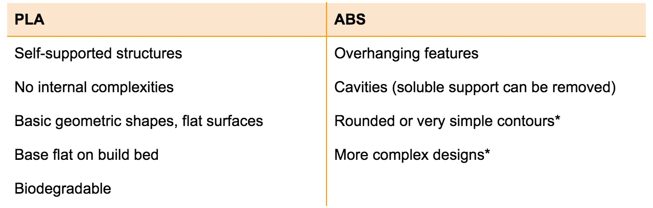

For simple geometries and when precision is not of essence, PLA works very well. In some cases and for certain specific designs, it will look very close to ABS, albeit being less expensive. Here are some quick guidelines to look out for in your design:

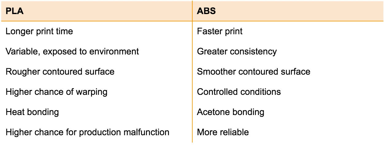

PLS and ABS guidelines
*Note that while ABS is superior to PLA for complex designs and contoured shapes, it will still have visible stepping. For the greatest quality and the best finish for highly complex/intricate designs and organic surfaces, that’s where you want to step up to a PolyJet printer!

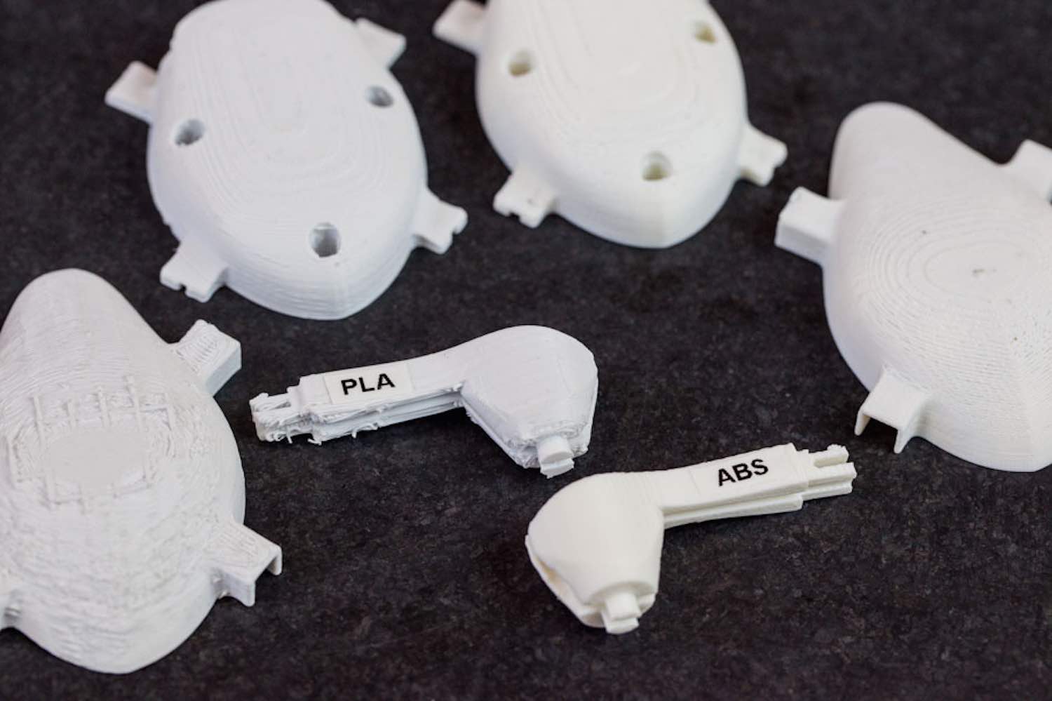

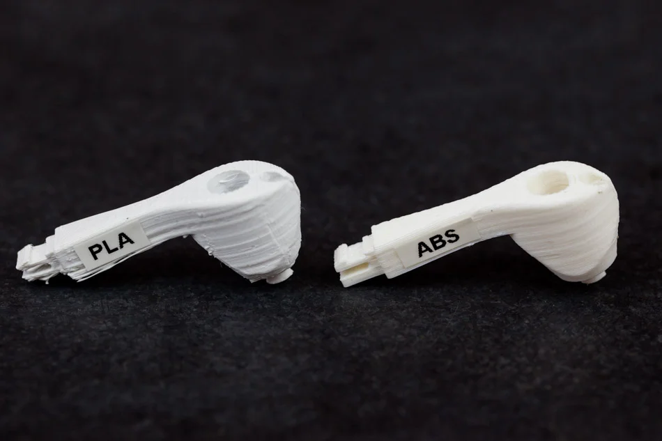

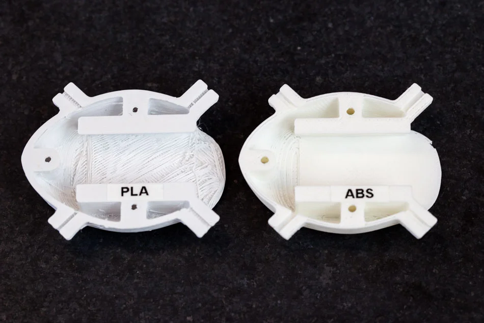

Since pictures are worth a thousand words, here is a comparison of the two materials used to print components of a drone.
side-by-side PLA and ABS comparison

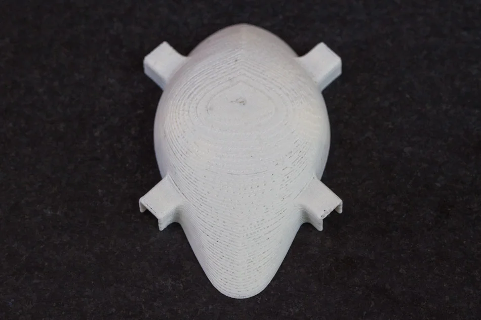

The parts are printed in the orientation above. Due to different support systems, the underside of the ABS part is much smoother than that of the PLA.

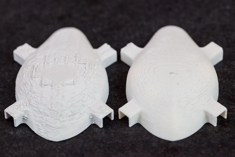

While flat surfaces are very similar, the inside of the shell printed in PLA is much rougher, since it requires support (and removal) to be printed.
PLA (left) vs. ABS (right)—the difference in quality for contours (requiring support) is apparent!

additional PLA and ABS qualities
