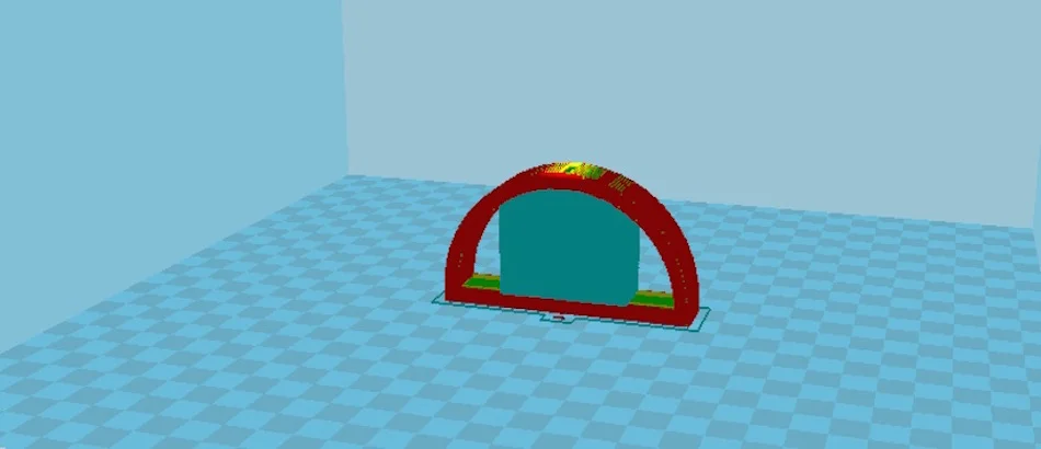

Rule 1 – 45 Degree Design
FDM printing can self support up to a 45-degree angle. After the angle surpasses 45 degrees, PLA will add rigid support in order to prevent drooping during the print. You’ll want to avoid this because not only does support material add cost, but it creates a rough surface finish after it’s removed.

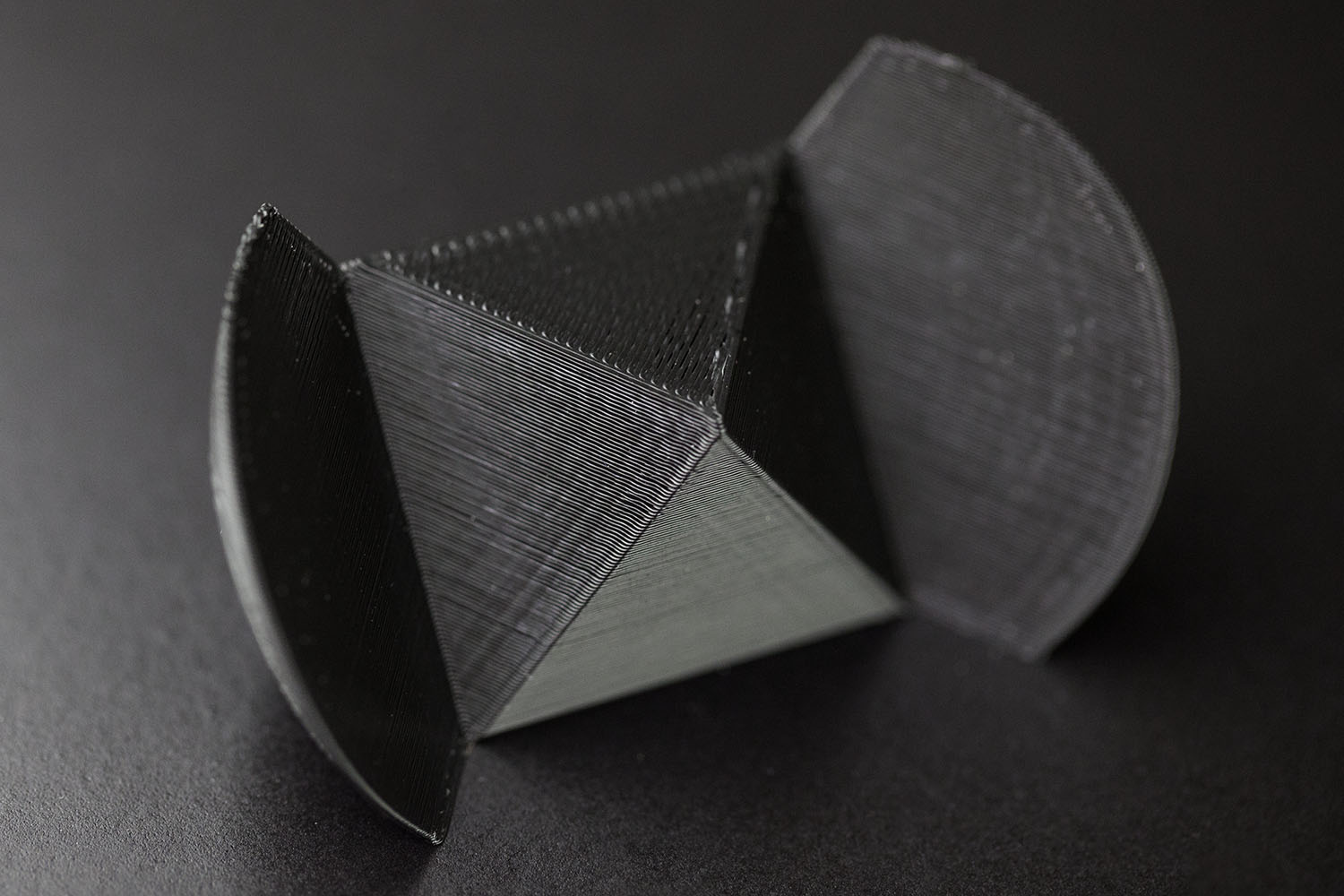

Also, it’s important to note that with any slopes or curves on PLA, you should expect visible stepping on the surface. Due to the material’s low resolution, it’s unable to capture gradient surfaces.
![PLA's low resolution](https://www.fictiv.com/wp-content/uploads/2020/07/dfm-for-pla-image02.jpg)

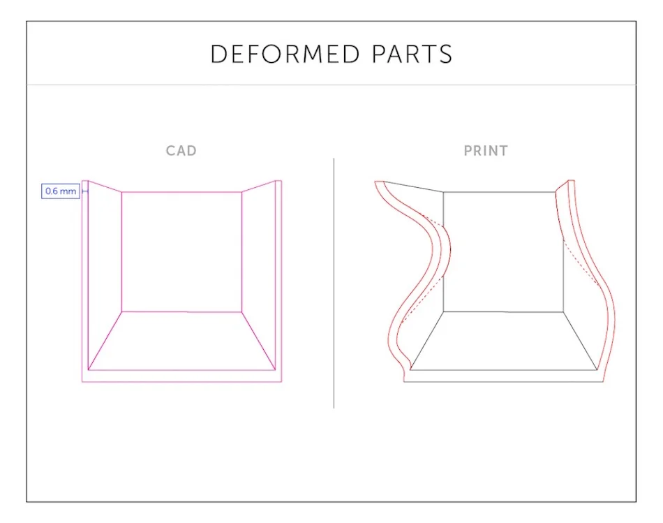

Rule 2 – 1.5mm Minimum Wall Thickness (and Ribbing!)
Wall thicknesses are critical in PLA because the low resolution print will often fail if it does not have a strong supporting layer. For this reason, Fictiv recommends at least 1.5mm, but preferably more.
Additionally, because PLA uses a process of melting plastic and then cooling it layer by layer, there is always a risk of warping. To minimize chances of warping, tall or long walls should be supported or have a ribbing structure to provide rigidity. This also applies columns or pins.
![avoid warping in PLA](https://www.fictiv.com/wp-content/uploads/2020/07/dfm-for-pla-image03.jpg)

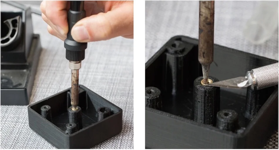

Rule 5 – Brass inserts > Threading
With a low resolution material, designing in threading is never a great idea, unless you have high thread pitch. For most cases, you’re going to be much better off using a heated brass insert. Because PLA has a low melting temperature, a simple soldering iron will help slide an insert right into a designed through-hole with relative ease.
As a design tip, you can find the heated brass insert you need at McMaster-Carr to get the dimensions. Design the hole to the smallest “Tapered Hole Diameter,” and design the walls around the insert to be at least 2mm thick. Don’t forget, the longer the column, the thicker you should make the walls!
![installing with heated brass insert](https://www.fictiv.com/wp-content/uploads/2020/07/dfm-for-pla-image05.jpg)
