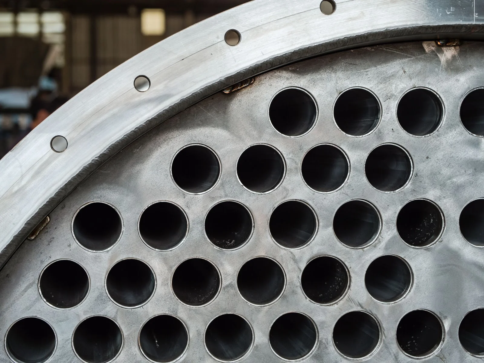

Stainless Steel Tube and Shell Heat Exchanger

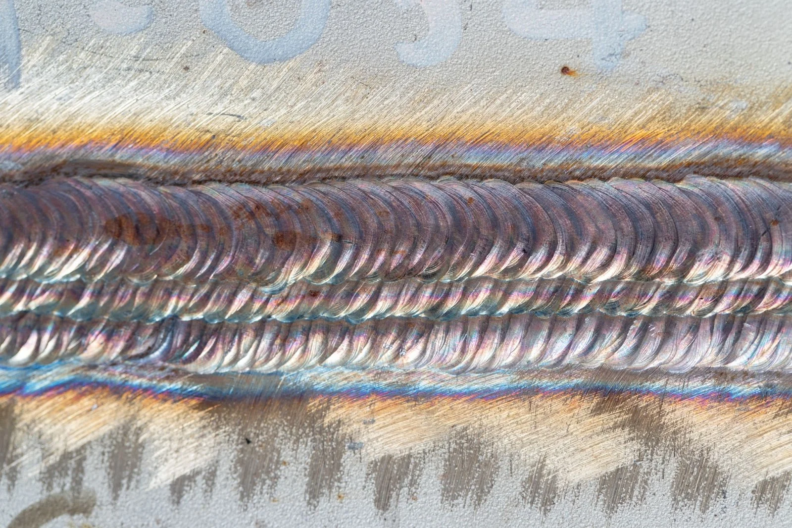

304 stainless steel has a lower carbon content that reduces the risk of sensitization — aka the precipitation of carbides at the grain boundaries that causes susceptibility to intergranular corrosion. This lower carbon content also reduces carbide precipitation in the heat-affected zone during welding. There are many varieties of low carbon 304, including: 304 drawing, 304 extra drawing, and 304L tubing.

Arc welded stainless steel showing heat affected zone
