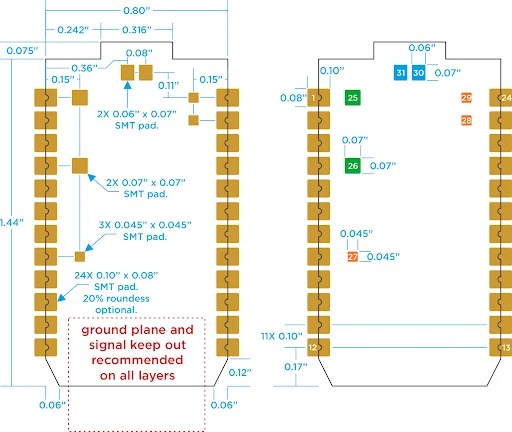

Step 2: Model the Internal Components
Now that we know the product requirements, it’s time to map out how the internal components will be held and positioned in the enclosure. To do so, you must understand what enclosure components are being used in the system, how they function, and their level of accessibility for operation. In our example, a Photon Particle board, a temperature sensor, and a soil moisture sensor must be contained within the custom plastic enclosure.
By modeling the enclosure’s internal hardware first, we can design the custom enclosure to both secure and protect the Photon board and sensors. Also, it’s critical to create the design with accurately scaled and dimensioned components so that the 3D modeling of the mounting holes and profile of the plastic enclosure are accurate, too.
Pro-tip: Specification sheets, 2D drawings, or 3D models of electronic components are often available from the manufacturer.
![Pro-tip: Specification sheets, 2D drawings, or 3D models of electronic components are often available from the manufacturer.](https://www.fictiv.com/wp-content/uploads/2022/10/photon-board.png)
![2D & 3D models](https://www.fictiv.com/wp-content/uploads/2022/10/soil-moisture-sensor.jpeg)
Keep in mind that the placeholder models don’t need to reflect every feature of the part. The critical dimensions are mating features and overall size dimensions, since features that will interact with other parts and dictate mounting should be incorporated into the model.
For instance, the models of the soil moisture sensor and Photon board are pretty blocky, but the extent of the parts is accurately represented below.
