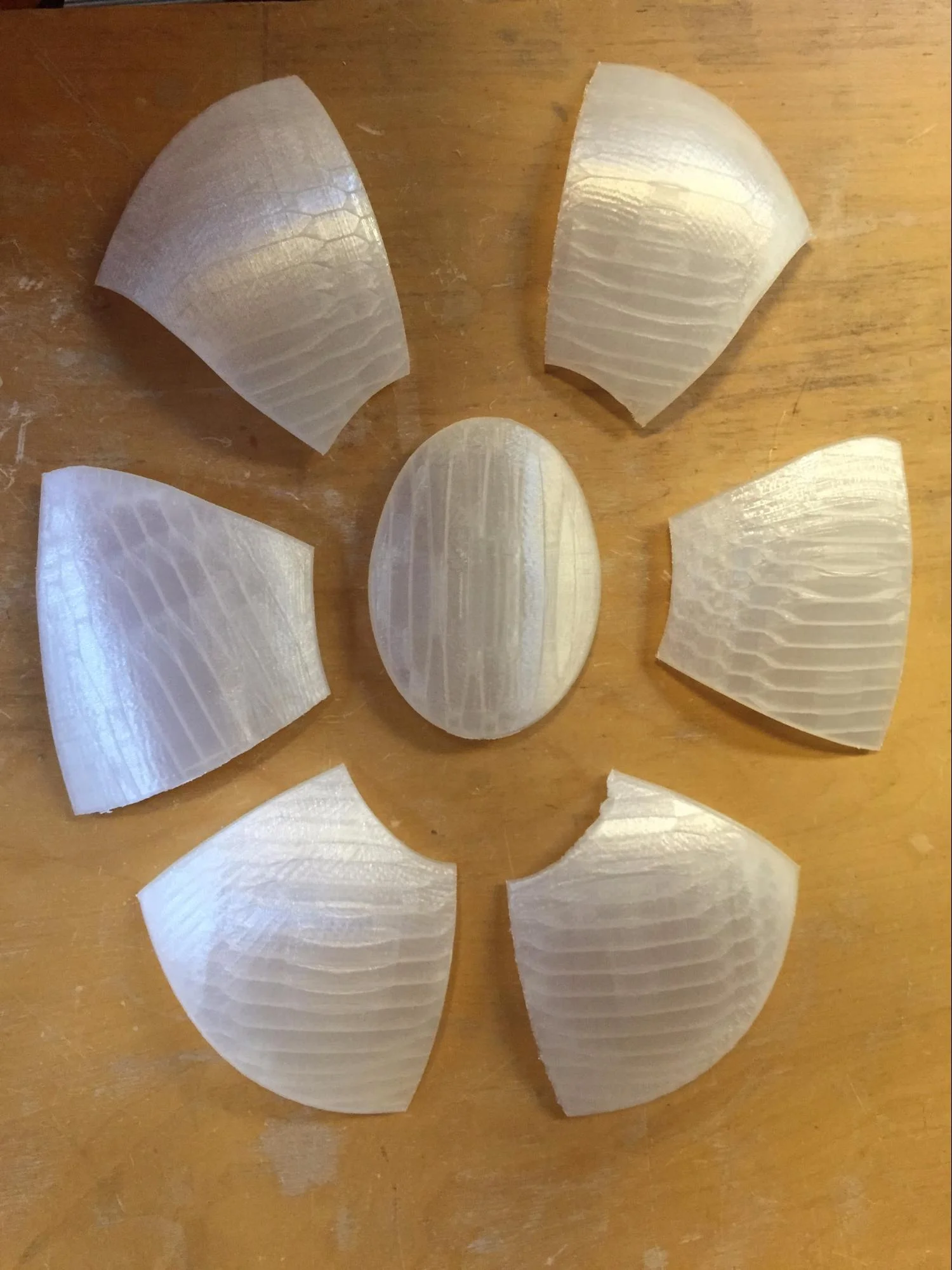

Step 2: 3D printing
I printed all the files on a Makerbot Replicator 2, and in order to ensure smooth part surfaces, I chose to orient them standing. This meant more printing time and less sanding time.

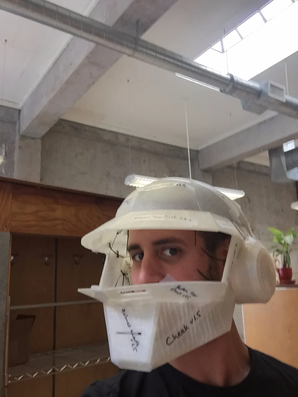

Step 3: Welding rehearsal
In order to see what the helmet would look like (and because I was too excited to wait for the welding step), I put all the parts together with zip ties, marking the different parts with a Sharpie + tape.

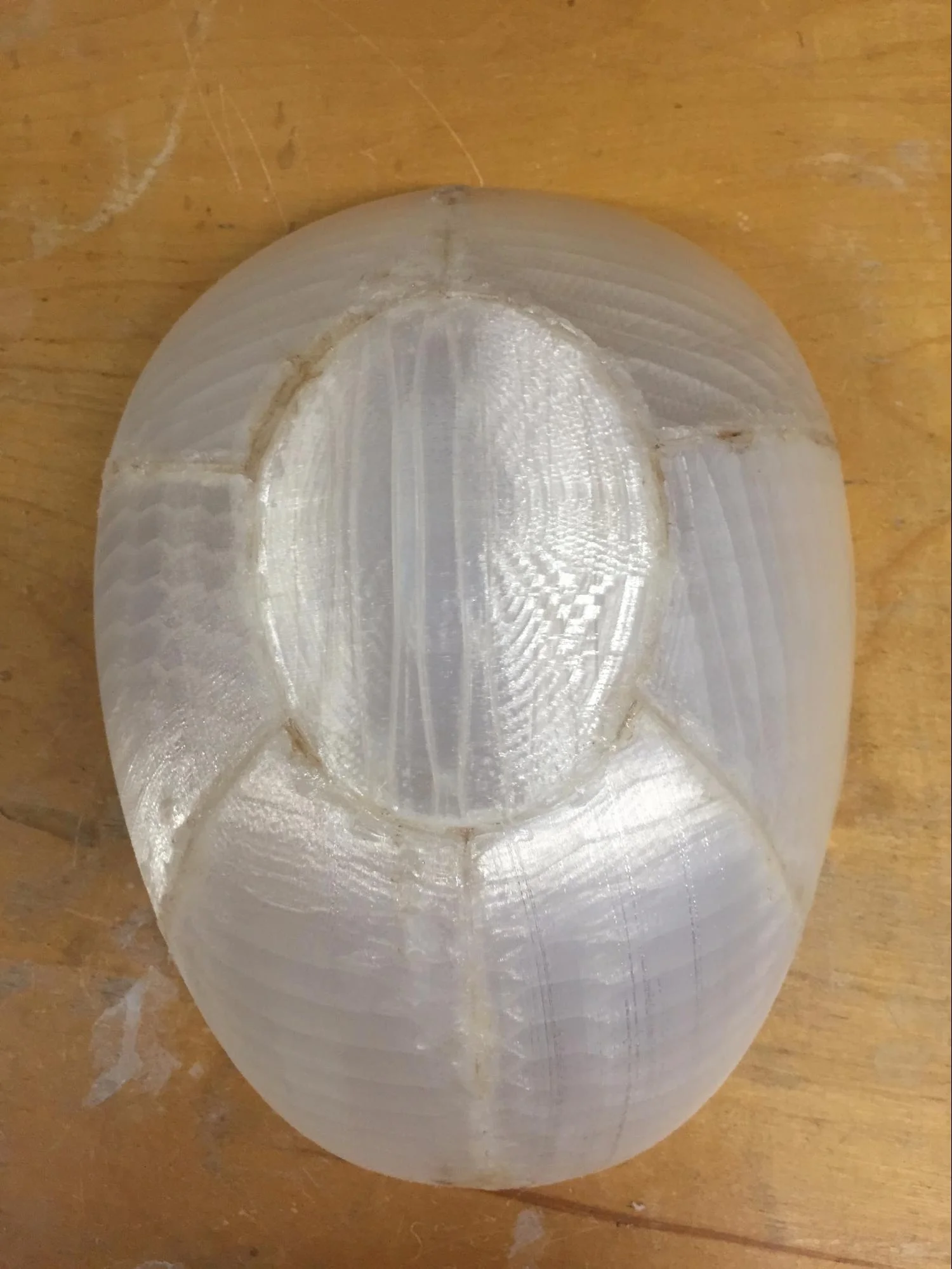

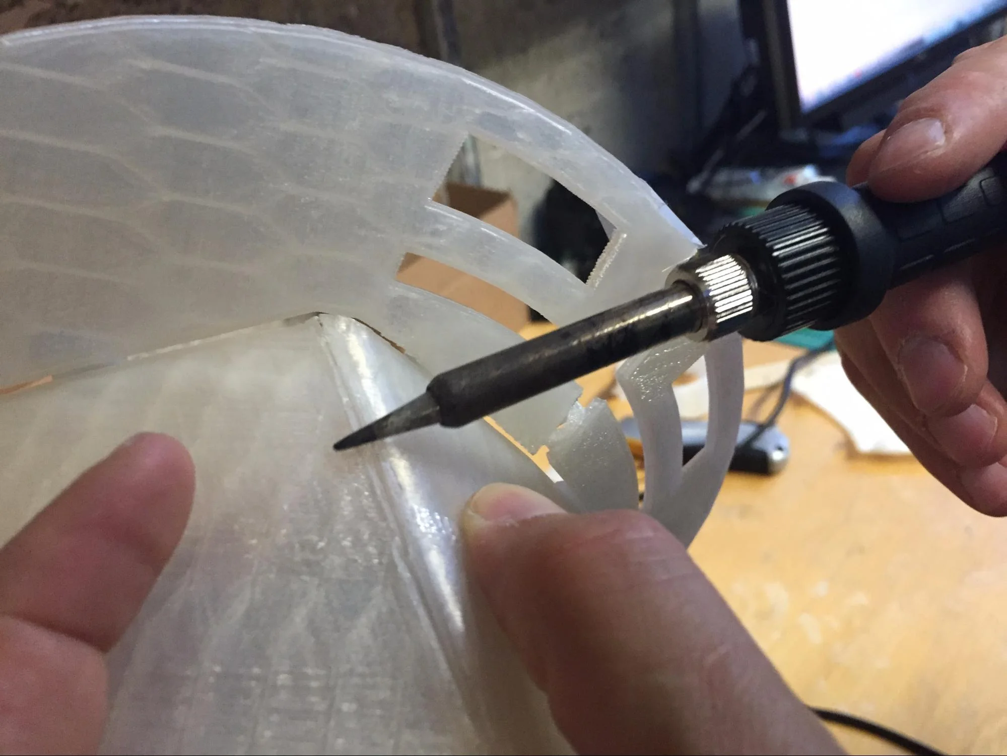

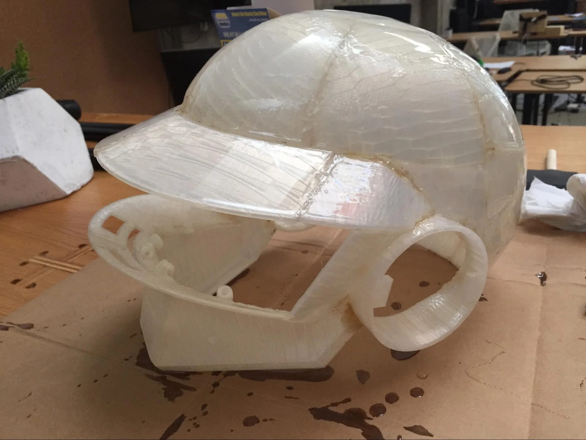

Step 4: Actual welding
I decided to weld the parts and not use screws as the original design suggests. My reasoning was that welding would allow me to have a smoother and sturdier helmet with no extra weight.
Because I had very limited experience with welding, I decided to first weld the dome of the helmet, which was the easiest, using a soldering iron at 300 degrees Fahrenheit.
![The welded dome of a Daft Punk helmet](https://www.fictiv.com/wp-content/uploads/2020/08/daft-punk_04.jpg)
After that, I went ahead and welded the rest of the helmet.
![smoothing Daft Punk helmet seams with a soldering iron](https://www.fictiv.com/wp-content/uploads/2020/08/daft-punk_05.jpg)
![Welding Daft Punk helmet parts](https://www.fictiv.com/wp-content/uploads/2020/08/daft-punk_06.jpg)

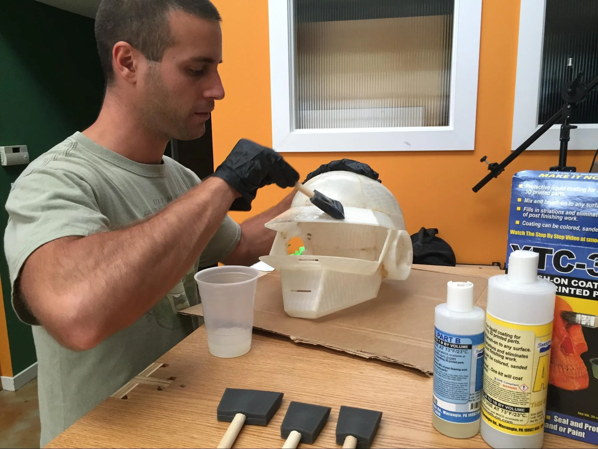

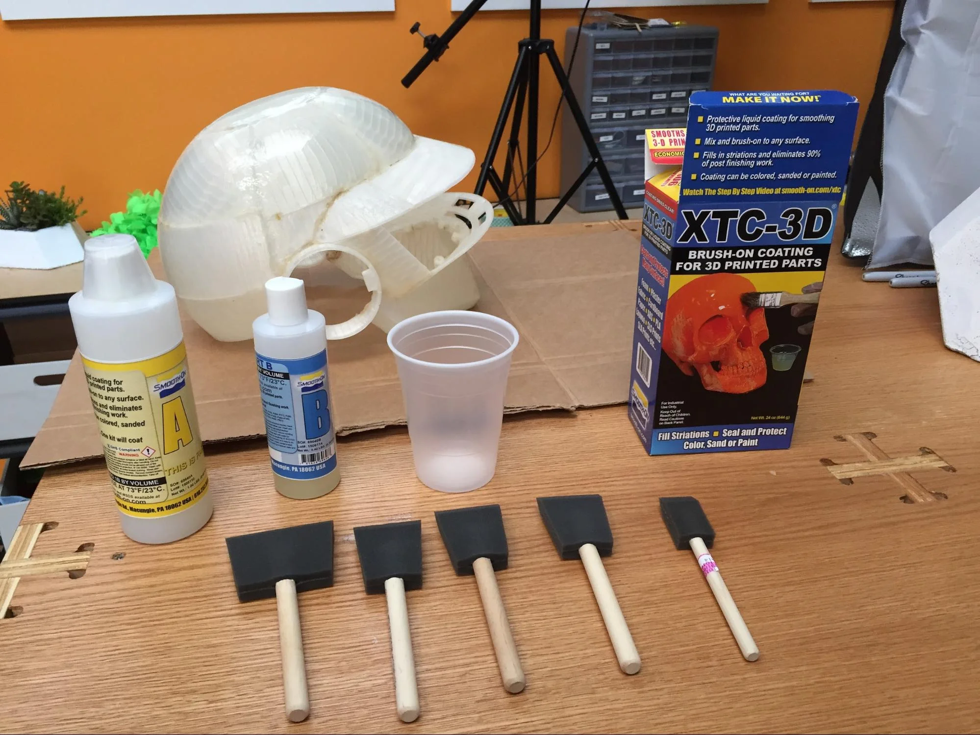

In order to give the helmet a smooth texture, I used XTC 3D epoxy resin.
Instructions come on every bottle, and it’s easy to use. Just be sure to use a mask when mixing, as the 2 mixed materials start reacting immediately and produce fumes.
![Surface finishing materials for Daft Punk helmet](https://www.fictiv.com/wp-content/uploads/2020/08/daft-punk_07.jpg)
![Surface finishing a Daft Punk helmet](https://www.fictiv.com/wp-content/uploads/2020/08/daft-punk_08.jpg)
![Daft Punk helmet coated with surface finish](https://www.fictiv.com/wp-content/uploads/2020/08/daft-punk_09.jpg)

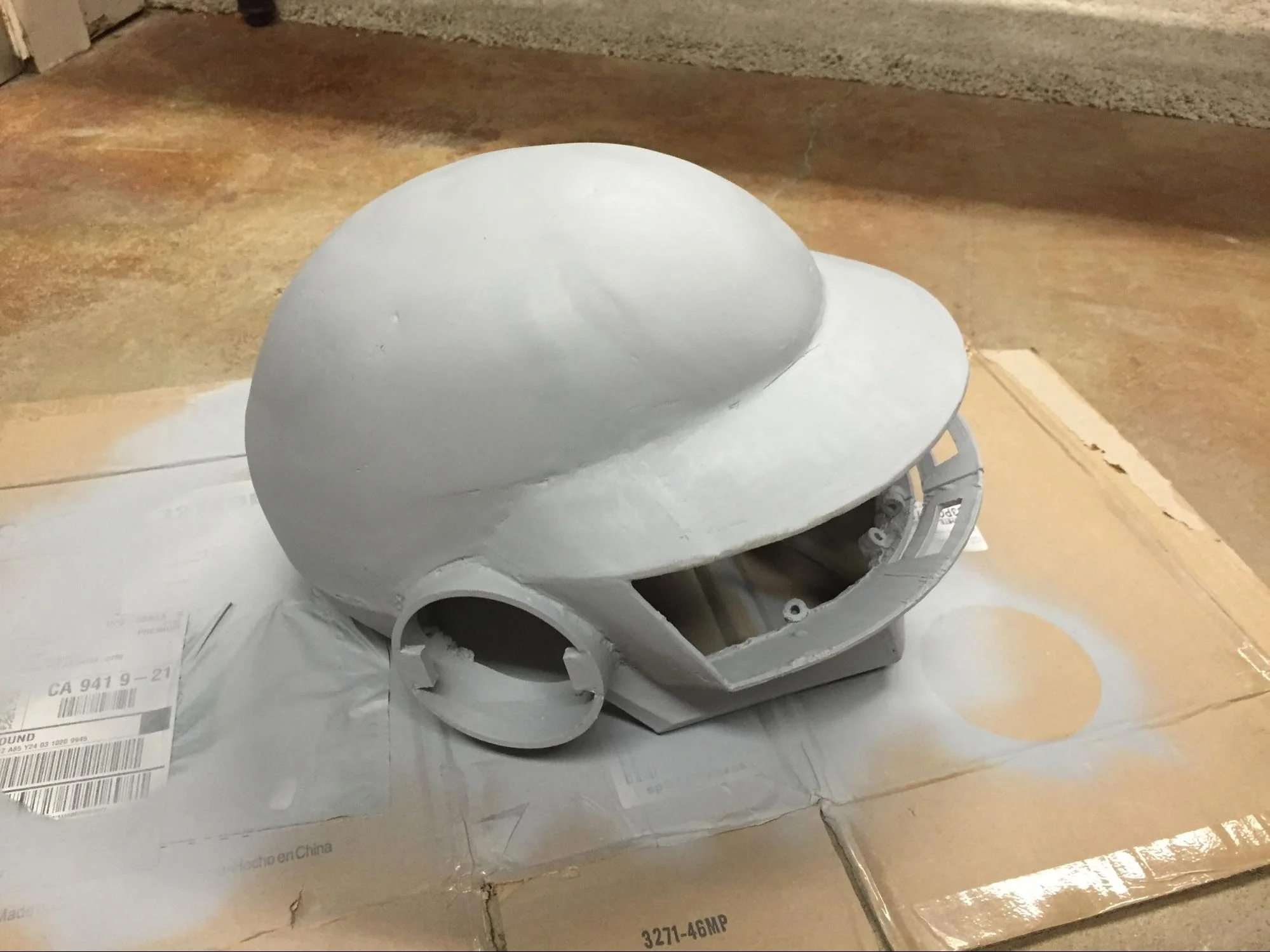

Step 7: Applying primer
After sanding down the helmet, I applied a gray spray-painted primer.

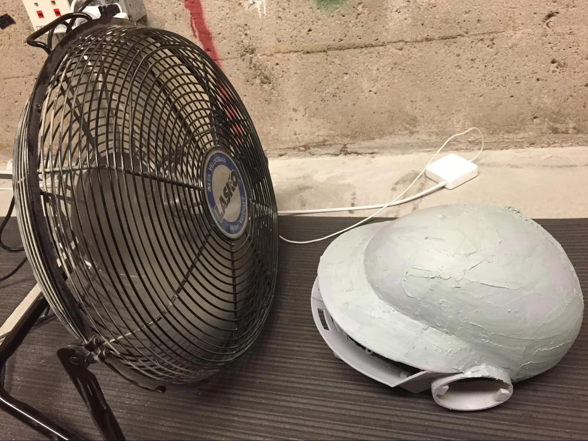

Step 9: Drying the bondo
In order to save time, I put the helmet with the wet bondo in front of a fan. Waiting time: 30min.

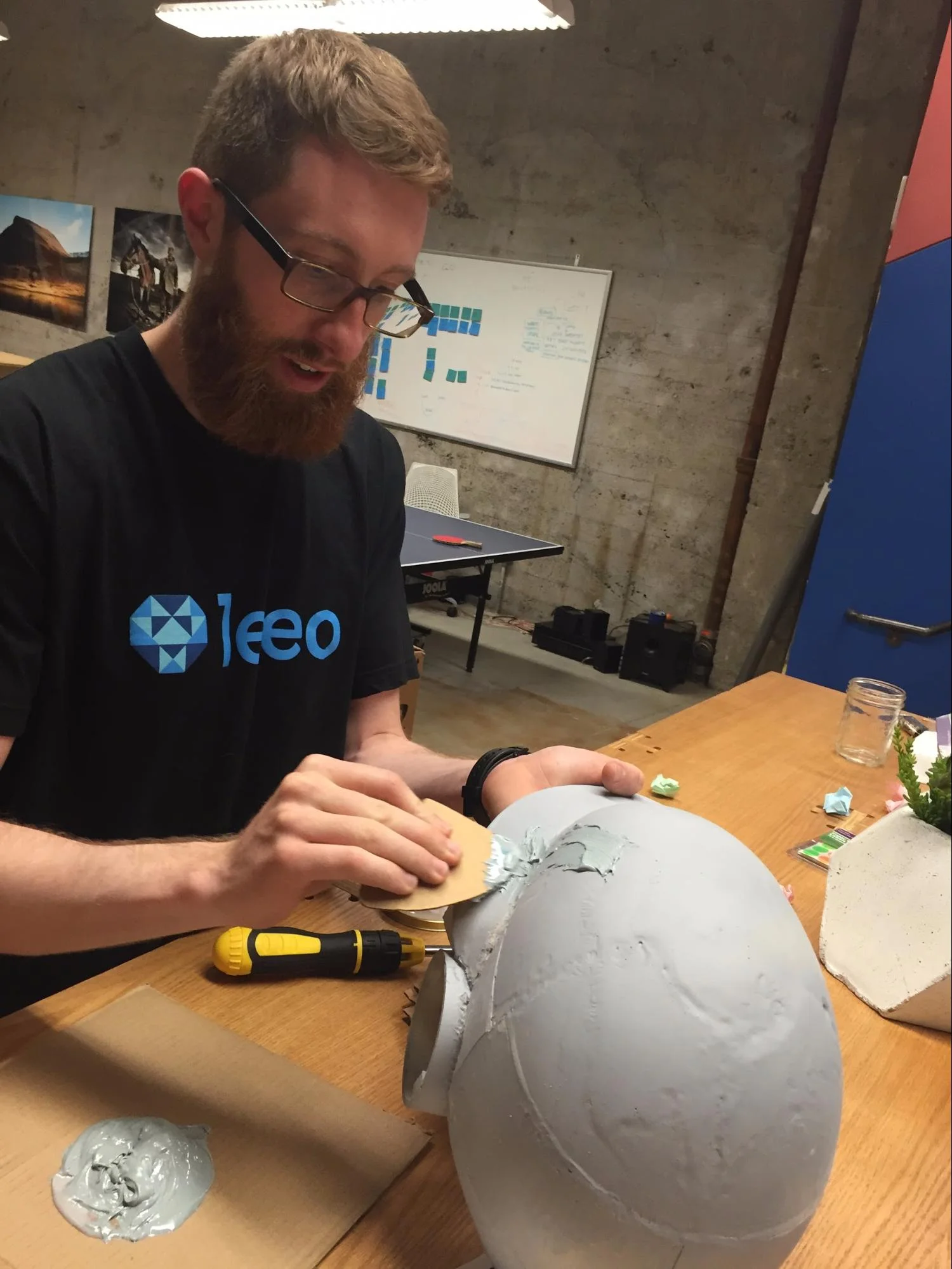

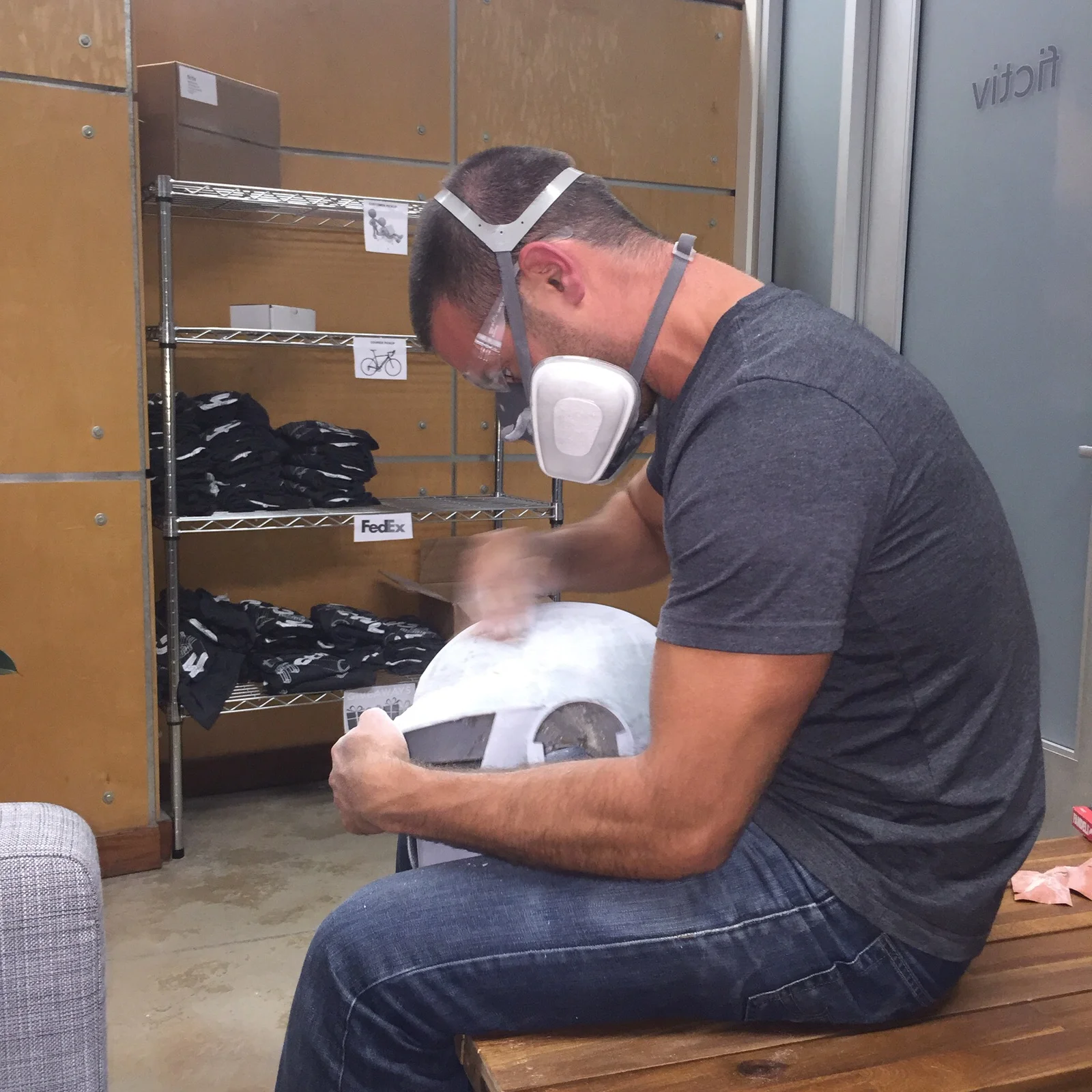

Step 10: Sanding like there’s no tomorrow
Mask and safety glasses needed.
Patience absolutely needed.
Time of sanding: 3 hours.
Sandpaper used: Fandeli Grit 100.
Beer used: Ballast Point Sculpin.
![Sanding the Daft Punk helmet](https://www.fictiv.com/wp-content/uploads/2020/08/daft-punk_15.jpg)
Step 11: More primer
After hours of sanding, I applied another coat of the primer.

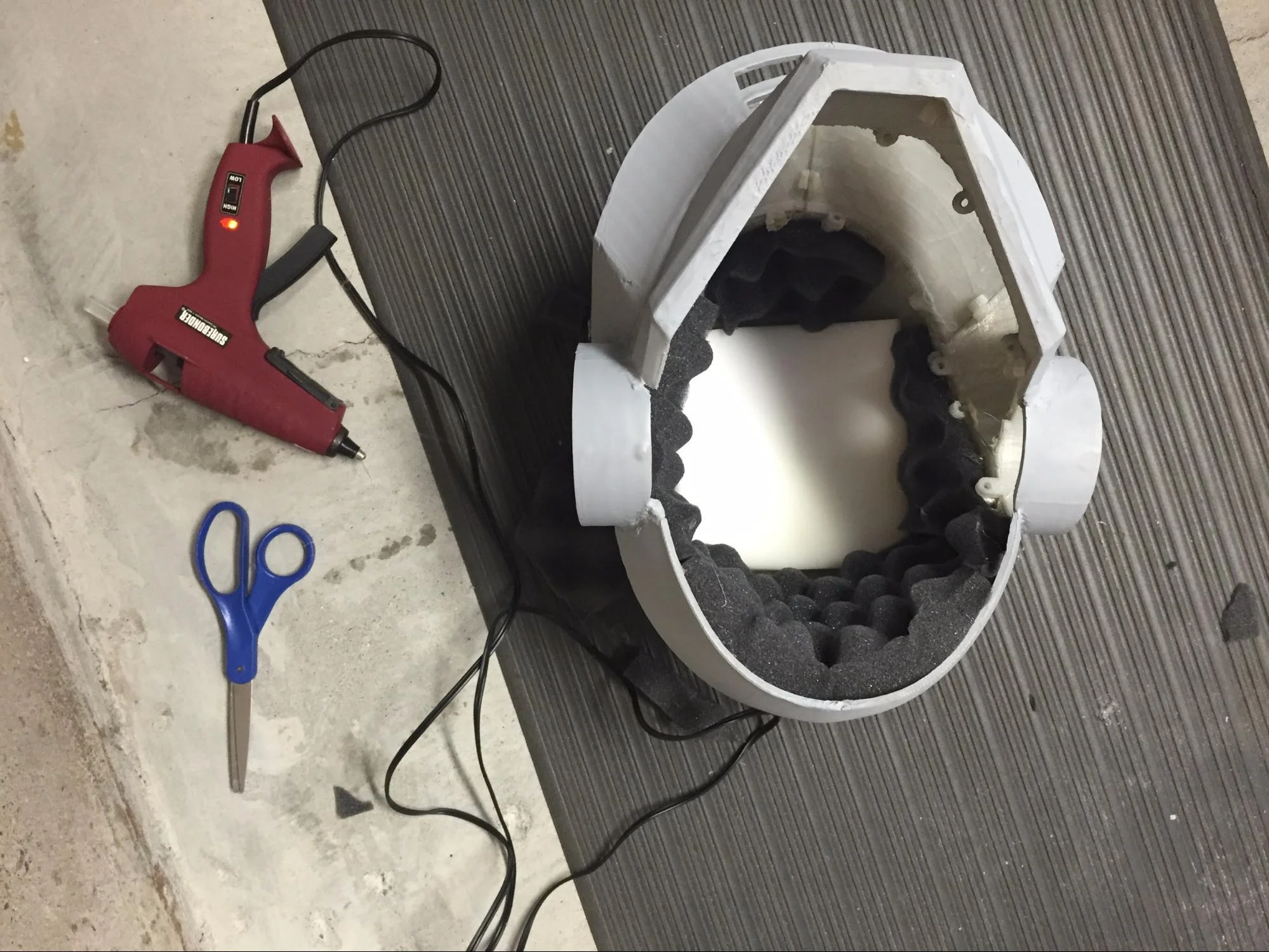

Step 12: Add foam for head protection
The trick here is to check in front of the mirror how much and what thickness foam you need for each side. This will determine where the helmet sits on your head, so it’s very important.
Glue gun used: Surebonder. You only need 5-6 points of glue per foam part.
![Adding foam to the Daft Punk helmet](https://www.fictiv.com/wp-content/uploads/2020/08/daft-punk_19.jpg)

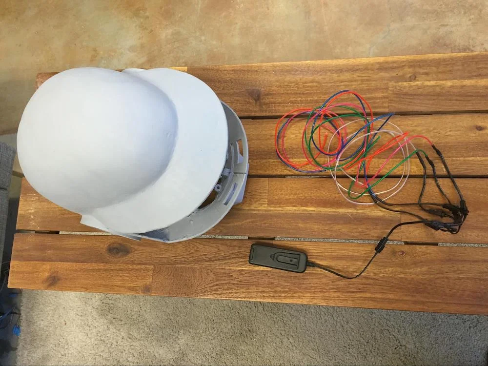

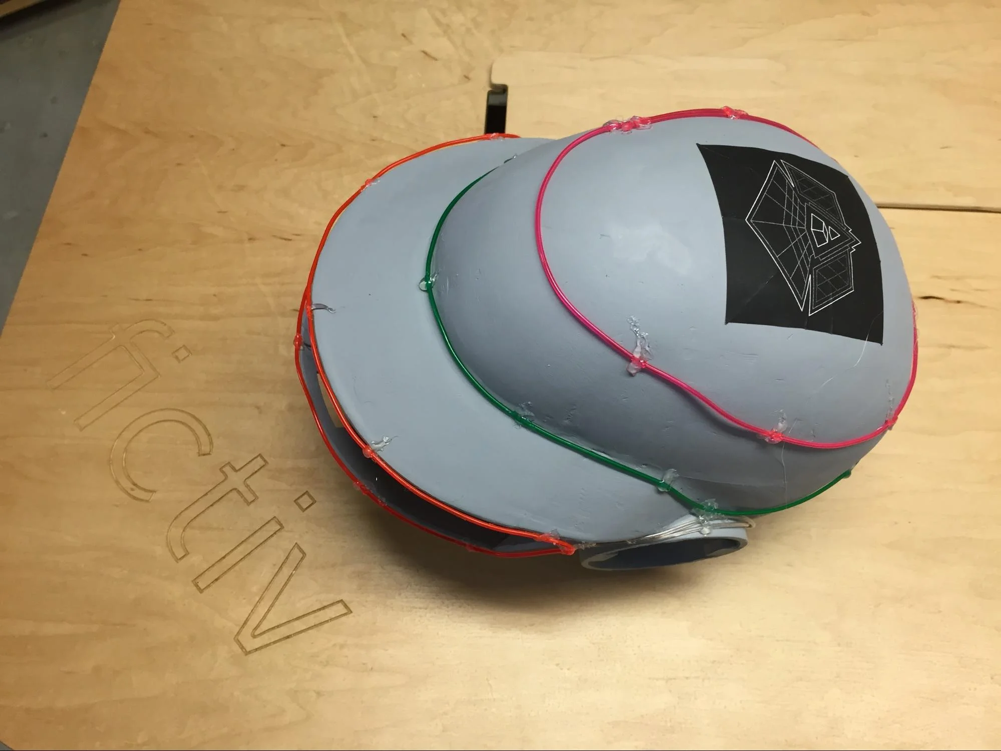

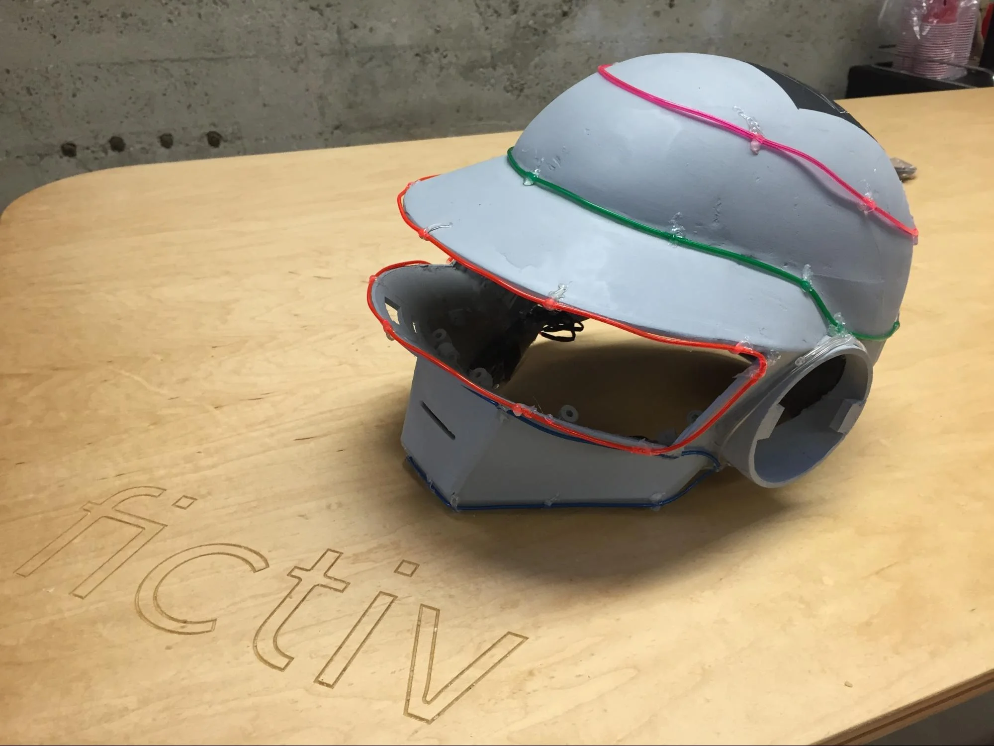

Step 13: Adding EL Wire
Time to glue EL WIRE on the helmet to add some WOW effect at night (while listening to Daft Punk, of course).
This is the EL WIRE I used. I chose this particular one since I wanted short wires (5 ft each), multiple colors, and only one battery case.
I only put a drop of glue every couple of inches here, so not much needed.
![Adding EL WIRE to the Daft Punk helmet](https://www.fictiv.com/wp-content/uploads/2020/08/daft-punk_20.jpg)
Step 14: Add Daft Punk pyramid logo
After Daft Punk’s 2006/2007 tour, the pyramid light scheme became a trademark of that era for the band, so I had to include it.
