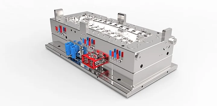

Mold – The tool that’s used to produce injection molded parts. Molds include the core, cavity, material channels, cooling channels, sprues, runners, gates, and ejection mechanisms.
