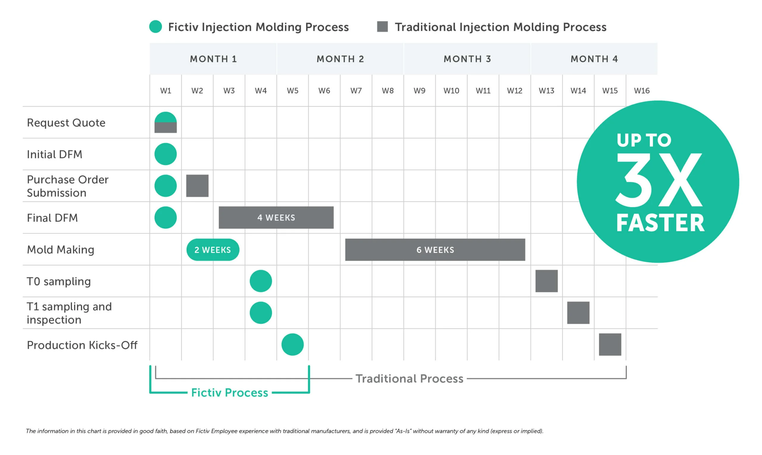

Fictiv’s Digital Manufacturing Ecosystem includes plastic injection molding suppliers who produce all types of volumes, including quantities of complex parts. You can even get injection molded prototypes that use cost-effective tooling made from either aluminum or steel. When considerations such as time-to-market count, we can provide you with T1 samples in as fast as ten days.

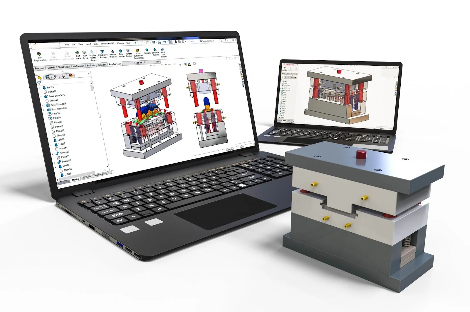

The right plastic injection molding partner doesn’t only produce parts. An ideal partner also offers design for manufacturability (DFM) feedback, rapid prototyping, and material selection guidance to ensure your project’s success. Uploading your CAD file is an important step, but it’s not the final one if you can get DFM feedback. It’s good to find out if potential suppliers provide advice about draft angles, undercuts, and how to simplify part geometry while still meeting specifications.
Mold design is also a critical consideration because non-planar parting lines and the addition of shutoffs and side actions increase tooling costs. Mold flow analysis is valuable, too, because it can uncover design issues and help improve quality and performance. From new product development to new product introduction (NPI), look for a plastic injection molding company that can explain the advantages and disadvantages of your different options, such as pros and cons of various injection molding gates.

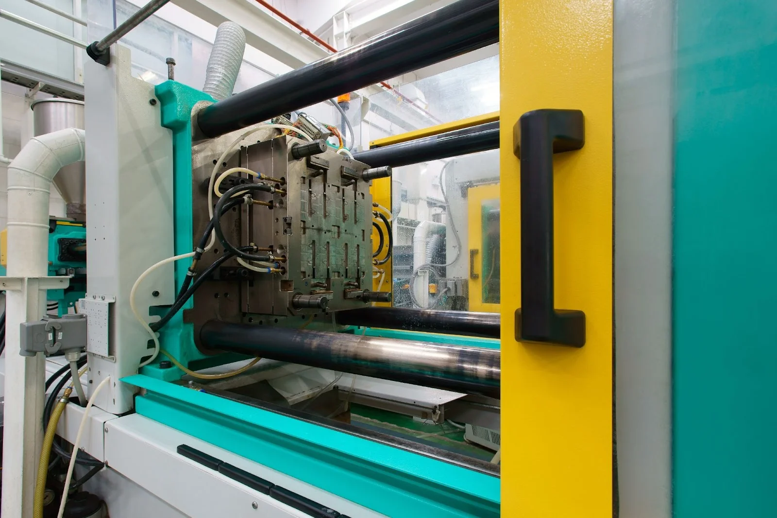

Manufacturing capabilities encompass both tooling and machines. An injection molding manufacturer with in-house tooling capabilities doesn’t have to wait for your mold to arrive from a distant toolmaker. Instead, the molder can machine the tool in-house and with the tolerances and finishes that you need. SPI surface finishes can range from a rough textured finish (D3) to super high glossy (A-1), but finer finishes cost more and may be more than your application requires. The right partner will explain those differences.

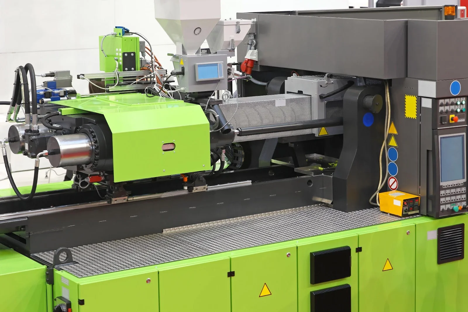

The injection molding machine that a manufacturer uses is also important to know because of its tonnage, aka the amount of force that’s required to keep the tool closed during the injection molding process. If the clamping force is too low, defects such as flashing, short shots, wall thickness variations, and irregular surface finishes can result. Machines with high clamping forces are more expensive, and a less experienced or commodity molder may not have the necessary equipment or technology to deliver what you need.

If there are production issues, on-time deliveries can suffer. That’s why the guidelines for selecting a plastic injection molder span more than just design and development. Fictiv provides designers with a faster and easier way to get quotes with free DFM feedback that uses 3D visualization technology to accelerated design cycles and get to production faster. We have no MOQs, and you can manufacture domestically or internationally.
