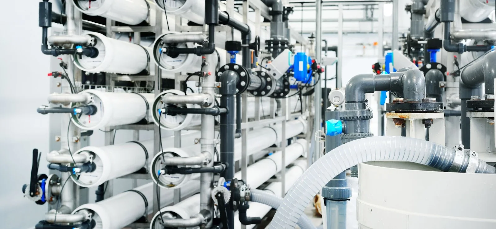

Now that you know how unsuited your tap water is to your process and rinse tanks, it’s time to clean it up! Don’t panic — you have options. Let’s review them, starting from the most effective to the least effective:
  1. Lab-grade purified water uses a combination of purification techniques (carbon filters, ion-exchange resin beds, microfiltration, UV lights, and various filtration membranes) to produce ultrapure, type I lab-grade water. This is the purest form of water, free of all contaminants (or at least down to the parts per trillion level). While highly useful, lab-grade water is expensive and often not needed for your cleaning, rinse, or processing baths. This is type I water per ASTM D1193-91.
  2. Deionized (DI) water is produced by an ion-exchange purification process where contaminants are captured within resin in resin beds. DI water has a low resistivity and a slightly higher percentage of contaminants versus lab-grade water. DI is classified as type II water per ASTM D1193-91.
  3. Reverse osmosis (RO) water isproduced with reverse osmosis systems and is often a water source for DI systems and lab grade water. RO water may be type III or type IV water per ASTM D1193-91, depending on the concentration of contaminants.
So, you don’t need to use lab-grade water for every single bath makeup, replenish or rinse tank, but you should consider using RO or DI water for those purposes. Even if you use the best cleaning solution, poor water quality can undo all the hard work done to clean your parts.

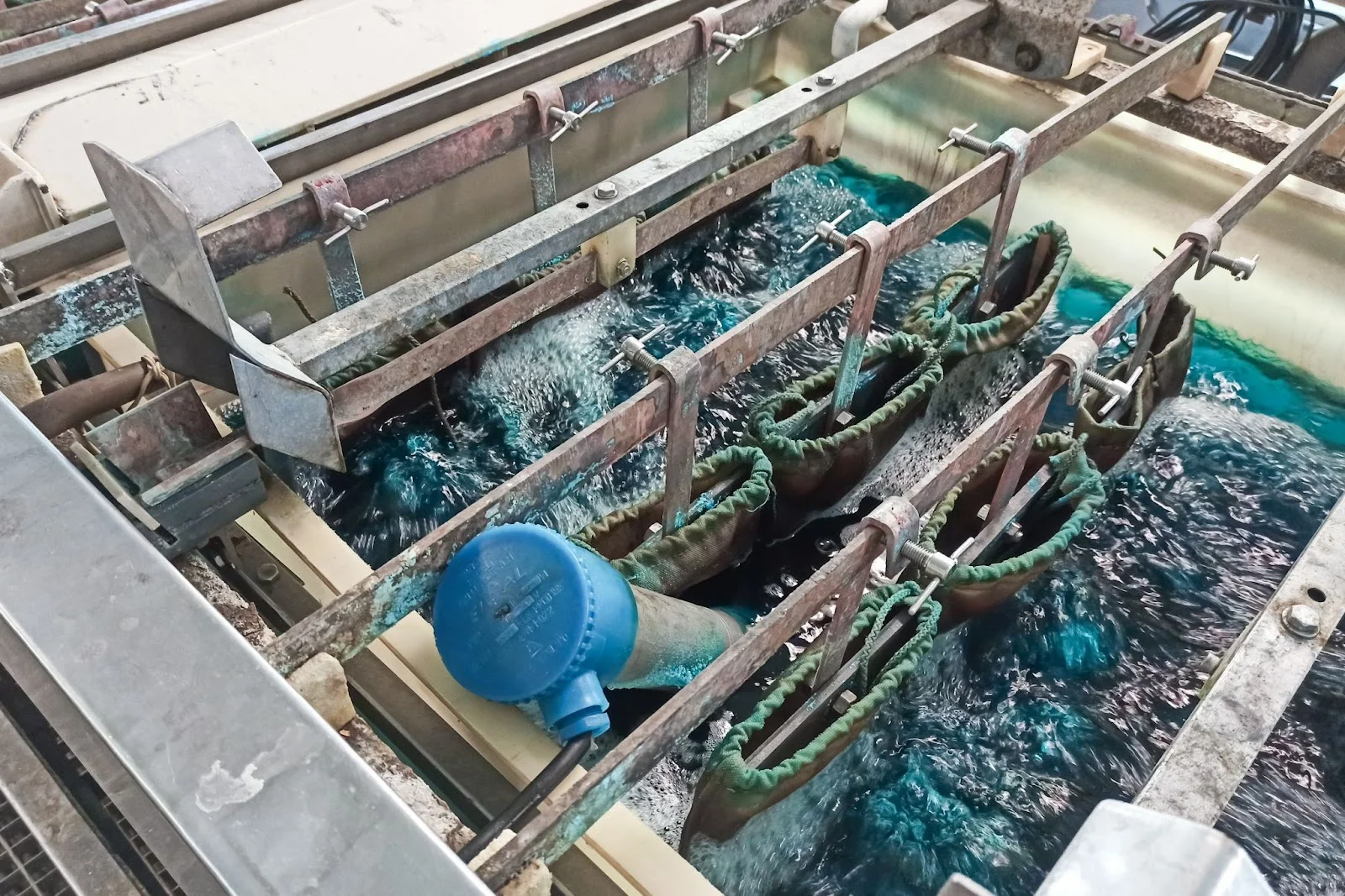

aqueous cleaners are often used prior to electroplating CNC machined parts
Aqueous Cleaners

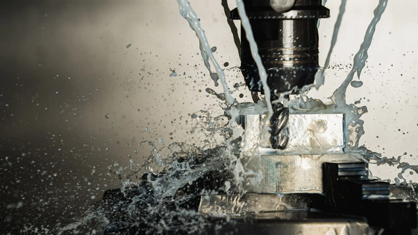

substances like cutting fluids
Solvent-Based Cleaners
Solvent-based cleaners are not diluted with water and ar typically utilized in special cleaning equipment, like vapor degreasers. Usually, machined metal parts are immersed in a single solution — which is often ultrasonically agitated —  and the solution drips off the parts (along with the contaminants). Next, the parts are vapor rinsed and dried, because the solvent doesn’t leave any residue behind. Solvent-based cleaning is also well-suited to rapidly clean a large volume of parts with complex geometries.
