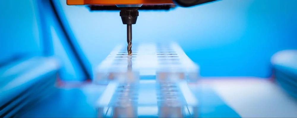

A CNC router cutting an acrylic sheet
CNC routers are versatile, subtractive machines primarily used for cutting, shaping, and engraving wood, metals, plastic, and composites. They utilize a rotating cutting tool (usually a router bit) to remove material from the stationary workpiece. CNC mills, also known as CNC machining centers, are designed for precise cutting, tight tolerances, complex geometries, drilling, and shaping of solid, harder materials like metal, plastic, and composites. They employ rotating cutting tools, such as end mills or drills, to remove material from the workpiece.

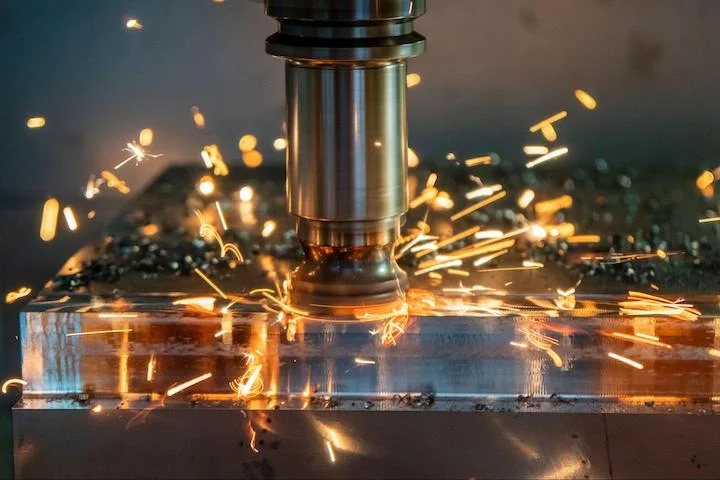

CNC mills operate similarly to their manual counterparts, utilizing rotary cutting tools to remove material. However, the movement of the cutting tool is controlled by CNC instructions, enabling high precision and repeatability. The cutting tools are rigidly attached to the machine, ensuring a CNC mill can cut even hard materials.

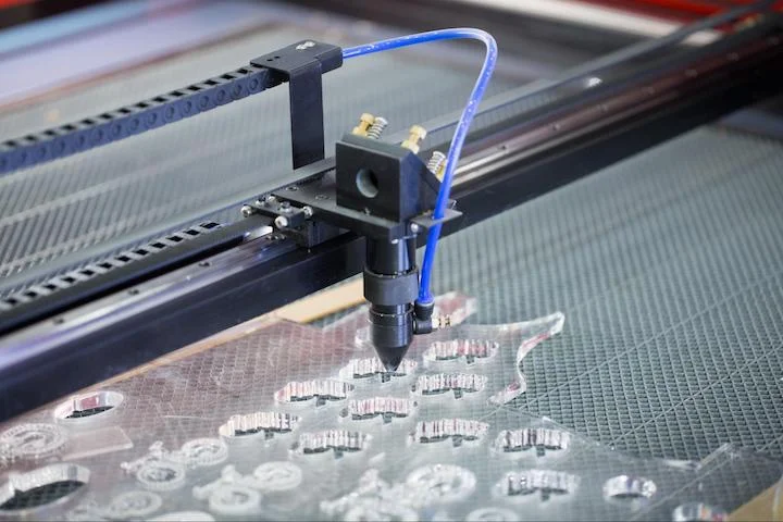

A CNC router cutting plexiglass
Here are some tips for using a CNC router for aluminum:
  • Use a speeds and feeds calculator
  • Use CNC router bits (carbide end mills)
  • Use smaller diameter cutters
  • Clear chips dilligently
  • Watch cut depths and slotting
  • Lubricate with a mist
  • Don’t slow the feed rate too much
  • Increase cut width and use fewer flutes
  • Use a horsepower limit to derate for rigidity
CNC mills are commonly used in the aerospace, automotive, and medical manufacturing industries. They are ideal for machining complex parts, creating prototypes, and producing high-precision components with tight tolerances. They offer excellent accuracy and repeatability, allowing for the production of intricate and precise components.

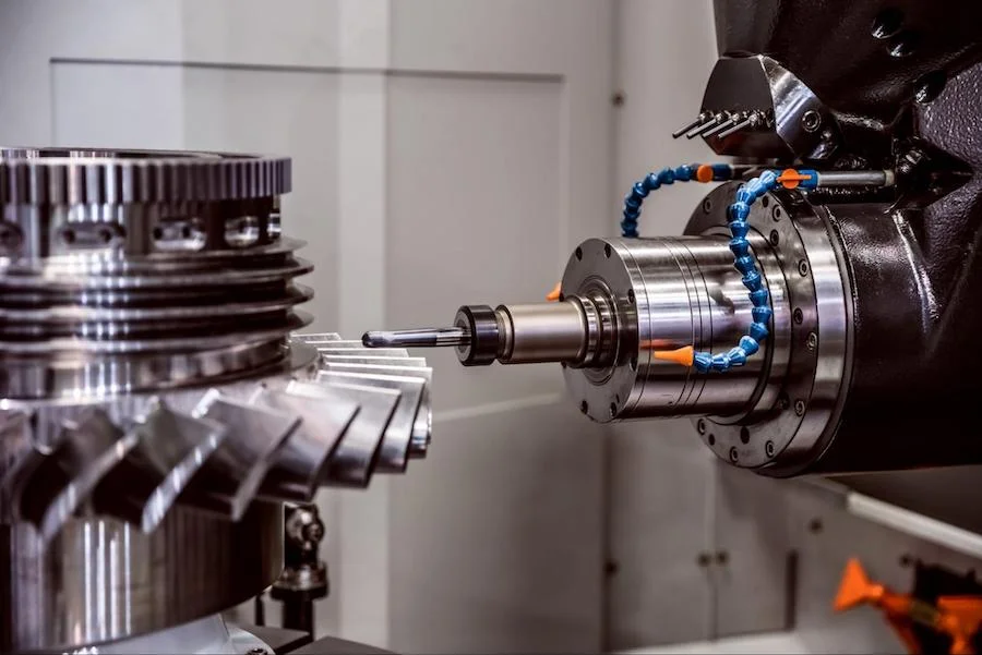

On the other hand, CNC mills can cut through harder materials due to the rigidity of the machine head and tooling. CNC mills are compatible with stainless steel, titanium, aluminum, composites, and softer materials like aluminum or plastic.

A CNC milling machine cutting complex geometries
