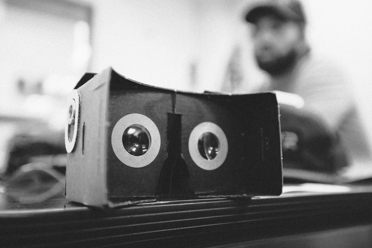

Why did you choose cardboard for your primary material?
The material is structural, relatively easy to manipulate, and cost-efficient. Eventually the market will get to the point where there will be higher-end Virtual Reality devices that consumers want to buy for their smartphone. In fact, there are some products out there now that are injection molded in the $70-$200 price range. But there’s not enough demand right now because people don’t know they want it yet, so the price point needs to be low enough to encourage people to access and experiment with the new technology.
That’s what the DIY kit is for – to encourage experimentation and exploration amongst a wide network of curious and bright makers.
![](https://www.fictiv.com/wp-content/uploads/2020/08/diyvr_15.jpg)
What is it like as a material to work with?
The interesting thing about cardboard is the more you print on it, the more it alters its structural integrity. There’s flexo printing, which is basically a rubber stamp, so when you flexo print, and you do it on a large surface area, you’re compressing it each time. When you die cut it you’re compressing it again and weakening the cardboard somewhat. To offset the flexo printing process there’s lithographic printing. It prints a sheet of paper to make up the top layer, which is then laminated and adhered to the corrugated cardboard, which is then die cut.
There’s other considerations like crush rating and e-flute thickness and when you’re making something like our Virtual Reality kit that has to fold together so precisely, so many times, it’s a tricky process. We’ve made some mistakes and figured out how to do it better and better each time we do it.

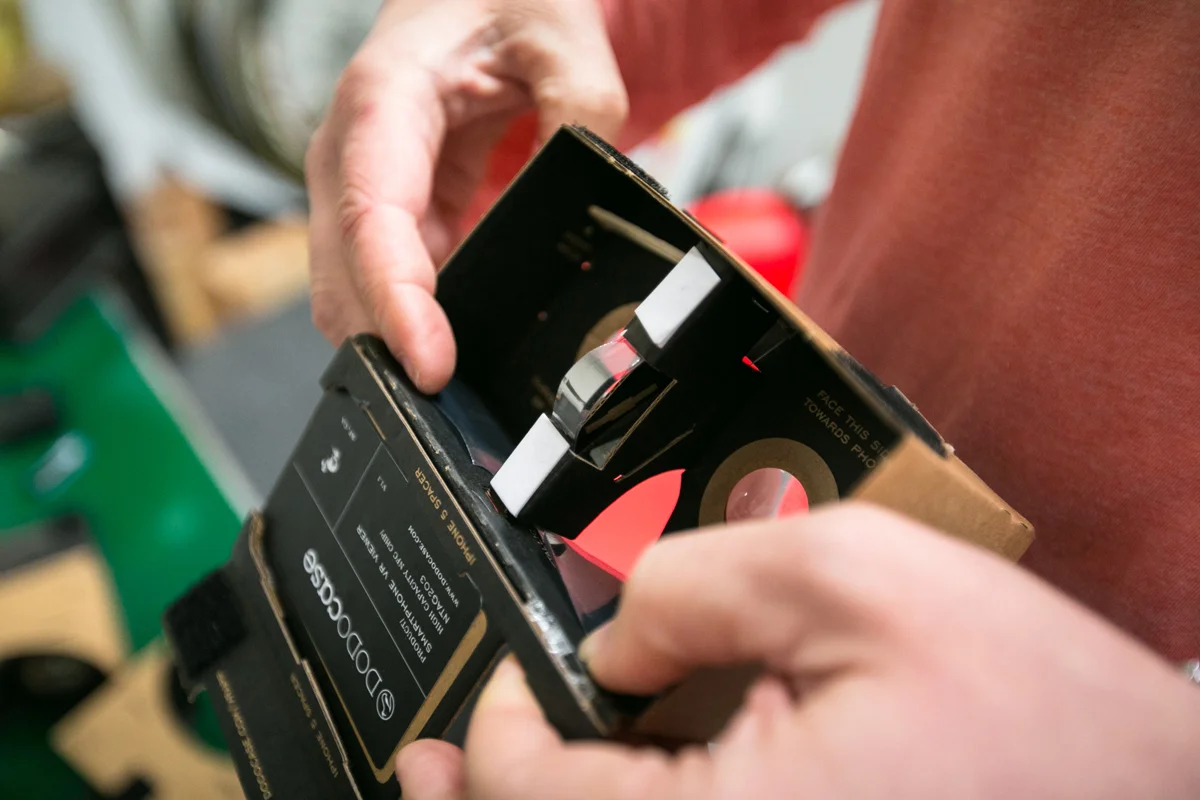

How does your capacitive touch switch work and why is it an improvement over Google’s magnetic switch?
The conductive button mechanism works when you pull up on the PET conductive strip. So when that strip touches the phone screen it creates a touch event. In order to create that touch event you really need a large surface area because the capacitive mechanism is all based upon charge on the surface of the material. After a lot of trial and error we figured out you can’t just tape a little piece of this conductive material on the cardboard because it’s not enough surface area.
Google’s magnetic switch works really well, but it works with the phone’s compass sensor and only 4 phones have the compass sensor in the right spot for it to be compatible. Our mechanism is an alternative that works just as well but on virtually any smartphone.

Were there other solutions you tried before arriving at the capacitive touch switch?
Oh yes, we tried all different kinds of solutions before eventually discovering the capacitive touch mechanism. It’s been the hardest technical problem we’ve faced because smartphone screens are complicated sensors and they’re designed to really only detect finger touches.
We looked at all kinds of ways other people have found to trigger a touch event and discovered that in South Korea they actually use the equivalent of a slim jim sausage. When it gets cold in the winter they buy these beef jerky type processed beef sticks and use those as styluses. In a more promising discovery, we found that the anti-static materials hard drives are delivered in can generate touch events in the right circumstances. So that got us on the right path and we began to try electric discharge foams discharge phones then straight-up metals, like copper sheet, which still didn’t work well enough.
There’s a complex balance in the equation for capacitance with the relationship between distance, area, and dielectric charge, which is a property of the materials. It gets even more complicated than that because smartphone screens are constantly re-calibrating themselves, trying to reject things that aren’t fingers. So the problem we were faced with was to come up with the combination of the right material, the right form, the right distance between the conductive material and the screen, and a simple, low-cost mechanism people can put together themselves.
