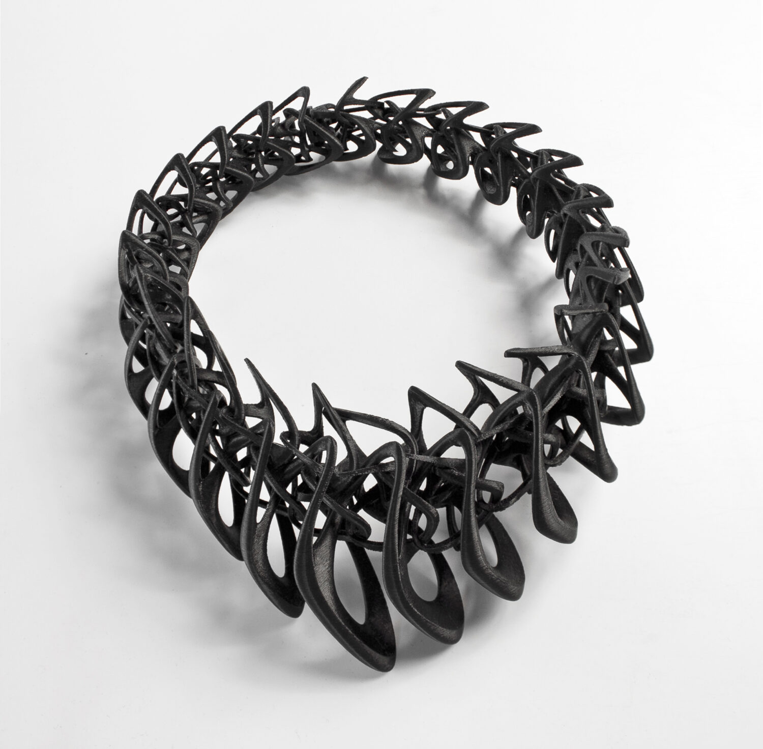

3d-jewelry_01
Artemis Fashion pendant
1. 3D printing to assess form + function
3D printing can be used in the first phases of jewelry design to iterate on the overall form of the piece. We recommend designers start out with cheaper, lower-resolution plastics like PLA to begin with and as you finalize your designs, move toward higher-resolution materials such as VeroWhite to assess finer details of the design.
2. 3D printing pattern molds
Once you’ve finalized the form of the design, you can you use 3D printing to create a plastic mold for casting precious metals.
The pattern can be printed in any plastic material that can be ‘burnt out’ of the mold leaving no residue and with a very good surface finish; generally we recommend using jeweler’s wax.
