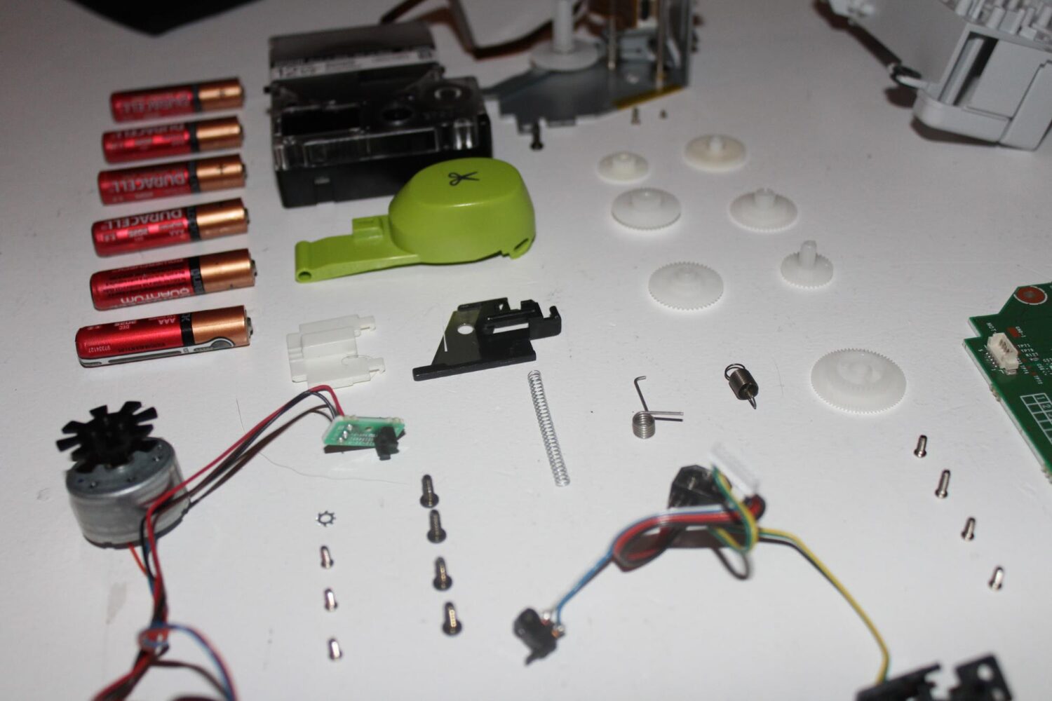

label maker opened up
Sub-Assembly Designs
Upon opening the label maker, we identify two main sub-assemblies:  the ink-cassette housing and the blade assembly.
  • The ink-cassette housing’s main components are the driver gear, the ribbon cable, and the metal bracket. This housing screws into the center of the label maker to provide rigidity.
  • The multi-pin ribbon cable affixed to the bracket reads the corresponding IC on the cartridge so the LW-300 can identify the color, material, and other properties of the label itself.  This part was likely made out of aluminum, due to the precision nature of cassette style printers.
multi-ribbon cable affixed to bracket
  • The main metal bracket was sheet metal stamped, drilled, and then bent with a secondary bending press. A telling sign of bending due to a press is the slight curve on each of the bends due to the die used.
  • Since the paper spool is printed at a constant rate, the metal bracket must stabilize the ink cassette so as not to induce errors on printing, hence the choice of a rigid metal over a pliable plastic. Additionally, the plastic component the housing snaps into has rubber bushings to isolate any vibrations during operation.
plastic housing
  • The entire cutting operation was, perhaps unsurprisingly, a simple manual spring-actuated blade. The assembly consists of the button itself, a return spring, and the blade. It’s a straightforward, but reliable design that isn’t dependent on any electromechanical components.
